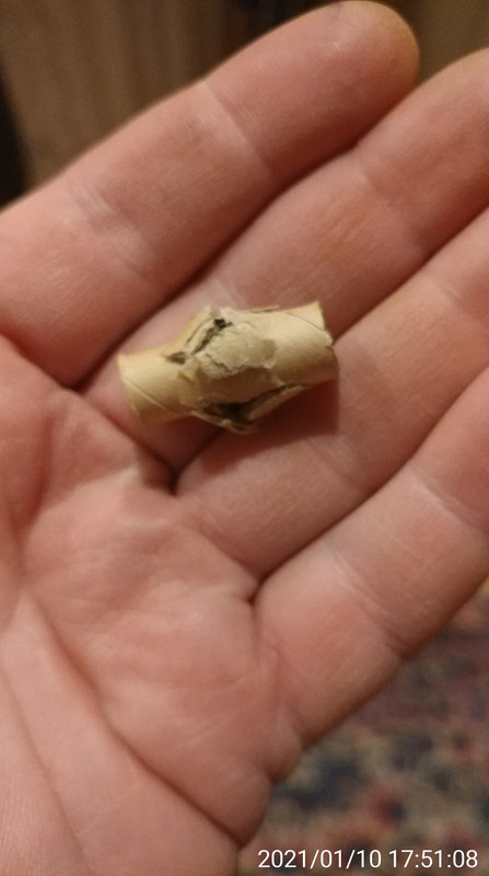

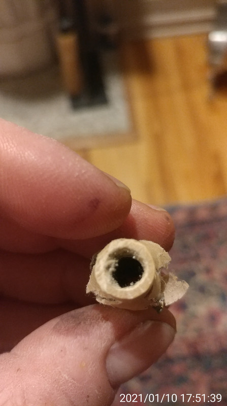

FWIW here's the effect of 300mg of the final product detonated inside a small cardboard tube using a PbN3 primary, with fairly light compression.
All your acids are belong to us.
