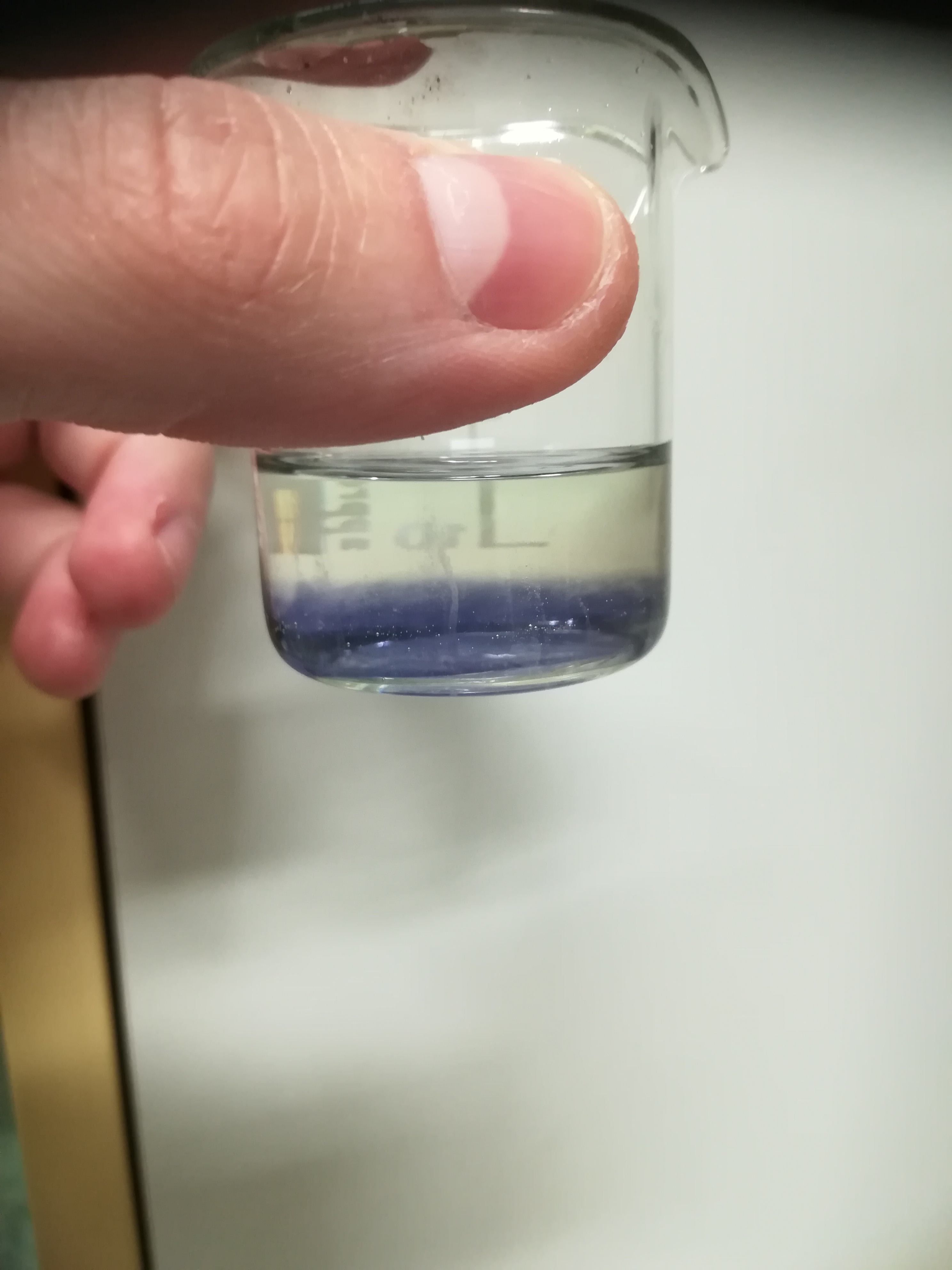

So far, I have made the compound in three different ways, and I tend to explore at a later time what the optimal conditions for this are.
The first method I did was this:
Some 95-97% sulfuric acid was taken and some small amount of NaNO2 was added to it. This was shaken, but not everything dissolves. Then some 85% formic acid is dripped into it. THIS PRODUCES CARBON MONOXIDE! The liquid foams a bit from the evolved CO. At this point I was already expecting a purple color, but nothing happend. So I put everything into a hot water bath for a bit to get rid of at least some CO. I also read that copper is a catalyst for this, so I added a blank piece of copper wire. And within a few seconds, vibrantly purple streaks started to form. After shaking the entire solution was dark purple.
N2O2HSO4.png - 5.1MB
IMG_20200209_143152.jpg - 2.1MB
I left the solution standing like this for three or four days, and the color slowly faded and finally was colorless again.
In retrospect, the formic acid probably didn't do much apart from diluting the sulfuric acid, but I read it should have been able to reduce the NOHSO4 by itself. It seems it doesn't. I assume the formic acid can be left out, but I haven't tried that yet.
Someone might say this is a copper complex, but there is good reason to believe that this is not true (although atomistry mentions something of a copper salt(?) of this which has an even stronger color, I guess it could be it?), because the same color appears with zinc:
To some 95-97% sulfuric acid some NaNO2 is added, shaken until mostly dissolved, then some pure zinc powder is added. This takes a much longer time than before. Eventually however, the solution turns purple.
IMG_20201012_112141.jpg - 2.2MB
I added more zinc and the solution eventually had a quite dark color, compareable to the one in the first experiment.
Yet another experiment can be performed, and this time I made sure to record masses:
Everything was around 0 °C cold. I added 1.88 g (about 1 mL) of the 95-97% H2SO4 to a test tube, then I added 70 mg of NaNO2 to it, stirred it around with a glass rod and left it there for ten minutes, didn't all dissolve, very slow gas evolution. Then I added 40 mg of Na2S2O5 to it and stirred again, not much gas evolution, and no full dissolution either, left again for about 10 minutes. Then I put it into a 30 °C water bath where some gas evolved, but not much, the solution started clearing up and after ten minutes of standing outside the water bath it was mostly clear. Then I started adding distilled water dropwise to the test tube so it ran down the sides. On hitting the acid some gas evolved, and the acid started turning purple. I think I added about 5-6 drops, and shook it a bit, then left to stand for a few minutes for the bubbles that formed to rise.
IMG_7089_cc.jpg - 1.9MB
The layering occurs because mixing in the test tube is fairly bad and the water only entered the top portion so far. The color continues to darken. Too much water will likely (according to what I read) destroy the compound again. Indeed: When the solution was diluted with an equal volume of water, all purple color faded away and some brown gas was evolved and it smelled of NO2.
I'm fairly confident in saying I have successfully produced a solution of N2O2HSO4 in sulfuric acid.

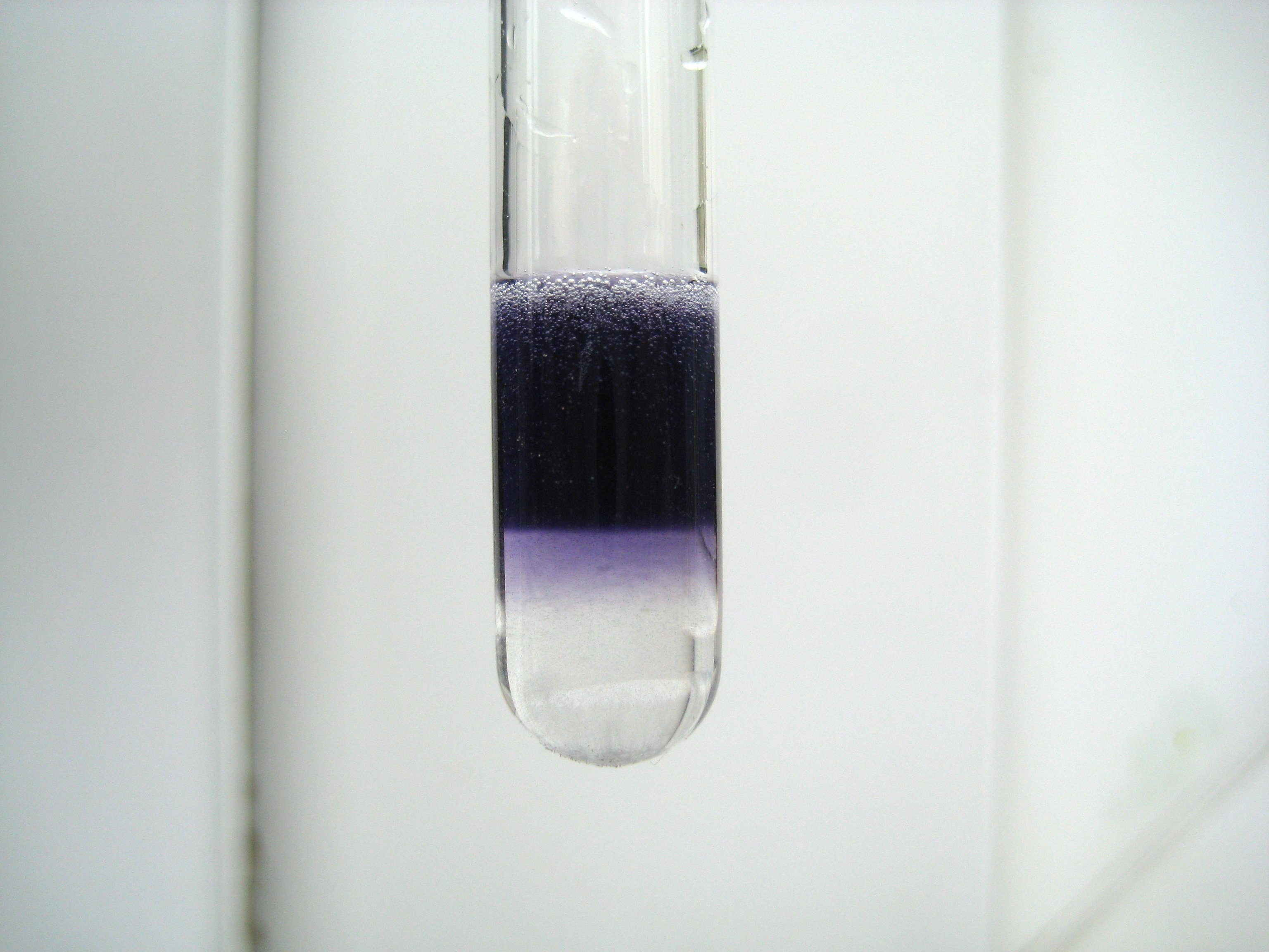

I did some experimenting, and I succeeded in making some of the purple acid! It's a somewhat elusive compound, making it requires some trial and error. The concentration of water, needed in the acid must be within fairly tight bounds. Too little or too much water, and it does not work.
For a start, you can do the following:
Take a SMALL pinch of NaNO2. A piece of 2x2x2 mm is enough. Too much nitrite and it does not work!
Do the NaNO2 in a dry test tube.
Add appr. 2 ml of conc. H2SO4.
Swirl around, until the NaNO2 has dissolved. If the acid is really concentrated, then there hardly will be any production of gas and no brown color can be observed above the liquid.
Add a similar amount (at most 10 mm3 of solid) of solid K2S2O5 to the liquid. Na2S2O5 also can be used.
Swirl till the solid has dissolved. Some of it will be sticking on the glass. That's not a problem.
Carefully, while keeping the test tube tilted, let a single big drop of water run along the glass, through some K2S2O5, sticking to the glass until it hits the acid.
If this is done carefully, then 2 or 3 mm of water will be floating on top of the acid, with a clearly visible purple layer between the colorless acid and the colorless aqueous layer.
Carefully swirl the test tube so that the water mixes with more acid. If you do this, then you clearly see a purple color, and production of some colorless gas. The liquid becomes warm, but not overly hot. This is good. If it remains cold, then the reaction does not occur (or is very slow).
If you want the purple color to last somewhat longer, then you should cool the test tube under some running tap water.
Carefully swirling more can make all liquid purple, but it might be that the color fades again and that an additional small drop of water must be added.

I have also tried this now and can confirm that this color has nothing to do with the presence of copper or any other transition metal contamination. I loosely followed the metabisulfite method described in the OP.
In about 10 ml of 96% H2SO4 i dissolved 0.5 g of NaNO2 (heating the mixture slightly speeds this up). Then I added 0.3 g of K2S2O5, again waiting for it to dissolve (very little SO2 formed in the process). I then waited it to cool down a bit. Once it did, I started adding water dropwise with constant stirring until an intense color developed.
Here was my result:
purple_acid1.jpg - 113kB
purple_acid2.jpg - 144kB
It surprises me how the color was a very intense purple-indigo. Again, not a result of metal contamination, as I used high purity reagents.

The acid can be obtained in quite high concentrations, such that even 2 cm of liquid is nearly black. I made some pictures of the compound and will write a webpage about this. The pictures I can share here already:
purple_acid.jpg - 254kB purple_acid_dark.jpg - 231kB purple_acid_dark_backlight.jpg - 280kB
For these experiments I used fairly high concentrations of NaNO2, but also quite high concentrations of K2S2O5. You can see solid material sticking to the glass, not all of the solid material could be dissolved. The left picture shows high concentration, with only a little amount of water added. The middle picture shows high concentration, with a little more water added. The right picture shows the same test tube, with bright LED-light from behind, showing the color somewhat better than the middle picture.
I really is remarkable to see formation of this compound from only NaNO2, K2S2O5 and H2SO4.
When the dark material is diluted with water, then a nice blue liquid is obtained, like a dilute solution of CuSO4, but slightly more cyan. This most likely is N2O3, dissolved in water. More on that follows in the webpage.

So I tried this reaction again. I folowed EthidiumBromide instructions, instead of K2S2O5 I used anhydrous Na2SO3. And I obtained this beautiful solution. I tried to add some copper nitrate which I made from piece of copper wire and nitric acid (I didn't have copper sulfate on hand), but this caused decolorization of solution due to presence of nitrate (see the third picture).
I tried to add copper wire in to purple solution. Some purple colour appeared around copper but after a while I didn't saw further formation of this colour.
I tried to use copper as a reductor instead of sulfite. At the surface of wire a saw some purple colour, but solution remained yellowish. When I added drop of water, purple colour disappeared. It seems that formation of small amount of NO2 caused oxidation of this acid. This compound is really sensitive to any oxidizing agent.
IMG_20210110_002215.jpg - 1.5MB IMG_20210110_002253.jpg - 1.3MB IMG_20210110_002451.jpg - 1.4MB
