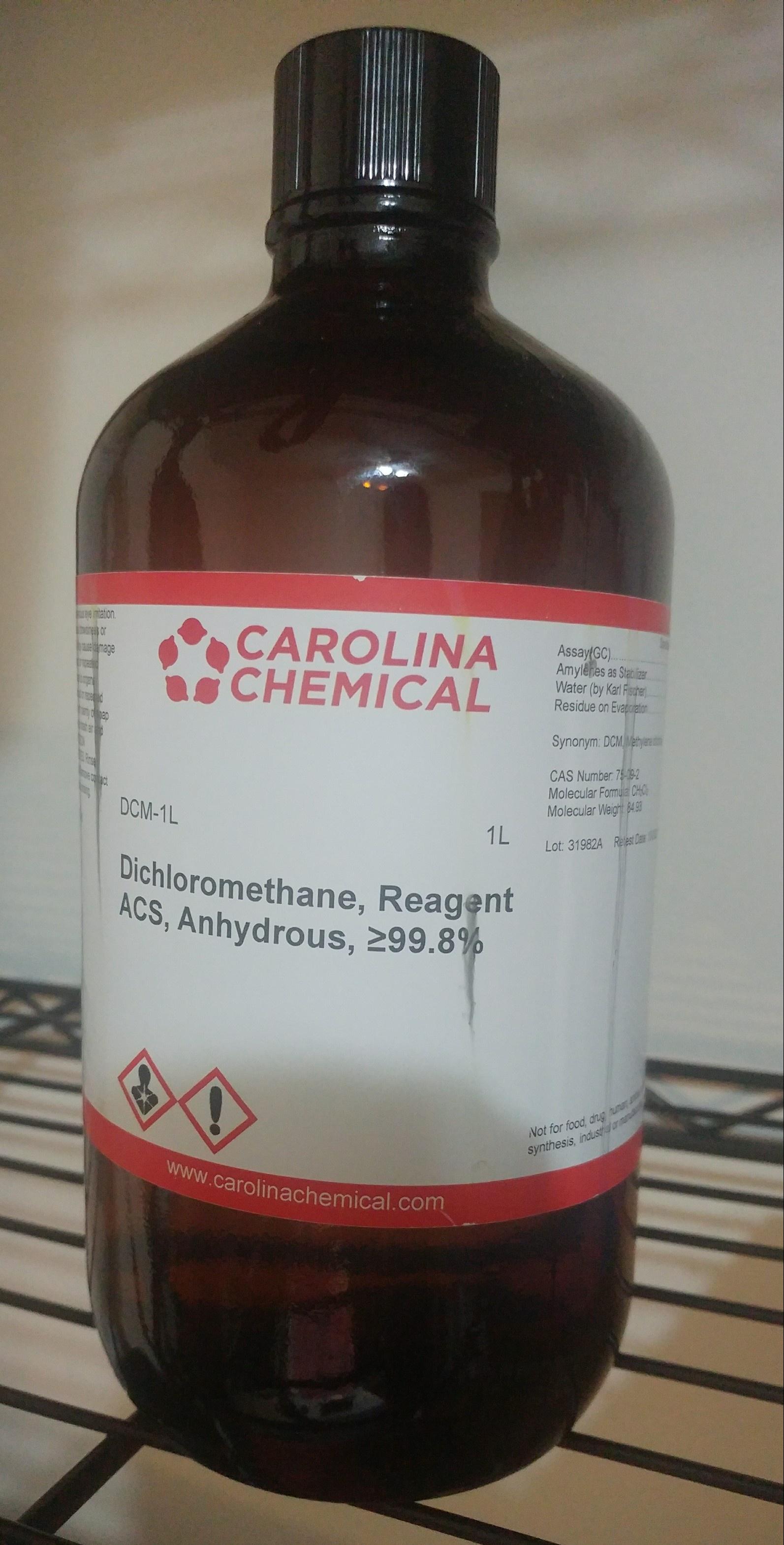

[*] posted on 3-2-2021 at 13:10
Damn this blasted thread. :mad:
Since DCM is rather expensive (I paid $41.51 for 1L), and chlorinated solvents are my favorite, I consider my DCM to be rather precious (I recycle/distill/dry every bit I can after use). I read this thread last night right before crashing, then I was thinking "holy shit... I haven't used it in like over a year... what if it's all evaporated and escaped the bottle..." all damn night.
DCM-1.jpg - 350kB
DCM-4.jpg - 236kB
Whew... It's all there! :D I'll probably weigh or mark the bottle now that yall have got me paranoid about the damn thing, lol.
