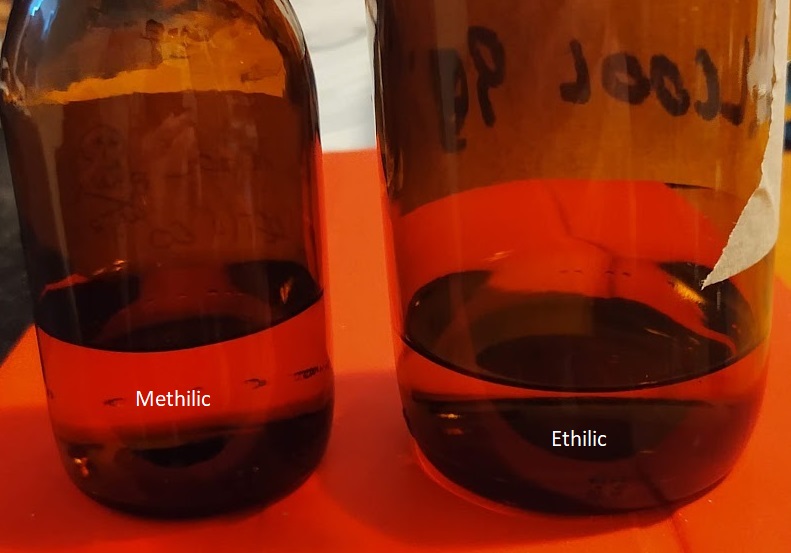

This is what I got from distillation:
- About 250cc of methyl alcohol
- About 500cc of ethyl alcohol
- A residue starting to boil at 82 ° C, which I don't know what that could be. Some idea?
IMG_20210508_145500784.jpg - 54kB
(98% for ethyl is presumed, because the alcohol meter gave a value of 100%, but it seems unlikely to me :o)
[Edited on 8-5-2021 by Blunotte]

It is likely that your ethanol contains some methanol, and vice versa. A simple distillation won’t effectively separate substances with such a small difference in boiling points. Depending on the source, you’ll see anywhere from 25 to 100° C as the minimum difference in boiling points for fractional distillation to be effective. I think it’s usually closer to the lower end of that, but even so, a difference of only about 13° C isn’t going to give you very good separation, especially not without really accurate temperature control. I would recommend trying a fractional distillation.
Blunotte
Posts: 49
Registered: 2-4-2015
[*] posted on 8-5-2021 at 09:52
You're right, I think... :(
