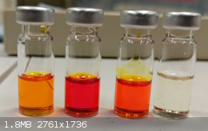

IMG_20220928_215445.jpg - 1.8MB
From left to right nitrobenzene + aniline, N-ethylaniline, N, N-diethylaniline, cyclohexylamine

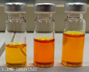

IMG_20220928_215527.jpg - 1.1MB
From left to right o-nitrotoluene + aniline, N-ethylaniline, N, N-diethylaniline

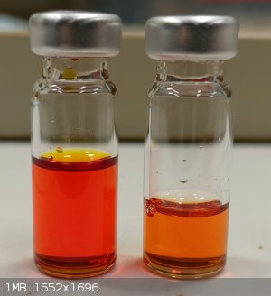

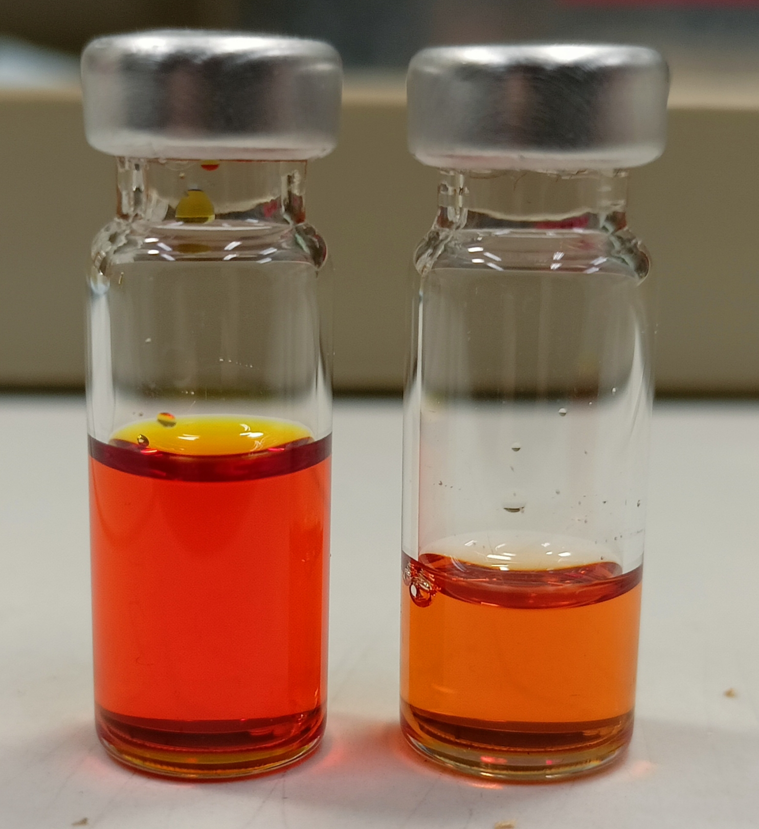

IMG_20220928_215553.jpg - 1MB
Nitrobenzene + o-toluidine, on the right o-toluidine (brown colour probably from aerial oxidation).
