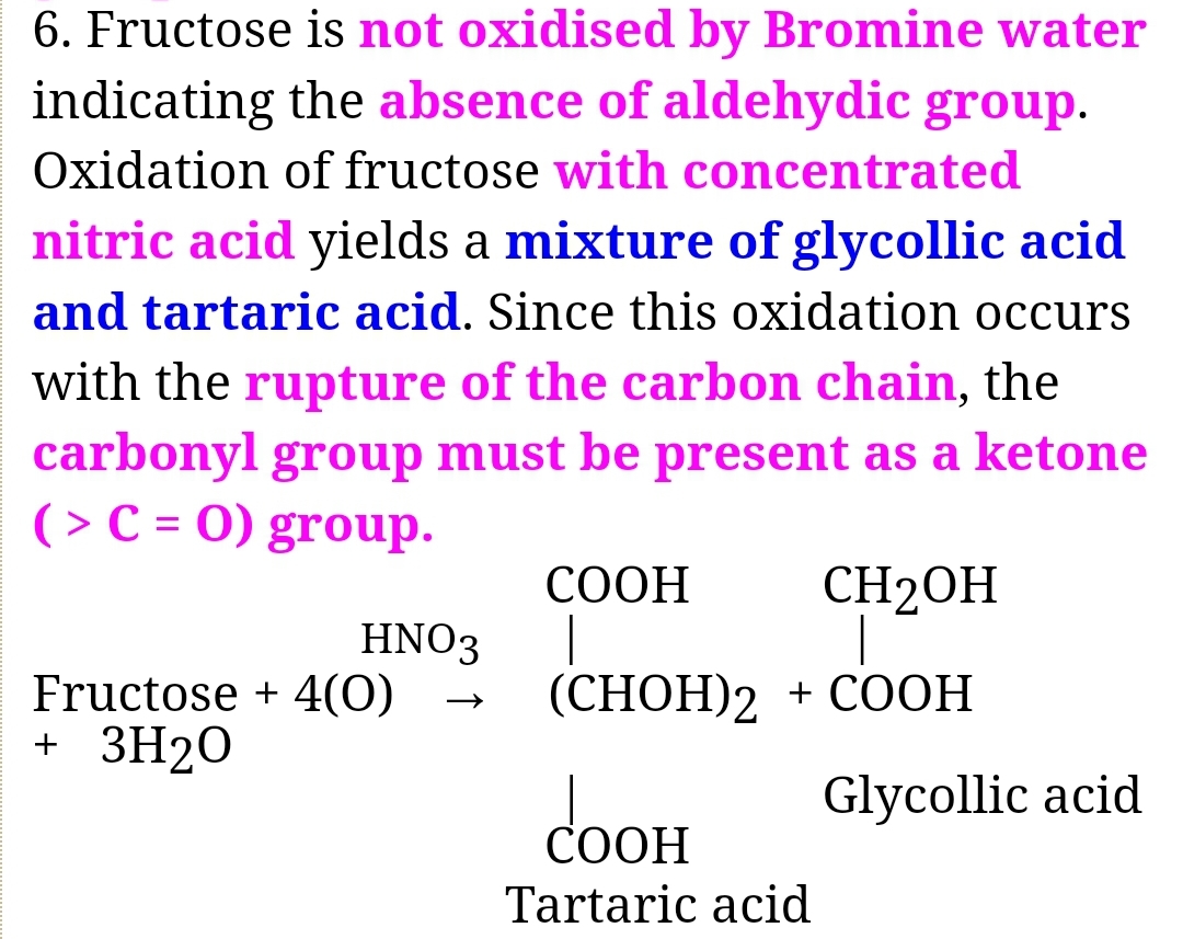

What else could it be with those ingredients? COPE has a short paragraph on fructosan trinitrate "produced by the action of mixed acid at 0-15° on d-fructose".
I would guess it could be oxidized into glycolic acid, tartaric acid, and probably a varing mix of nitrate esters. Fructose is a reducing sugar.
[Edited on 7-11-2022 by Loptr]
Screenshot_20221110_175716.jpg - 371kB
