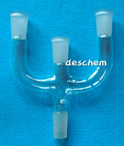

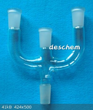

would a modified claisen adapter ( the kind that looks like a 3 neck) stand up to a 3 neck flask, i.e. under vacuum, or is it for some reason limited in this application?
It'd be ideal to consolidate

s-l500.jpg - 41kB

The adapter you show may make a reasonable substitute for a 3 neck flask. But really, get the adapters you need for the projects you are doing. Watch a bunch of chemplayer vids. It is amazing what he accomplished with just a beaker and some vacuum filtration.
