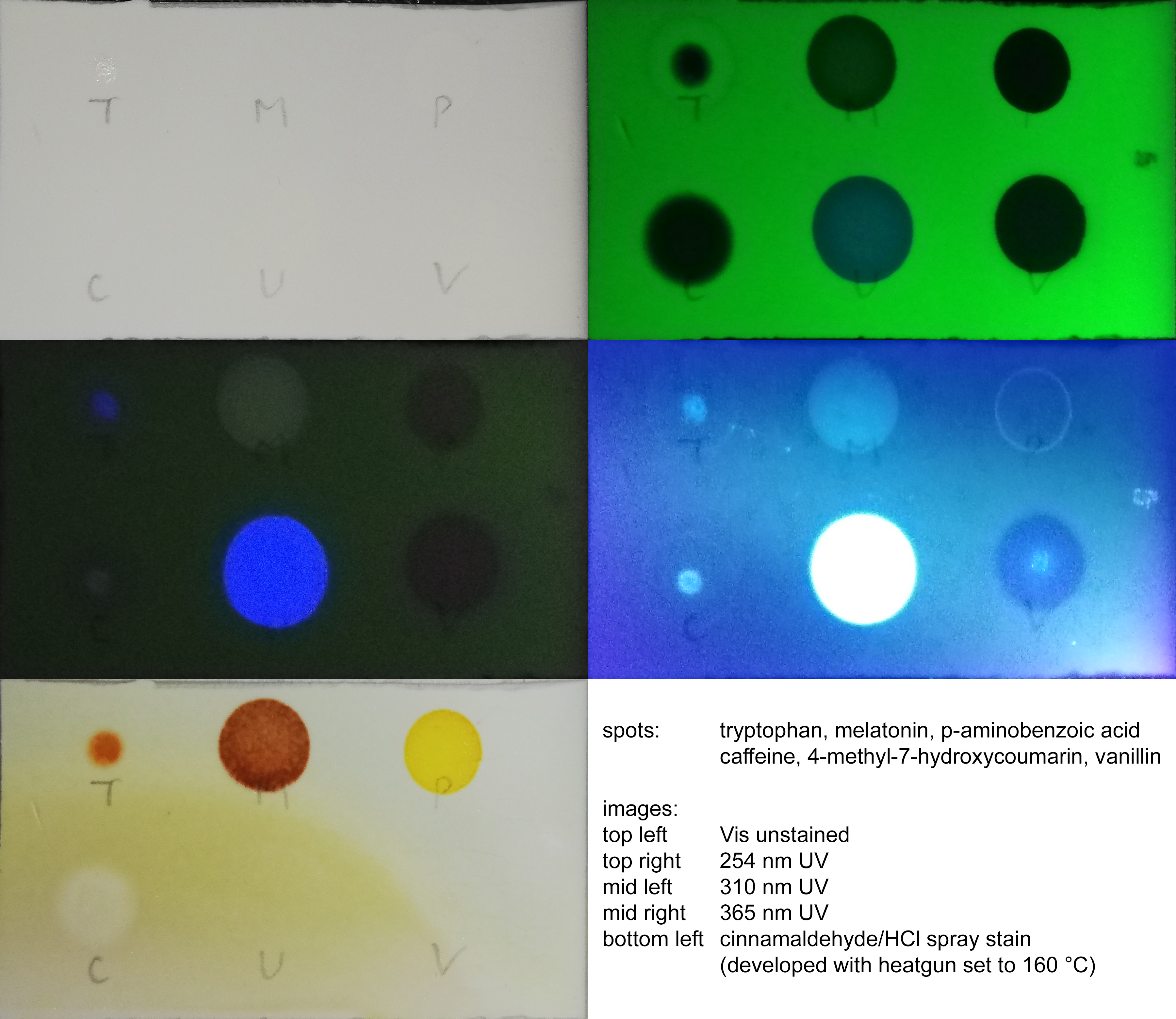

To test the stain, six samples were spotted onto a TLC plate: tryptophan, melatonin, p-aminobenzoic acid, caffeine, 7-hydroxy-4-methylcoumarine and vanillin.
My stain used commercial cinnamon essential oil. The stain was sprayed onto the plate with a glass TLC sprayer. p-Aminobenzoic acid and melatonin quickly changed color. The plate was then dried and gently heated with a heatgun set to 160 °C. Dark orange spots developed for tryptophan and melatonin. p-Aminobenzoic acid turns an orange-yellow.
TLC_cinnamon.jpg - 1.9MB
Note that the spot for tryptophan is rather small, this is due to the low Rf in the spotting solvent, MeOH. (What is causing the fluorescence in that spot is unknown to me, it was sold as a food supplement, and it is not the tryptophan itself either.)
I have also tested this on actual developed TLC plates, but they looked no different to these tests.
So in conclusion it works and this may be a more OTC alternative to Ehrlich's reagent, but always keep in mind that the stain also seems to visualize aryl amines (hardly surprising due to the formation of a schiff base - I would expect Ehrlich's reagent to do the same). It's proabably also less sensitive than Ehrlich's reagent, but I haven't tested it, and the stains still seems sensitive enough.
