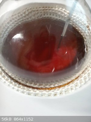

after 90 minutes at 60 C, almost the same color
IMG_20231128_122811_2.jpg - 56kB
