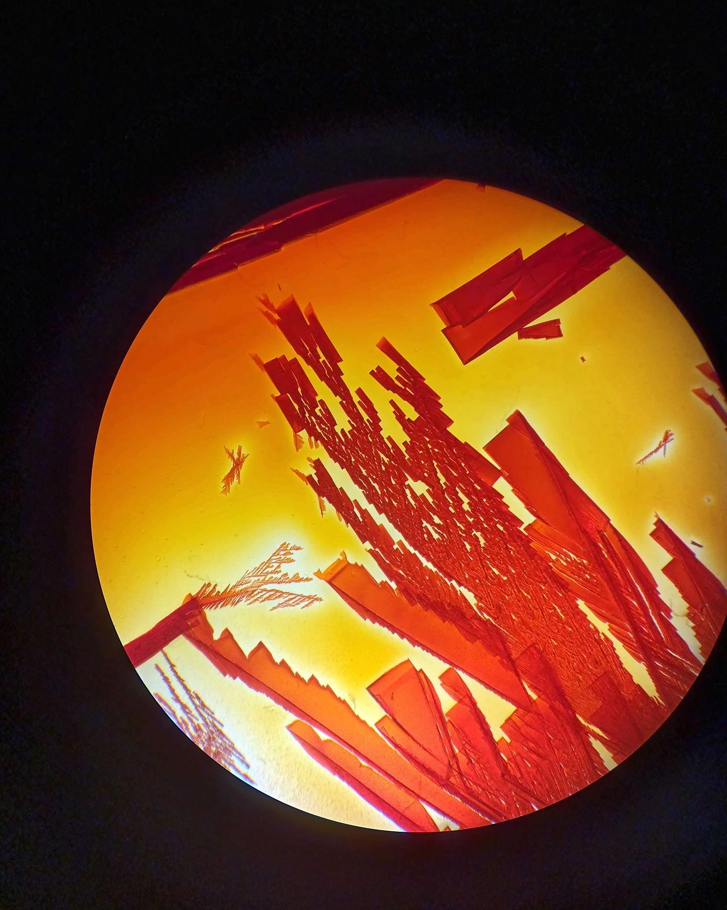

Greetings everyone, hope you all are having a pleasant advent season.
Today it’s time for me to share an inorganic synthesis I did while renovating my laboratory, which is the synthesis of iron(III)-acetylacetonate from iron(III)-chloride. Besides it simply forming some really beautiful crystals it may surprise you to hear that actually it‘s also quite a useful reagent in organic synthesis, since it can be used as a cheap catalyst in alkyl-aryl crosscouplings, replacing precious metals like palladium, which may not be affordable enough to be used in the average home laboratory.
Unsurprisingly a complex this simple isn’t too hard to synthesize, and it actually just takes two easy steps to produce Fe(acac)3 with reasonably high yields.
Required chemicals:
-7,5 g of anhydrous iron(III)-chloride
-15 ml of acetylacetone
-some 20% potassium hydroxide solution
-some acetone
To get things started the FeCl3 was dissolved in approximately 100 ml of destilled water with the help of a magnetic stirrer, resulting in a clear, orangey-brown solution.
Then, to produce the intermediate reactant, 20% potassium hydroxide solution was slowly added to the reaction mix until the pH reached a value of 8. This reaction should yield ferric oxyhydroxide quantitatively, which, because of its really low solubility in water, could simply be filtered off, washed with fresh water multiple times and dried inside a vacuum desiccator.
Moving on with the preparation the semi-dry paste was transferred to another beaker, and to start the actual reaction the acetylacetone was simply added all at once and stirred, so an even suspension was formed. After half an hour the mixture turned a dark red color, indicating that the conversion was finished.
Once again a simple filtration was performed to collect the product as a red powder, for further purification it was recrystallized from acetone twice tho, yielding some gorgeous dark-red crystals of iron(III)-acetylacetonate.
Yield: 5,3 g; 32,4% of the theoretical (lost quite a bit of product in the purification, since I really tried to get some good crystals for the shots under the microscope, quite sure yields of at least 60% can easily be reached too tho)
E622A7DE-ECB7-413A-9E0B-C2CDA0140BAD.jpeg - 338kB AA8EB18D-FE86-4FC2-A1F6-EE4BACC47FC7.jpeg - 372kB 81E4D6C5-A334-490D-B403-42D2BC16C599.jpeg - 575kB 45CAC8DA-DE64-46A4-B92E-575029E79880.jpeg - 377kB

Very nice!! I always have trouble getting the right solvent for recrystallization of these things.
I've found with the copper(II) acac complex, chloroform seems to work best, although methanol does okay. It's weirdly less soluble in larger alcohols....
Good to know, never even thought about using chloroform as a solvent for recrystallizing my Cu(acac)2.
Just tried acetone and methanol before, which worked alright, I just got some really small crystals from it tho..
