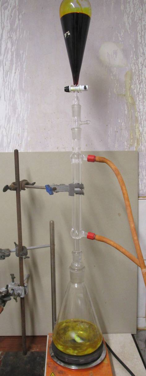

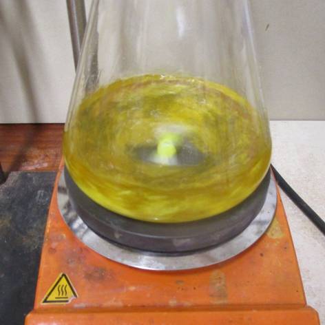

28.835g of 9-bromoanthracene were placed in a 1 l conical flask equipped with a large stir-bar. 200ml of glacial acetic acid were added and the flask warmed and stirred to disperse the bromoanthracene most of which dissolves. The flask was equipped with a reflux condenser at the top of which was placed a side vent and then a dropping funnel.
02 Chromic acid-acetic acid.jpg - 37kB 03 9-bromoanthracene.jpg - 35kB 04 bromoanthracene dissolved in acetic acid.jpg - 39kB
Chromic acid in acetic acid ..................................... 9-bromoanthracene charge ....................................... Solution in acetic acid almost complete
The dropping funnel was charged with a solution of chromic acid prepared by dissolving 40g of chromium trioxide in 30ml of water and when dissolved diluting with 150ml of glacial acetic acid.
05 general set-up.jpg - 65kB
General set-up for chromic acid addition

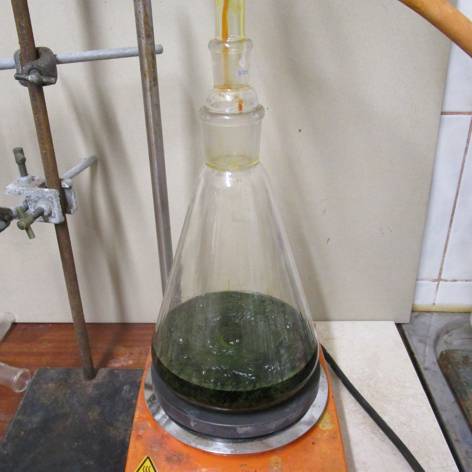

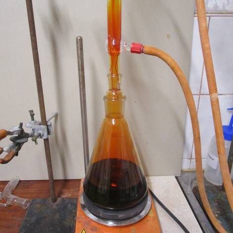

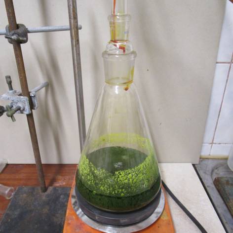

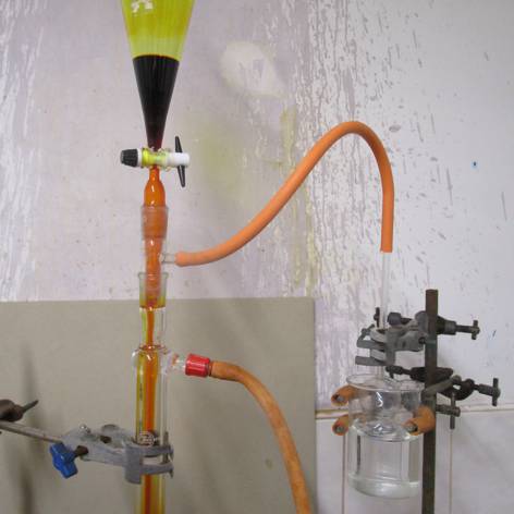

When the contents of the flask had almost reached boiling point and most of the bromoanthracene had dissolved the chromic acid solution was added through the reflux condenser at such a rate that the mixture refluxed gently. It was found necessary to keep the hotplate on at about 120°C in order to keep the reflux going, particularly towards the end of the reaction. Addition took about 50 minutes but could usefully be shortened. Towards the end of the chromic acid addition the flask is filled with bromine vapour and bromine starts to reflux with the acetic acid. It was necessary at this point to add a hose with a gas trap containing dilute sodium hydroxide to the vent at the top of the reflux condenser.
06 chromic acid addition.jpg - 40kB 07 anthaquinone starting to separate.jpg - 40kB
Dark green colour quickly forms on chromic acid addition ....... Anthraquinone starting to precipitate
08 bromine refluxing.jpg - 41kB 09 detail of absorption vent.jpg - 37kB
Bromine vapour starting to reflux with the acetic acid ...... Detail of bromine absorption set-up

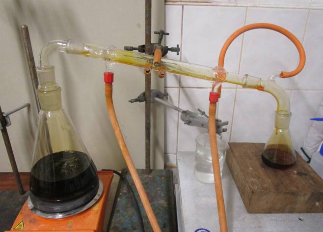

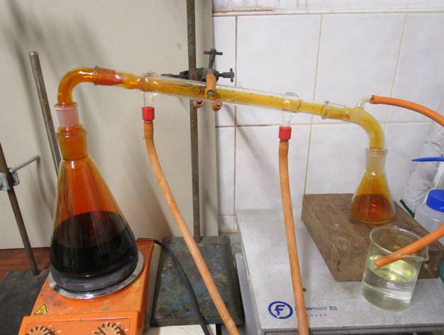

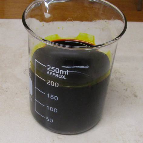

The flask was allowed to cool a little and then the condenser rearranged for distillation into a vented flask with the gas trap attached to the vent. The contents of the flask were then distilled until the vapour in the conical flask was almost colourless, about 35-40ml of acetic acid plus bromine were distilled off. When no significant amount of bromine was passing over the distillation was stopped, the flask allowed to cool a little and then the contents poured into a 2 l beaker. The flask was rinsed with 100ml of water and the washings added with good stirring to the beaker. The dark green slurry was allowed to stand overnight and cool to ambient temperature, about 7-8°C.
10 distillation of the bromine.jpg - 51kB 11 distillation of Br complete.jpg - 49kB
Bromine distillation starting ............................................... Bromine distillation practically complete

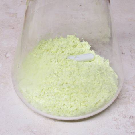

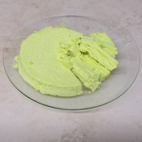

The cold suspension was filtered using a large Buchner funnel (11cm with Whatman 541 acid hardened paper, but a large sintered glass Buchner funnel could be used.) The greenish crystalline cake was washed on the filter and then sluiced back into the beaker, dispersed into 500-600ml of fresh water and filtered again. Water was drawn through the solid until it ran completely clear and then the cake was drained for 10 minutes. The cake was dried for 24 hours at 45-50°C to give 22.186g of pale-yellow crystalline powder, about 95% of theory.
12 vacuum filtration.jpg - 38kB 14 dried filter cake.jpg - 34kB
Vacuum filtration using 11cm Buchner funnel ................... Final washed and dried anthraquinone cake
