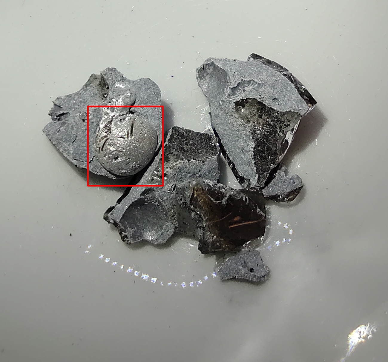

Today I performed my first "ok" thermite to make Aluminium sulfide.
Aluminium is handfiled (from a processor heatsink)
Sulfur is mortar crushed from sulfur cyllinders.
Boths powders are mixed in the mortar.
First try was to make a loose "mountain" with a sparkle inside,
Sulfur melted (and got ignited "blue fire") but no thermite.
Second try was to put the mixture (aprox 1gr Al + 1,5gr S) in a 8ml testube - was compacted and added a sparkled with preassure in the middle.
Ignited the sparkler, but it did not ignite the thermite. A hole long as the sparkled - with molten sulfur - was made.
third try, in the hole, another sparkler was inserted + some magnesium ribbon. It ignited, some sparks flyed, the test tube got red and deformed.
Once everything was cold, the test tube was crushed and H2S smell was evident.
A small globe of aluminium is seen, covered with (I think) is Al2S3.
Pic attached.(the black part is test tube glass)
From seeing the globule of Aluminium, it seems it all not reacted. Probably because in the second try, the sparkler removed some Sulfur.
Which is the best by weight ratio between sulfur and Aluminium? (example 2:1 (sulfur/Aluminium)
Any suggestions on making this thermite? (better ignition sources?) Maybe direct blowtorch fire? - Sulfur melted quite rapidly.

According to Brauer (see attachment), it's 96.2 g S to 54 g Al, or 16:9 S:Al, with an excess sulfur added on top. Your 2:1 just fits it. And there is always some unreacted aluminum mixed with the product.

I did the same thing a few months ago, i tried with Al blended in mineral oil(removed mineral oil of course) and it didnt work.
But, i did it again with Al sanded from a Al block and it ignited using a red hot Stainless-steel metal piece.
About the ratio its simple chem balancing equation
2 Al + 3 S = Al2S3
2 mole of Al(27*2) = 54G, 3 mole of S(32*3) is 96.2G

Yes, it is best to ignite the mixture with a gas flame or a red-hot stainless steel rod, as magnesium in particular, or possibly a sparkler, will contaminate the resulting mixture. If you don't sublimate the Al2S3 from the mixture it will be of poor quality, but it depends on what you want to use it for afterwards.
