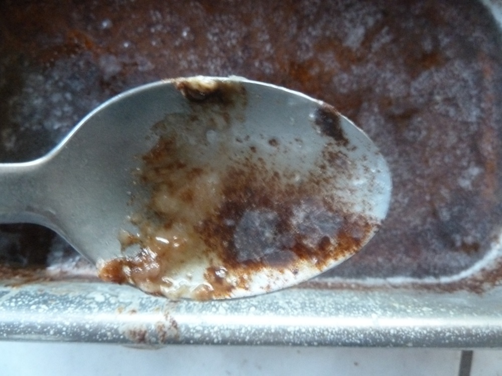

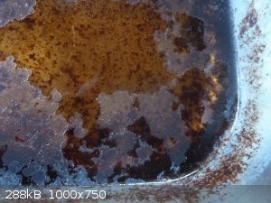

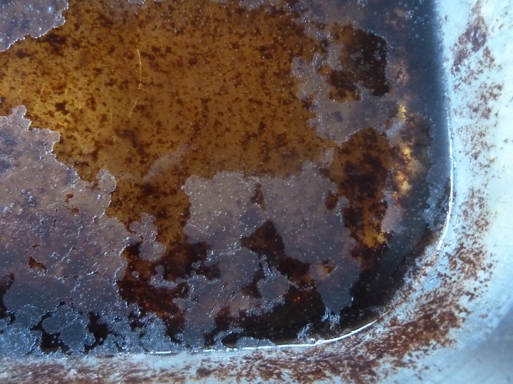

Last year I got a bag with magnesium nitrate hexahydrate, fertilizer grade, brand name is "Krista-MAG" from Yara in Germany. The bag was sealed and bought directly from an established supplier/wholesaler, therefore adulteration is very unlikely.
Yesterday I decided to open the bag and to dry a kilogram to get (almost, it´s difficult to remove the water completely without decomposition) anhydrous magnesium nitrate as desiccant.
The bag contained granules/prills of a few millimeter diameter, no crystals, free-flowing, completely white, somewhat shiny. I poured about one kilogram in a stainless steel bowl (carefully cleaned) and heated it several hours above my closed fire place .
Soon after heating, a weak hissing noise was detectable and the prills start to melt. After about an half hour, a clear yellow liquid was formed. A very gentle boil was visible and the dehydratation proceeded.
As far, as good. But after about an hour, the yellow color changed to amber and finally brown and a flocculent precipitate was formed.
Finally, a considerable (see attached jpeg) amount of dark brown crap was formed. I have no idea how I could remove this crap from the hot molten magnesium nitrate. As soon as I started to mechanically separate the crap (for example, with a stainless steel spoon), it starts to solidify at least partially. Under these circumstances, a filtration with a buchner funnel will not work , nor will it be possible with a stainless steel sieve (immediately clogged and solidified).
Surely, filtration of 200 to 300 degree centigrade hot molten salt is technically possible, but under amateur conditions (typical sciencemadness setup) it´s very difficult and no feasible way IMHO.
So I think the crap must be removed prior to heating/dehydratation. I have no idea what kind of additive YARA used. The material safety data sheet stated unter chapter three number 3.1 "substance with a single compound" (sic!)

I would go out on a limb and say that your mistake is heating/melting magnesium nitrate in a stainless steel bowl...
The nitrate ion is a powerful oxidizer, I would imagine that it would oxidize most metals, except the most noble ones.

Thank you for replies and suggestions. Yes, hot nitrate solutions are aggressive and could dissolve a fraction of the stainless steel bowl. On the other hand, I´ve used this bowl to evaporate and dry concentrated ammonium nitrate solutions several times , sometimes up to the melting point and I´ve never observed such a discoloration and flocculent precipitate.
I´ve also checked the weight of the bowl and it´s still the same. Maybe a milligram quantity is lost, not enough to detect it with my scale.
I´d like to use another bowl (not stainless steel) to check if the discoloration comes from the metal, but I have no idea what material I could use instead. The solidified salt cake is hard like a rock and I required many hammer blows to get it out. Therefore porcelain or glass isn´t a good idea.

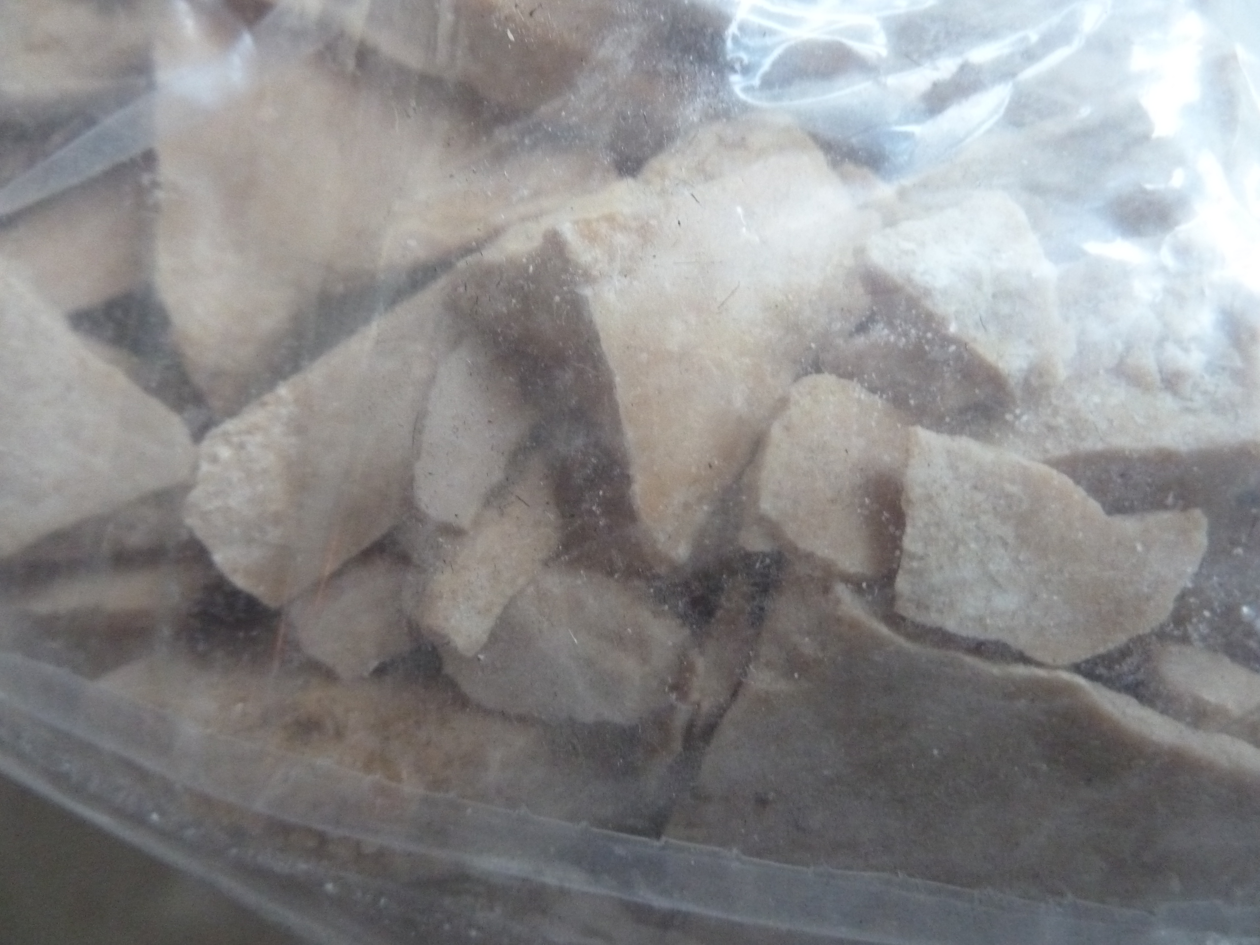

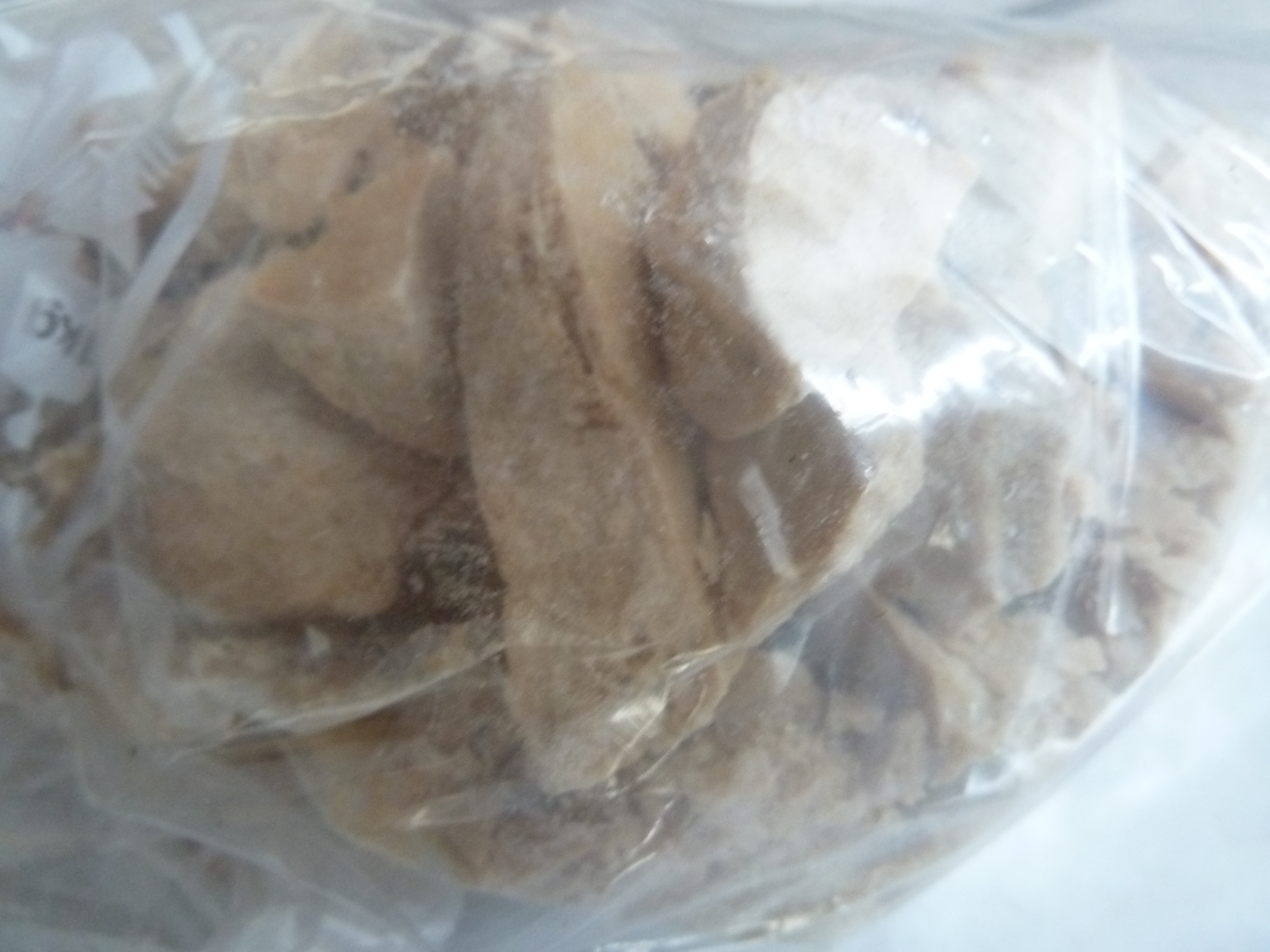

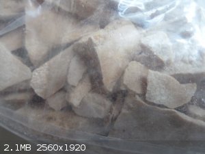

You´re both right. I´ve just calculated the weight loss, the water content of the hexahydrate is about 42% (148,3 / 256,4).
I´ve used about 1070 gram hexahydrate ( far away from exact measurement, my lab scale just go up to 200 gram, the kichen scale up to 5 kilogram).
I got about 920 gram yield (weight loss about 14%, this indicates a tetrahydrate).
I´ve decided to try magnesium nitrate as it is recommended and patented as a dehydrating agent for nitric acid, it´s cheap (about 2 Euro per kilogram) and well-available as fertilizer.
I´ve also used sulphuric acid as desiccant. It works fine, but it´s more expensive and the workup of the spent acid is no fun and also dangerous.
The magnesium nitrate route looks theoretically more appealing, but the dehydratation of the hexanitrate is also no fun. Apart from the discoloration I simply don´t know what kind of vessel or pan I should use, if the standard stainless steel can´t resist.
Surely, there are exotic alloys (hastelloy or better) or noble metals which can resist such conditions and are used in the industry, but the availability and pricing are out of my scope :-(
Porcelain or glass is brittle, you can´t get the salt cake out without destruction.
Maybe I should go back to the old-fashioned route potassium nitrate and sulphuric acid and simply discard the potassium hydrogen sulphate.
