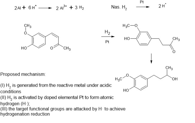

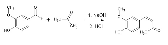

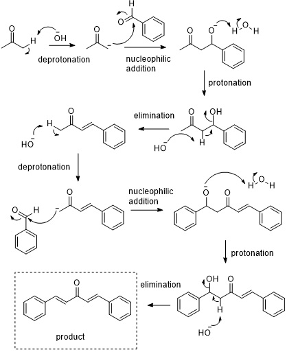

The crossed-aldol reaction on aromatic aldehydes proceeds as here
crossed aldol mechanism.jpg - 46kB
Dehydrozingerone
Curcumin is limited in translatable clinical effectiveness in part due to it's poor pharmacokinetic properties. Dehydrozingerone is a curcumin degradant which is a half structural analog of curcumin. It exists as a natural phenolic compound obtained from rhizomes of Zingiber officinale, which has attracted much attention of medicinal chemists. It is known to have a broad range of biological activities like antioxidant, anticancer, anti-inflammatory, anti-depressant, anti-malarial, antifungal, anti-platelet and many others.
Crossed-aldol reaction of vanillin and acetone
crossed aldol vanillin.jpg - 13kB
The following procedure [1] was scaled up:
In a 50 mL round-bottom flask, add 0.5 g (3.3 mmol) of vanillin then 5 mL (67.5 mmol) of acetone with vigorous stirring. After vanillin has dissolved completely (usually very fast) add 2.63 mL NaOH 2.5 M (the concentration of NaOH is important as using more concentrated NaOH will produce a thick paste mixture which extends reaction time and further complicates the precipitation process).
Allow to stand overnight and then dropwise add dilute acid (2.5 mL 6M HCl etc). Cool in a freezer and collect the yellow shards of dehydrogzingerone.

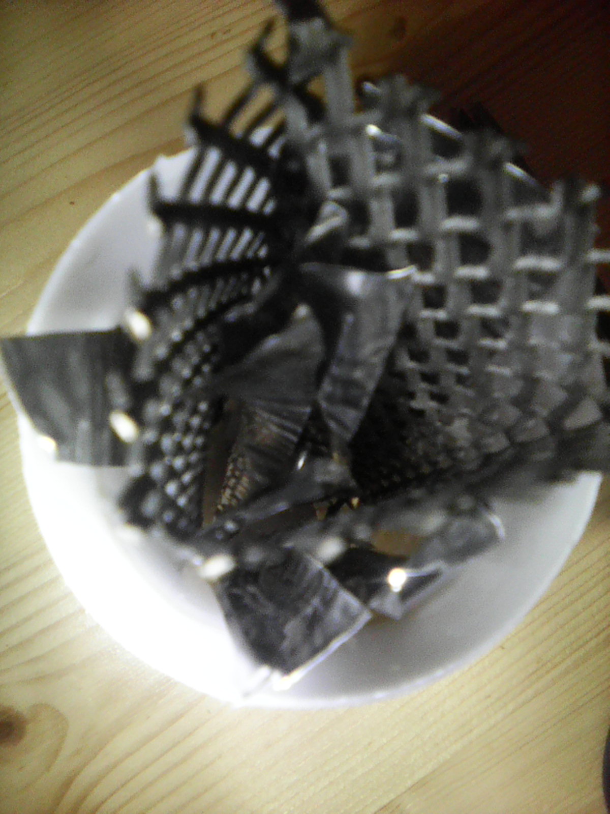

Attempted novel reduction
dehydrozingerone reduction.jpg - 42kB
As a novel reduction experiment, a small-scale novel experiment to attempt to reduce the α,β-unsaturated carbonyl compound was conducted using dehydrozingerone. I can't find much on similar techniques in the literature, other than doing similar with Raney Nickel coupled with electrochemically generated nascent H2 [2]. Wasn't sure if the platinised titanium would have sufficient surface area vs something like Pd/C etc to work, but it looks like it converts the dehydrozingerone to new Rf constituents.

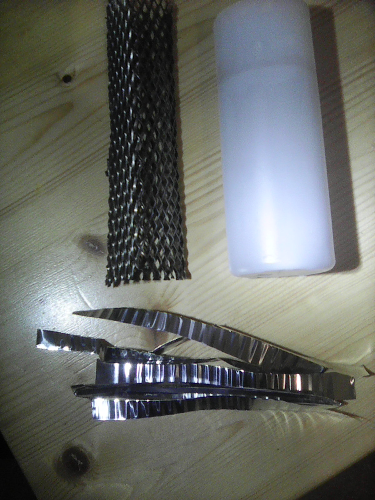

The materials for the experiment
reduction1.jpg - 316kB
Reaction vessel set-up
reduction2.jpg - 270kB

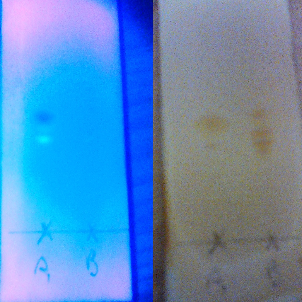

It seems to (?) be quite effective on the 0.5g scale with the compound dissolved in 50% aqueous ethanol. TLC indicates complete reduction of conjugated fluorescent compounds (? divanillylideneacetone impurity in starting product?) and formation of new, similar but lower Rf potentially unsaturated constituents
TLC - sorry for poor image
reduction3.jpg - 349kB
Left lane (A): dehydrozingerone (B) Reaction mixture after novel hydrogenation attempt. Viewed under UV 395nm – first plate and I2 visualisation – second plate.
Olfactorily, there is a formation of a new ginger scent and loss of the yellow colouration of the starting material
It's as simple as some folded platinised titanium mesh as the catalyst, allowing for easy and complete catalyst recovery, whilst generating nascent hydrogen in situ from dissolving aluminium strips and gradual addition of HCl, near the mesh. It's very friendly and simple to do

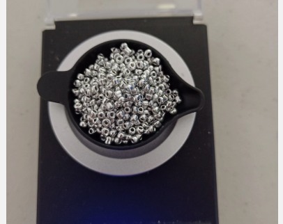

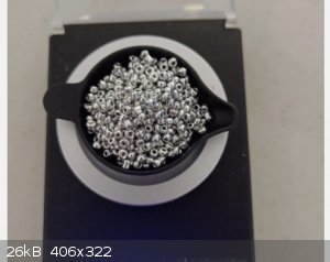

While I have some Pd/C these days, for the sake of amateur chemistry:
Found these REALLY cheap Pt plated beads ($4.95 AU per 500, 2mm Pt plated glass beads). They mag stir really well so curious if they could add another dimension added to dissolving metal reductions eg Zn/HCl eg if the nascent H2 would absorb onto the Pt surface for an added catalytic hydrogenation effect.

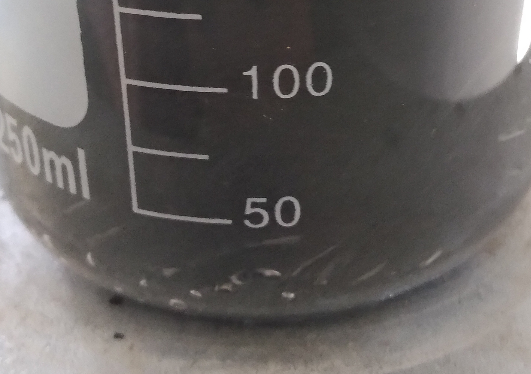

Work in progress. Pictured is trying to utilise the Pt beads in a Zn/HCl reduction

Pt beads zn_HCl.jpg - 1.1MB

[*] posted on 4-3-2026 at 08:27
You need Pd on carbon as it has very big surface. The surface of spheres you have bought is too small.
I did hydrogenation of similar substrate:

Posts: 1134
[*] posted on 28-3-2026 at 23:41
zed - the goal is hydrogenation of unsaturated C=C double bond, Pd and Pt catalyzes addition of H2 to the double bond while the ketone should not be reduced to alcohol
NaBH4 would reduce the ketone to alcohol and not add to the unsaturated double bond
