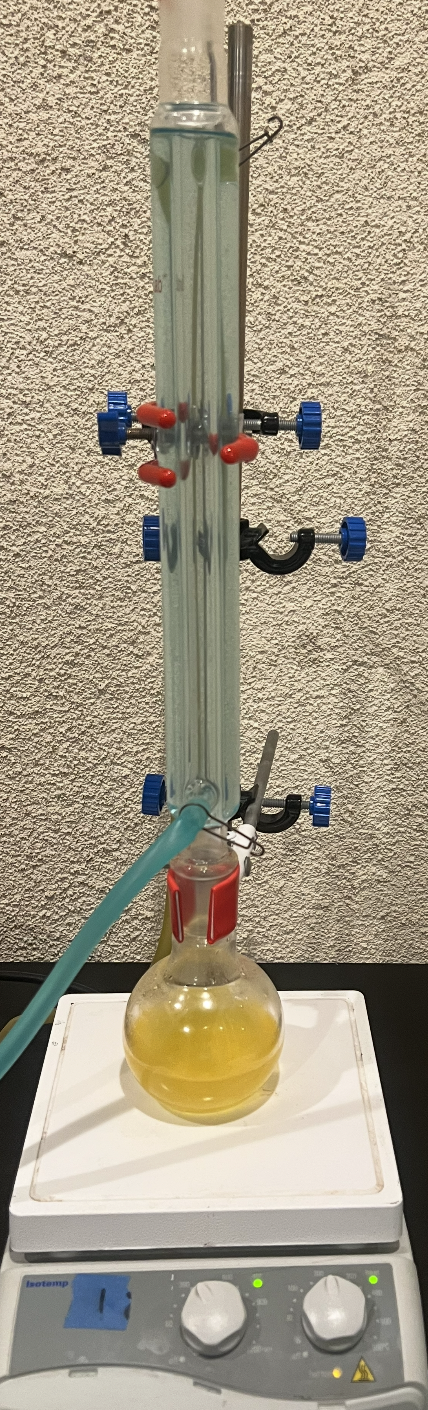

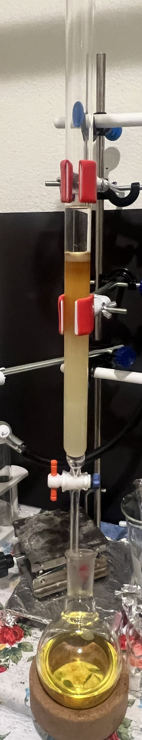

Step 2: Synthesis of 9-chloro tetrahydroacridine
To a 250 mL flask was added 3 grams of 2 aminobenzoic acid, after which 2.7 grams of cyclohexanone was added. 30 mLs of POCl3 was added slowly dropwise with thorough stirring in an ice bath. The ice bath was removed and this mixture was refluxed for 3.5 hrs. It was quenched with iced water and sodium carbonate was added until the mixture was neutral (NOTE: A significant amount of CO2 is released so it is important to use a secondary container and be patient with the additions). The resultant solution was extracted 3 x 100 mLs EtOAc, dried w/ anhydrous MgSO4, and rotary evaporated to obtain a yellow waxy solid that solidifies quickly after removal from the rotovap. This solid was purified via silica gel column chromatography (50/50 v/v EtOAc/ Pet Ether) to obtain 3.1 grams of a crystalline yellow solid (71%; lit: 88%).
Attachment: phpMNxqEO (850kB)
This file has been downloaded 88 times
Attachment: IMG_7546.HEIC (1.1MB)
This file has been downloaded 95 times
Note: This was lower than lit, this may be explained by the fact that this reaction was somewhat scaled up ~3x however it may also be simple deviance in the yields with the authors performing several trials and only reporting the best of those.

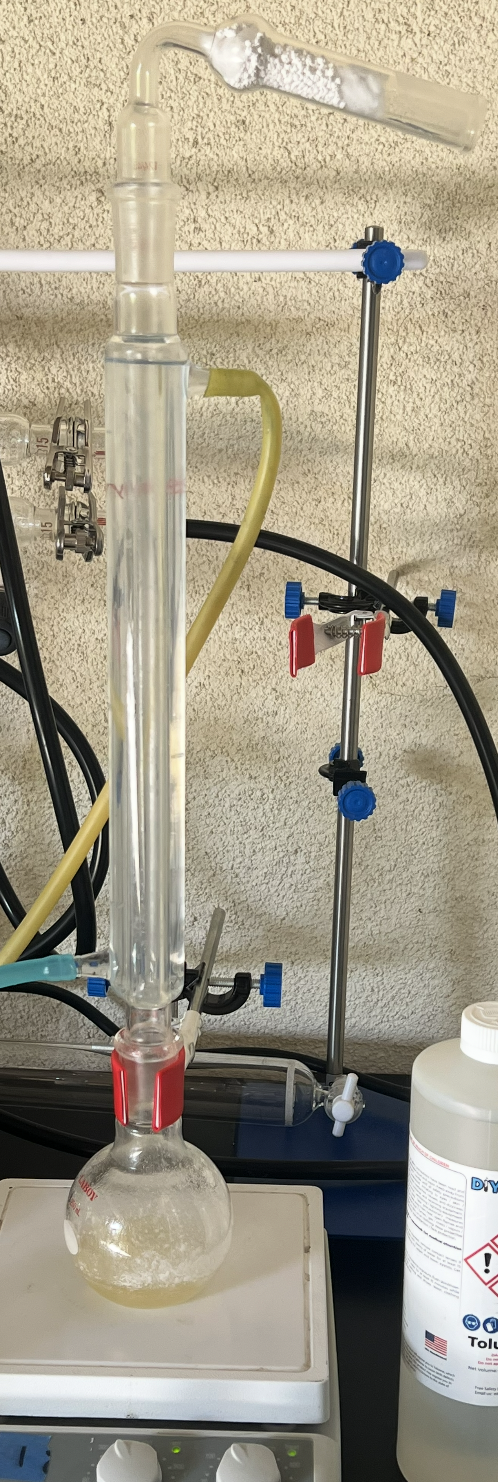

Step 3: Synthesis of Tacrine from 9-chloro tetrahydroacridine
3.1 grams of 9-chloro tetrahydroacridine was dissolved in a minimal amount of 1- pentanol to which 18 mLs of 30% NH4OH was added dropwise. This solution was stirred at 1200 rpm and refluxed for 15.2 hrs. The solution was cooled to RT and acidified slowly with 37% HCl to pH 2. Diethyl ether is added as an antisolvent (just until a small amount of white precipitate is noted) and the whole solution is placed in the fridge at 0 C to crystalize. The precipitate is redissolved in 75 mLs of water and basified to pH 10 with sat sodium carbonate (Note: This precipitates a white solid that is the product, this solid should be extracted). This basified solution is extracted with 150 mLs of DCM, dried over sodium sulfate, the solvent is stripped under reduced pressure.
Attachment: php0sj2LV (1.4MB)
This file has been downloaded 89 times
Attachment: phpvtL61m (1.6MB)
This file has been downloaded 85 times
Attachment: IMG_7550.HEIC (4.4MB)
This file has been downloaded 105 times
The white compound is purified via column chromatography, isolating Tacrine in a yield of 60% (lit:60%).
