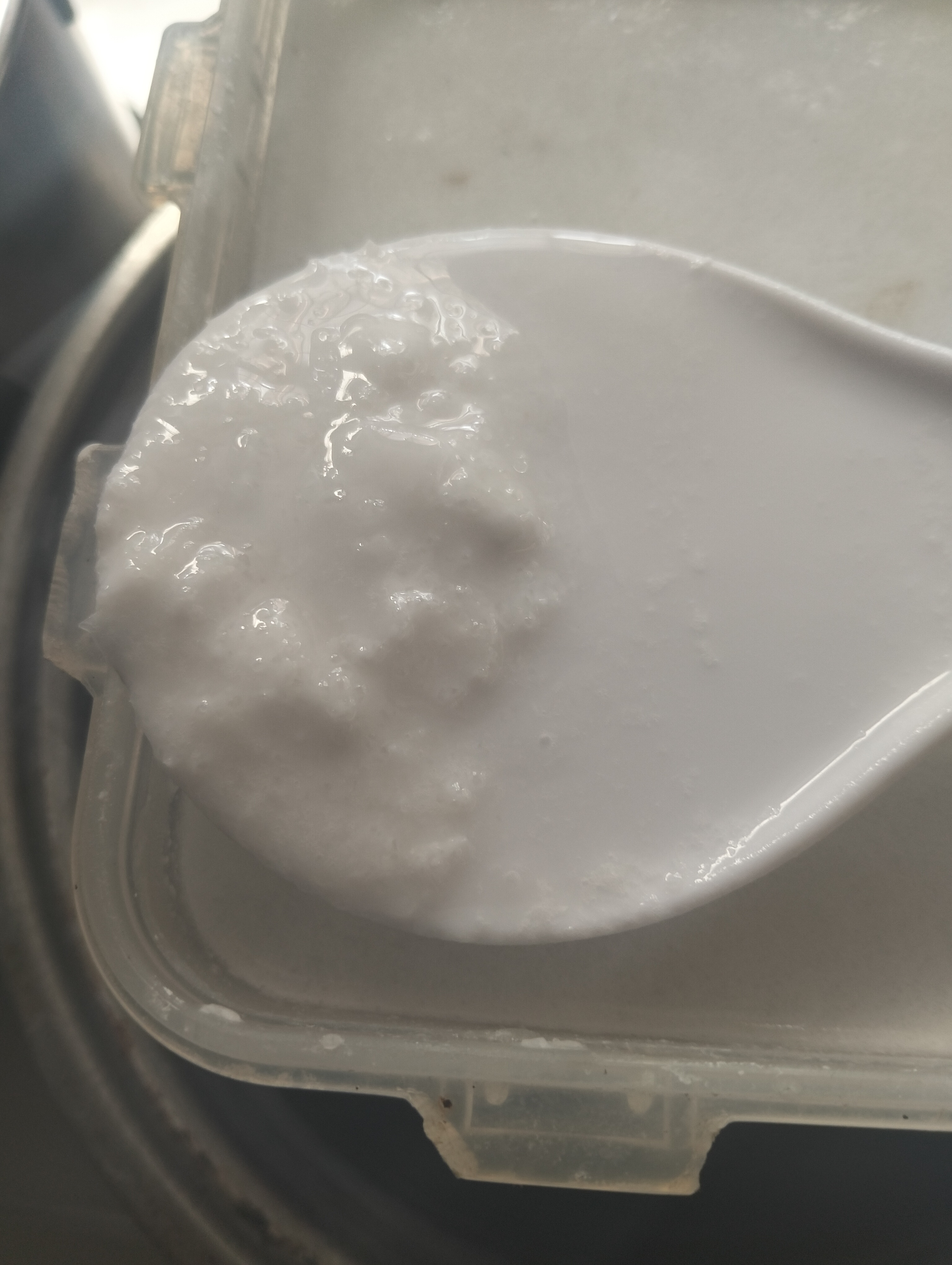

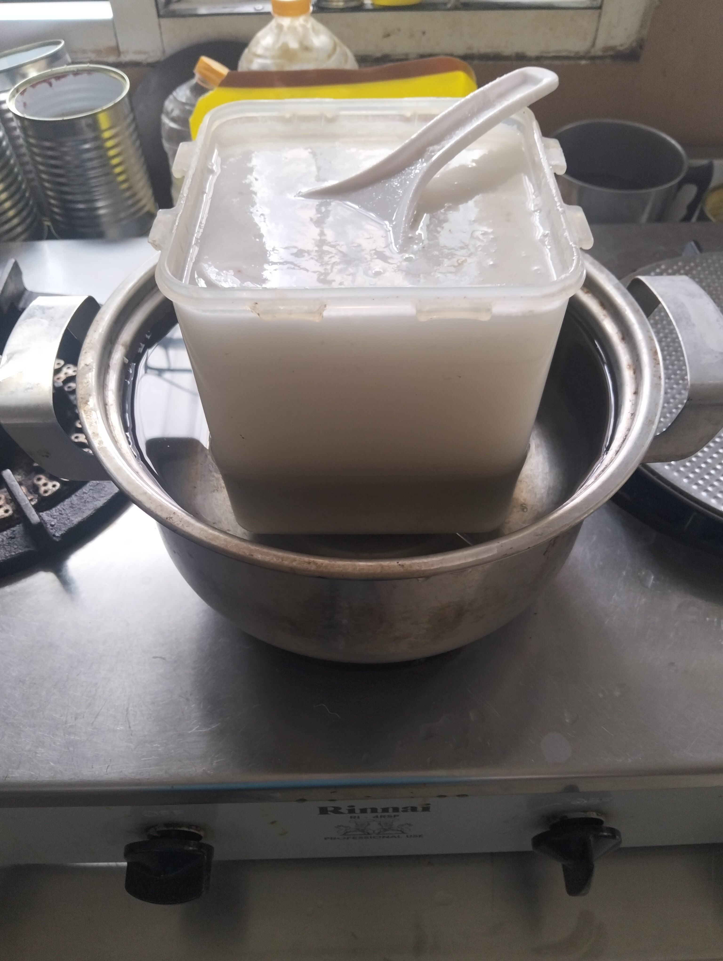

sodium silicate from silica sand and sodium hydroxide solution in water for making calcium silicate
Recently i decided to make sodium silicate or water glass at home by using sodium silicate from finely crushed silica sand and sodium hydroxide solution in hot water temperature about 90 Celsius
I'm making sodium silicate through dissolving 1.5 kg NAOH in 1 liter hot water and 500 gram of aquascape grade silica sand at pp plastic container.
I wanted to know whether can I react sodium silicate in water solution with Calcium oxide to produce calcium silicate brick at home for small scale foundry or oven insulation about under 1 kg of calcium silicate for testing uses.
I wondered why the NAOH solution doesn't just dissolve all the silica sand while there is some sediment still at the bottom.
Also what is the best method to purify sodium silicate solution from the unreacted silica and NAOH at home
PS I DON'T JUST BUY THE CALCIUM SILICATE INSULATION BECAUSE THE SHIPPING FEE AND THE MINIMUM QUANTITY TO BUY IS TOO EXPENSIVE PER KG THAN BUYING CALCIUM OXIDE AND SILICA SAND PER KG.

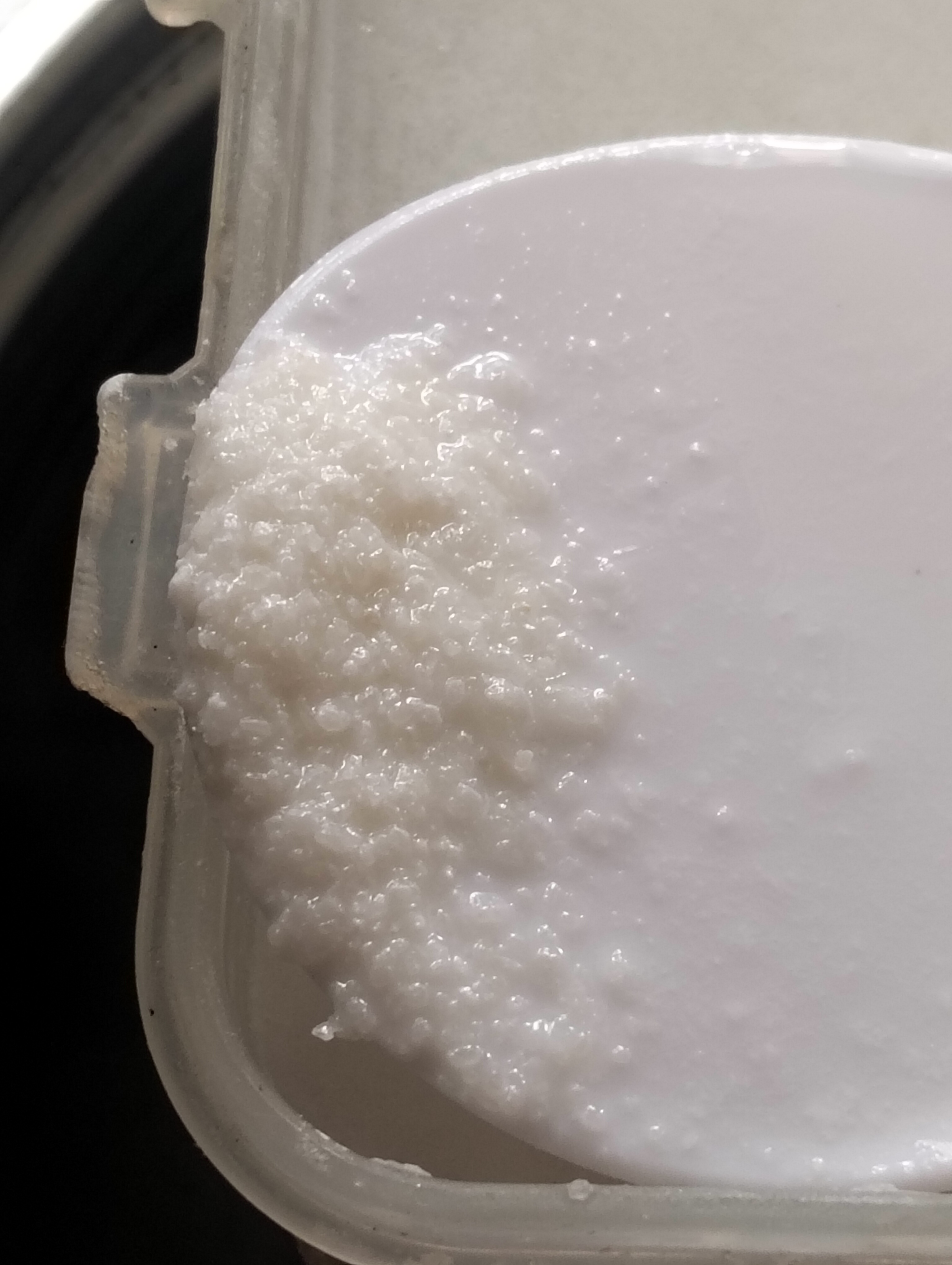

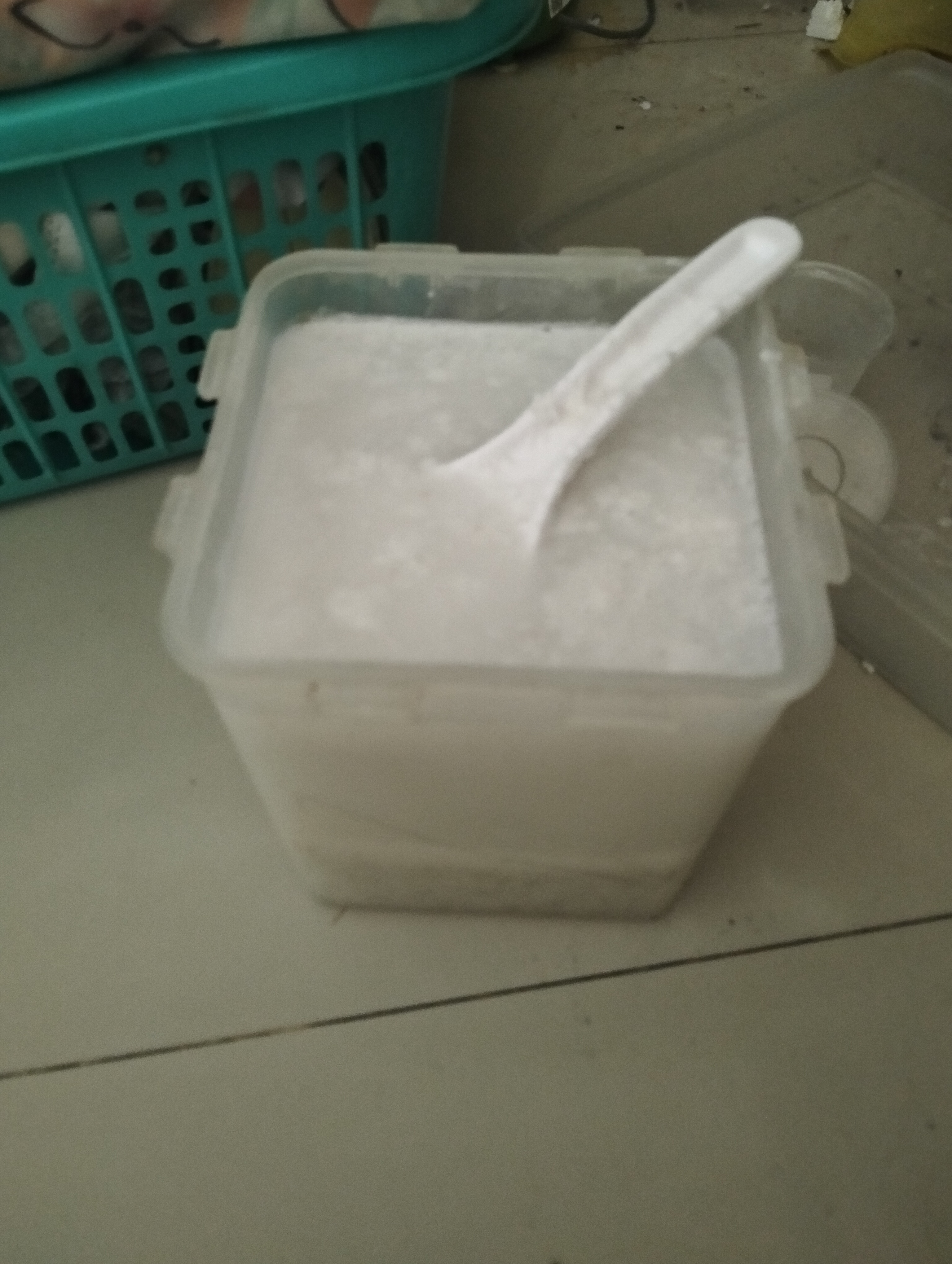

i heated again the NAOH and sicila sand solution
Few hours later i heated again the NAOH and silica sand solution at 90 celsius
The sediment solids it became decreasing but this is what i got
I wondered is this solids an unreacted silica and NAOH?
Did the sodium silicate become soluble in water?
Why there is a crystal floating on the top of the solution?
What kind of compound is the crystal floating on the top of the solution?

A suggestion. Try small scale first. If you wanted to oxidize glycerol with calcium hypochlorite, a small scale test (1 g or so) would show that the result is a toxic smoke and possibly fire. If you went large scale first, you'd be saying goodbye to your lungs.
What is the temperature at the top of the, um, sludge?
Do not use an aluminum cooking pan to heat corrosive substances, even if they're inside another container. Especially if the corrosive substance is an alkali. Edit: It looks like stainless steel but my advice about aluminum still stands.
Remove the crystal and see if it soluble in water. If so, add a few drops of copper sulfate. If the blue solid formed refuses to dissolve when you acidify the solution, then the crystal is a sodium silicate.
I'd be willing to bet $ 20 that you'll end up spending that much or even more with homemade calcium silicate.

[*] posted on 23-8-2025 at 07:07
As it happens I just made a small amount of sodium silicate solution last week.
I used the NurdRage method.
https://www.youtube.com/watch?v=xltvwhogklI
That used silica gel packs that I had collected over time. I ground the silica gel to a fine powder and added it gradually as it dissolved. It is a slow process.
I did it in a small borosilica breaker. (You would think the beaker would be attacked but it wasn't.) I think I ran it at about 65 C. Stirred constantly.
NurdRage has another video where he used crystal cat litter.
Are you sure of the temperature in your reaction?
Sand would probably dissolve even slower.

material for containing the sodium hydroxide and silica solution
i used thick pp plastic container in boiling water bath with stainless steel pot to perform the procedure.
