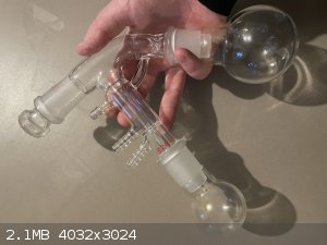

hi i've been making some alkali metals and i need some cesium chloride for a low cost. could you guys point me in the right direction for about 100g?
or do any of you have some i could buy?
also does this glass look effective for making cesium with calcium metal, or will i have to make a steel alkali still?

the glass is boro vacuum rated.

Nah man I would recommend a completely sealed vessle atleast for Cs and Rb.

it is completely sealed and i'll flush with argon
i don't want lithium because it is at least 10 times more expensive than calcium here.

@bariumbromate wait a second are you literally using glass as an reaction vessel?
If you are doing so then you will loose everything including your glass apparatus, glass will melt at the temperatures where Cs will start coming off, use a stainless steel reaction vessel instead.

okay i'll just use a steel one
but this guy used glass to distill cesium but i suppose it would be higher for the synthesis
https://www.youtube.com/watch?v=yI5xzeYj8qM

Chapter 5 of Lerner is about production of metallic cesium by reduction of CsCl with calcium metal at reduced pressure. A quartz tube is used.

In that video he distilled(purified) Cs he didn't make it in that video, when you are using glass to perform the reaction, the CsCl should melt to react with Ca or Li whatever.
It's Mp is somewhere around 800-850. At those temperatures you would find a puddle of glass.
As bnull stated you can use quartz too( if you can get it)
Once you have impure Cs metal you can distill it in glass itself,
I recommend you to watch other clips of Advance Tinkering before attempting this.
Cs boiling point is somewhere around 400C. Glass is ok with this.
