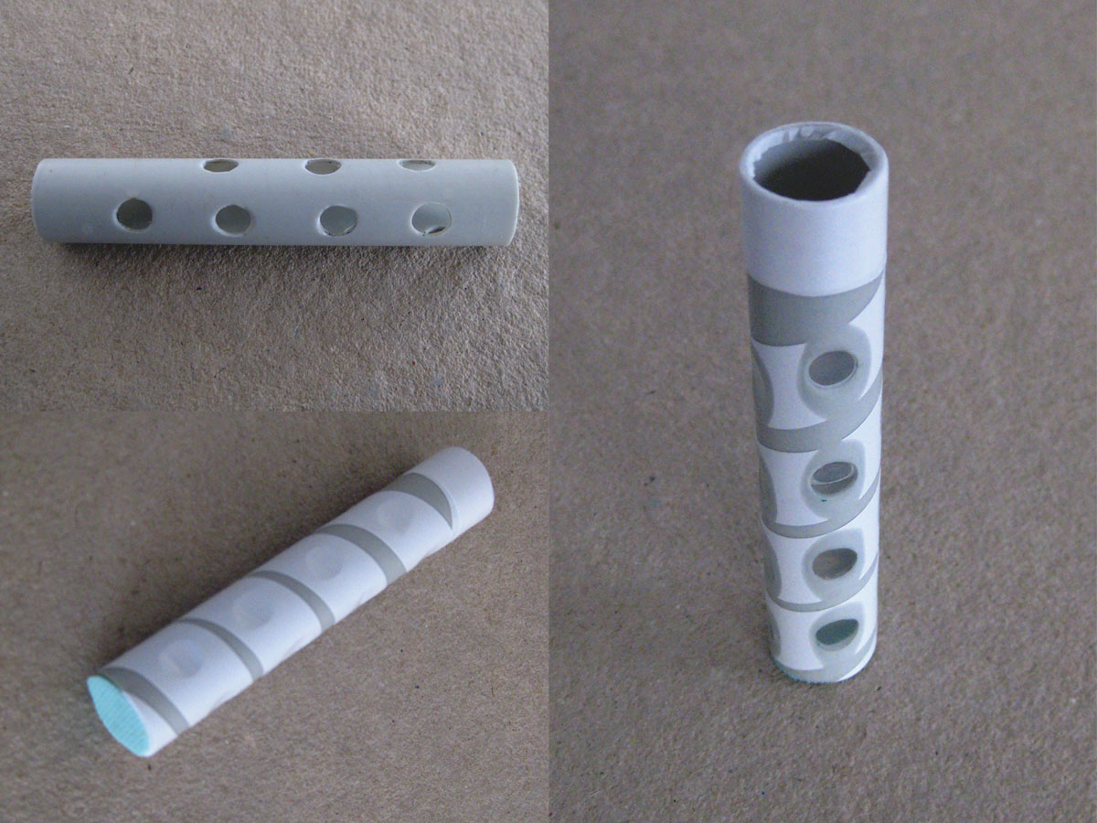

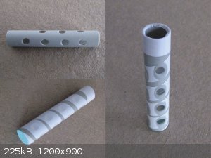

If you want to do tests with PTFE tape, here is an easy way to build an electrode compartment with it:
Drill holes with a diameter of 8-10 mm in a PVC or PE pipe and carefully smooth all edges.
Then wrap the tape over the holes with a little tension. The sealing properties of the tape are sufficient so that no further sealing is required.
If all the holes are arranged in a spiral around the pipe, they can be coverd with a single piece of thread. Just loop the tape around the pipe above the holes, then wrap it over all the holes to the bottom of the pipe, insert the end of the tape into the bottom of the pipe, and seal it with a plug.
This pic shows the PVC pipe drilled, wrapped with PTFE-Tape and filled with isopropanole.

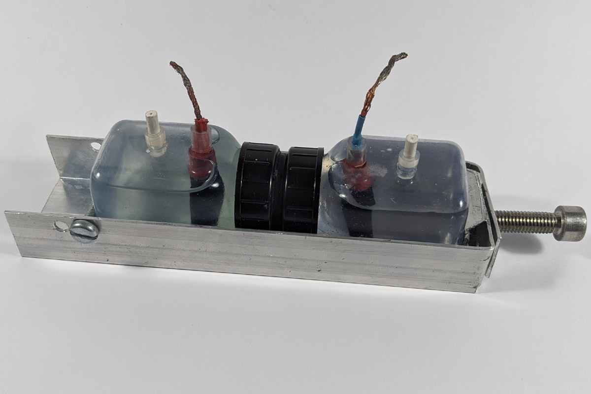

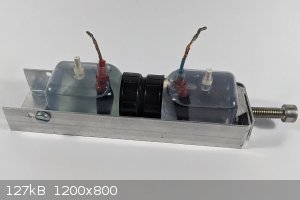

I did a lot of tests with IPA-treated Teflon tape because I was hoping to get a great diaphragm or membrane with it.
In summary, I can say that Teflon tape treated with IPA has high permeability to electricity.
Its permeability to water is also high, but can be reduced by forming a gel.
It didn't work for me as a diaphragm because it doesn't slow down ion migration enough.
The purpose of a diaphragm is to keep the reduced or oxidized ions in their half-cell.
In a current flow test, 5.8V were required for 1000mA compared to 5.1V without any separating layer.
Most of the tests were done using the test cell, which you can see in the picture.
It's using a separating layer with a diameter of 20mm and two 50 ml containers.
In the drip test with IPA-treated Teflon tape, 23.5g of 35g water leaked out in 24 hours.
In the same test with gel (2g xanthan per liter of water), only 6.7g leaked out.
The most important test is the acid-base exchange test.
For this, I filled one container with 50g of diluted sulfuric acid (0.3 mol) and the
other side with distilled water, to which I added 1ml of sodium hydroxide solution (10%) to make it alkaline.
As a separating layer, the IPA-treated Teflon tape was used.
It took 60 minutes until the water side has become acidic.
I repeated this test, but placed the cell at an angle so that the water-base side was higher.
It also took 60 minutes.
Then I did another test with the cell tilted and additionally thickened the diluted acid with xanthan gum.
That took 100 minutes.
This test shows that ion migration has different speeds and rules than water penetration.
Cell_setup_membrane_test.jpg - 127kB
