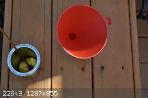

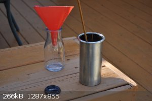

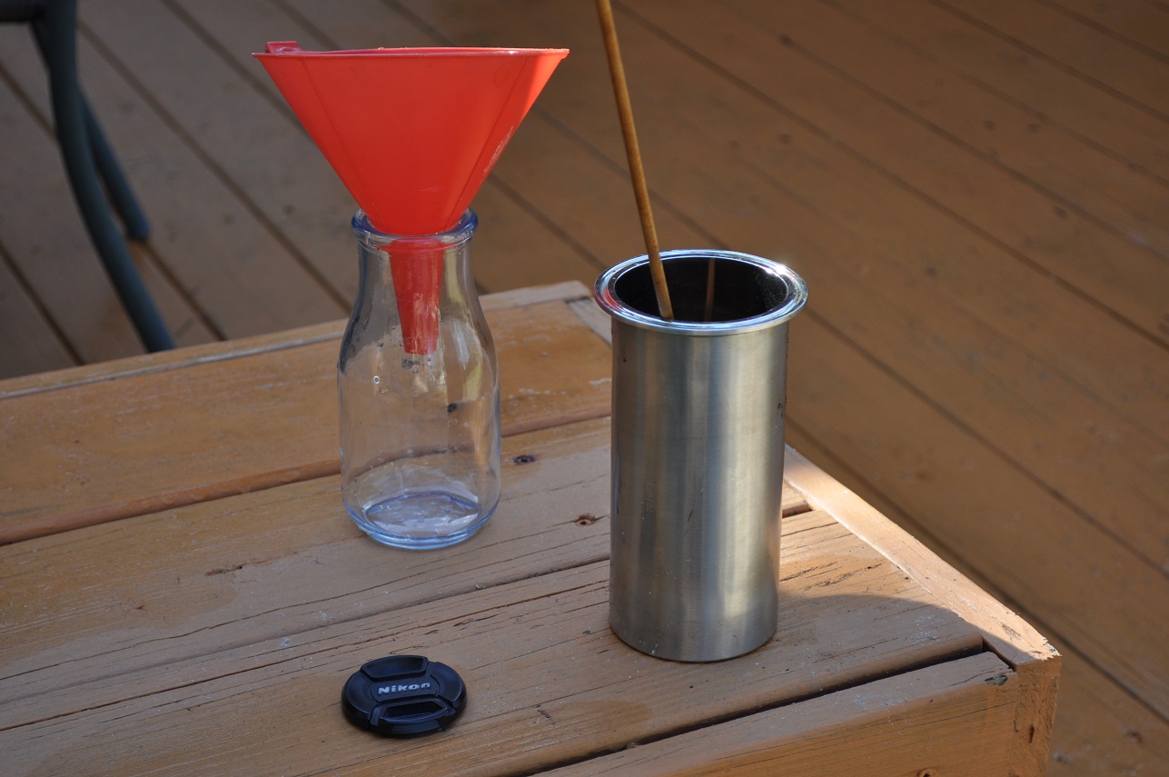

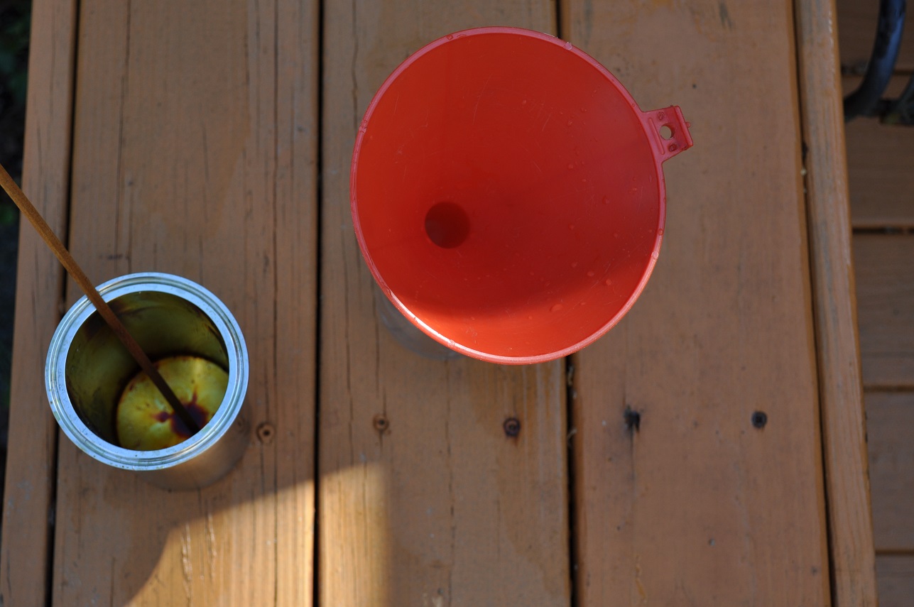

A follow up on sensitized nitrogen triiodide with methanol ... I put less than a teaspoon of iodine in a Tri clover sanitary steel jar/bottle, added some clear household ammonia, and then slowly decanted the liquid. The muddy triiodide mostly remained in the jar to which about 150 ml or so of water was added. Next, try as I might, tapping and prodding the bottom of the jar with a meter long thin wooden dowel, I couldn't get any pops or "bumping". So, all this was disposed of, dried and exploded on filter paper and the test started anew.
The next trial, about a teaspoon of iodine was added to the bottle with about 150 ml of old household ammonia. The crystals were stirred in the steel bottle tapping and crunching the iodine to break it up and react again as before. With the reaction complete, the liquid portion was slowly tilted/decanted so that the heavy pasty solids remained near the bottom. Then about 150 ml of methanol was added to the muddy paste at the bottom of the jar.
All this was done at an angle so that my face or hands weren't directly above the heavy walled steel jar. Prodded lightly with the wooden dowel once or twice a few energetic pops occurred originating from the submerged explosive. The jar was then moved off the deck and onto a steppingstone. The very next tap on the bottom of the jar with the flimsy wooden dowel caused an impressive explosion, blasting all the material and methanol straight up in the air, reminiscent of some trichloride videos seen on YouTube. Although my hand was not directly above the jar and about a meter away holding the end of the dowel, it got hit with some of the spread or spray and stung for just a brief moment, leaving my hand with an iodine stain. I think having the methanol at least dampens some of the energy of an otherwise dry triiodide.
On yet another trial, the triiodide exploded without any provocation, quite a surprise, just about a minute after adding the methanol. The blast with the methanol and submerged iodide is an interesting effect. If you don't like waiting for wet triiodide to dry, this is the way to go.
I asked AI on my phone the reaction of methanol with triiodide and got this funny answer.
Handling in Solution: In a solution like methanol, the compound is more stable and less prone to spontaneous detonation compared to its dry form. However, reports from amateur chemistry forums indicate that even wet nitrogen triiodide under methanol can produce "underwater explosions" if disturbed, albeit less sensitive than when dry.
A note of caution, your results may vary. It would be a good idea to wear a face shield and hearing protection. And never look down into a bottle or put your face or body over or in the path of a possible trajectory of the blast. Just adding methanol to newly made triiodide means danger time has started the instant the two combine.
Oddly, when I added methanol to an ammonium hydroxide/triiodide solution without decanting the ammonium hydroxide, for some reason most of the triiodide didn't even pop or snap as it dried on the ground or on filter paper, reverting to iodine passively perhaps.
DSC_0099.JPG - 229kB DSC_0101.JPG - 266kB

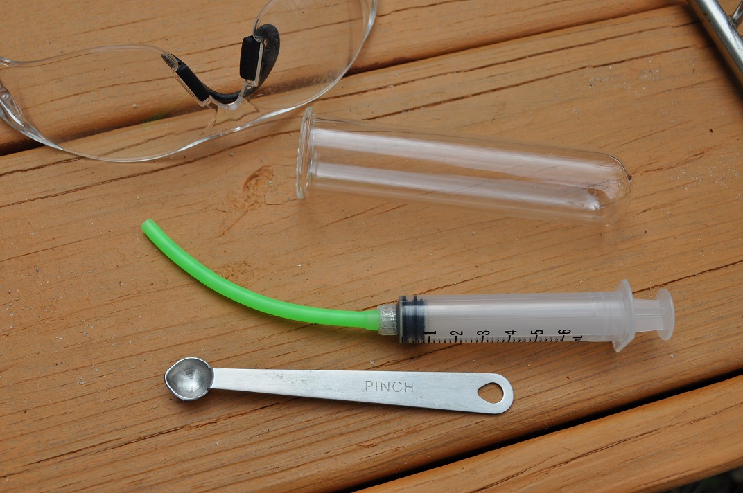

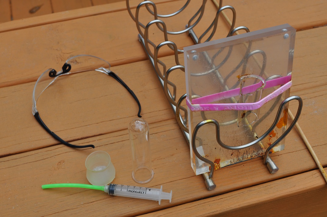

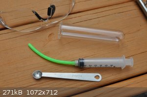

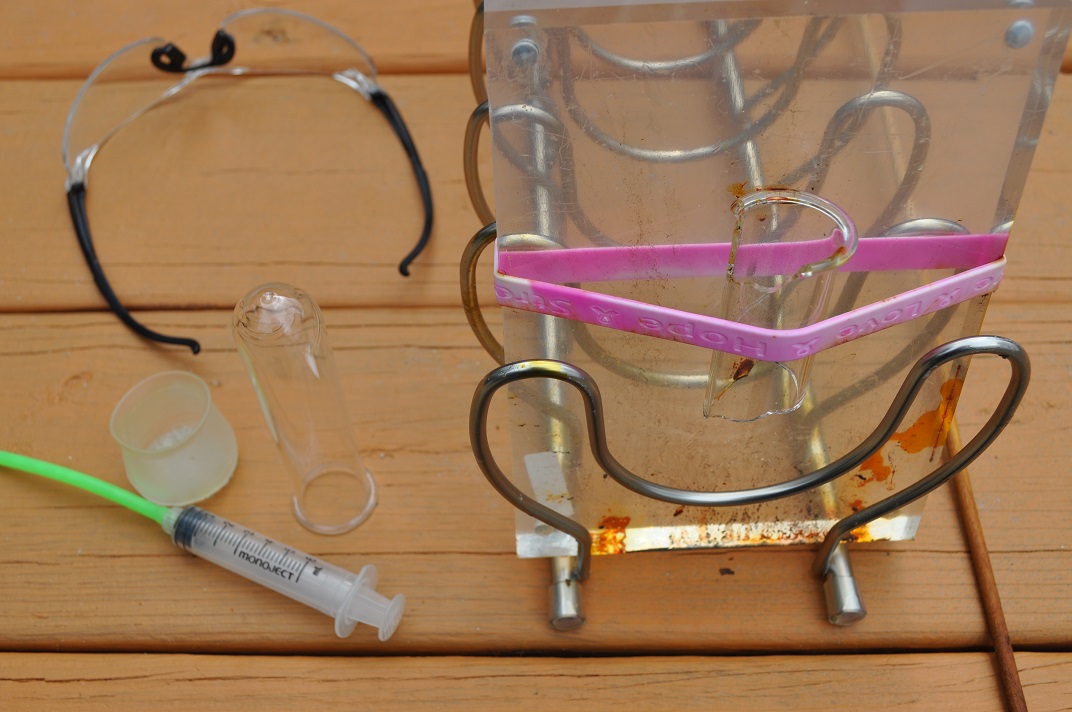

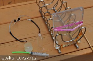

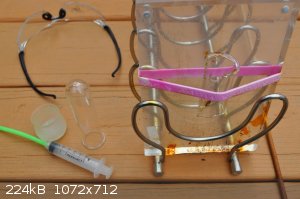

Today I tried putting a pinch of iodine in a small test tube and then added some household ammonia and waited for about 20 minutes. Then the tube was carefully tilted and the hydroxide decanted. The iodide did a pretty good job of staying on the bottom of the test tube without the need to filter paper or gather it. Next 5 ml of methanol was added, the green silicone extension so that it could be added on the safe side of a -2 cm thick acrylic picture frame, two magnetic pieces really.
With a long wooden dowel the mixture was tested/gently stirred and only a faint pop occurred under the methanol. Then, becoming more aggressive, as much as I jabbed at it nothing else happened after that. Recalling a previous experiment where after some time and a partial but big explosion with the steel bottle previously shown, the tri clover bottle sat with still more fluid remaining and out of the blue it exploded again, this time deciding to explode without my help. That got my attention.
Anyway, back to the test tube, after leaving it along for 5 minutes, keeping the above account in mind, I again went to stir the solution with the long narrow stick and suddenly half the test tube shattered with a bang. The sensitivity seemingly improved over time.
The pinch measuring spoon is from a 3-piece set which included a smidgen and dash. The pinch held 0.4 of water when filled with a 1 ml syringe. That was the amount of iodine that shattered the test tube. I've another set and the 1/2 teaspoon is also engraved 2.5 ml. I used a half teaspoon of iodine in the steel jar experiments and that was a little too perky for my neighbors probably. The pink silicone rubber band I bought at an Amazon Where Ya Bin Store, a bag of 200 for 5 dollars!
I should say I initially started with a teaspoon of iodine and then progressed to a half teaspoon experiment and finally the pinch as my ears like that better.
DSC_0102.JPG - 239kB DSC_0105.JPG - 224kB DSC_0106.JPG - 271kB
[Edited on 21-11-2025 by Morgan]
