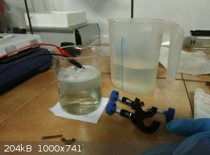

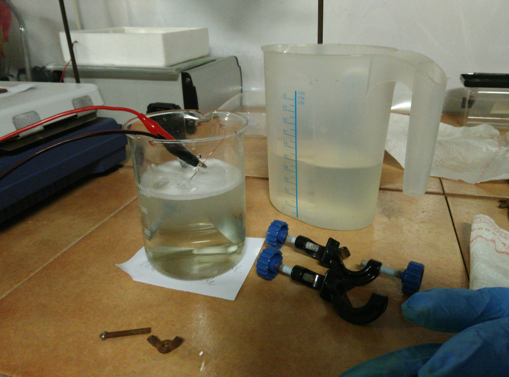

With a current limited power supply (set the limit to about 1A), a zinc strip at the positive terminal (anode), I plated every screw of my lab stands
after attempting to strip the rust with some HCl.
The plating is't very uniform, likely due to incomplete rust removal before plating and the lack of brighteners in the plating bath, but the main goal
was to spend some time doing chemistry and learning something, which I did.
