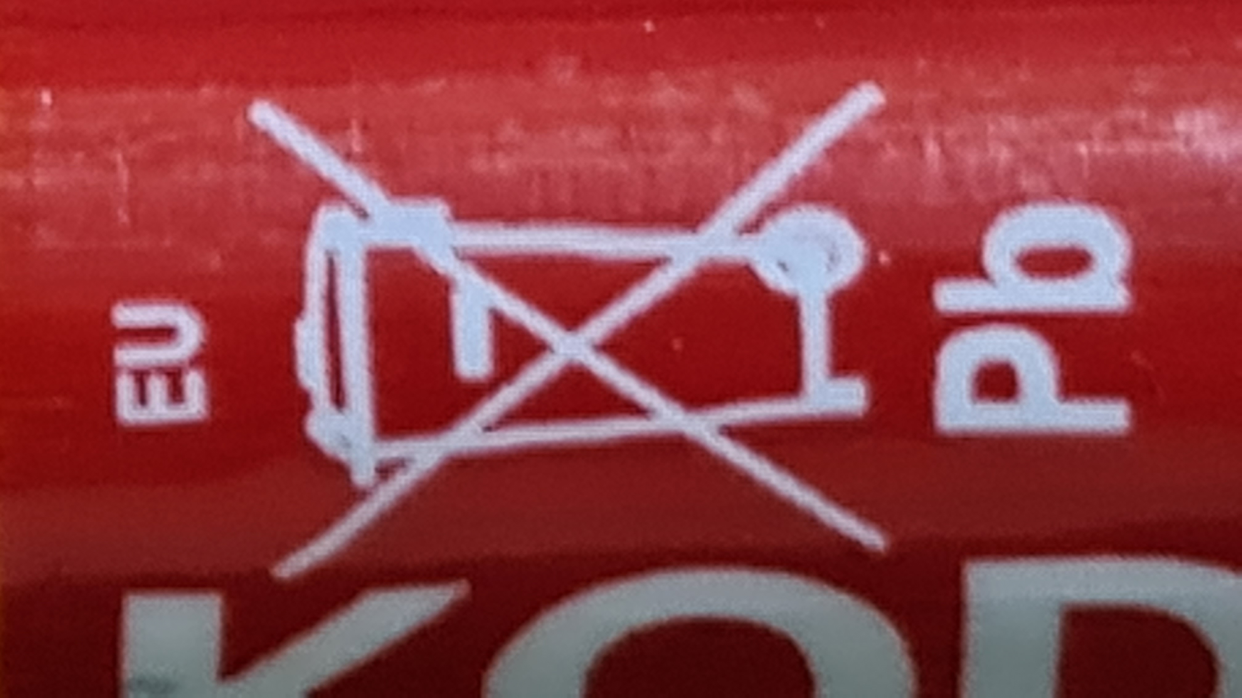

Pb will not be present in such cells.
pesco
Posts: 65
Registered: 19-11-2015
[*] posted on 3-1-2026 at 04:17
20260103_114049.jpg - 1.1MB

[*] posted on 3-1-2026 at 04:39
I have never seen a Zn/C cell with lead in it before.

[*] posted on 3-1-2026 at 12:00
I dug into this and the answer is as always - the EU is stupid when it comes to regulations.
https://www.productipedia.com/kb/productipedia/compliance-re...
That symbol is required for "Battery with more than 0.004 % lead (Pb)". This is such a low concentration limit that battery manufacturers are forced to include it even on non-lead acid batteries like carbon zinc because recycled zinc is often contaminated with small amounts of lead. For example, this MSDS for a carbon-zinc battery states:
"ANSMANN zinc-carbon cells/batteries do contain lead, and do not contain cadmium and mercury
as defined by the European Directive 2006/66/EC Article 21;"
Even though the concentration listed in the composition section is freaking < 0.4%!!! (For context it lists it as containing 20-35% zinc).
https://asset.conrad.com/media10/add/160267/c1/-/gl/00130546...
In other words, it's like the dumb California Prop. 65 warning "may cause cancer" which is now meaningless because it's on literally everything.

Zinc ore from pretty much all sources contains some amount of Pb. Zinc is cheaper if is not overly purified, so there is some small amount of Pb in (nearly?) all Zinc-Carbon batteries.
My aim is to eliminate all traces of Pb.
