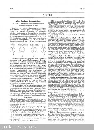

Something like this: E. D. Bergmann, Jacob Szmuszkovicz, A New Synthesis of Acenaphthene, https://doi.org/10.1021/ja01107a501
