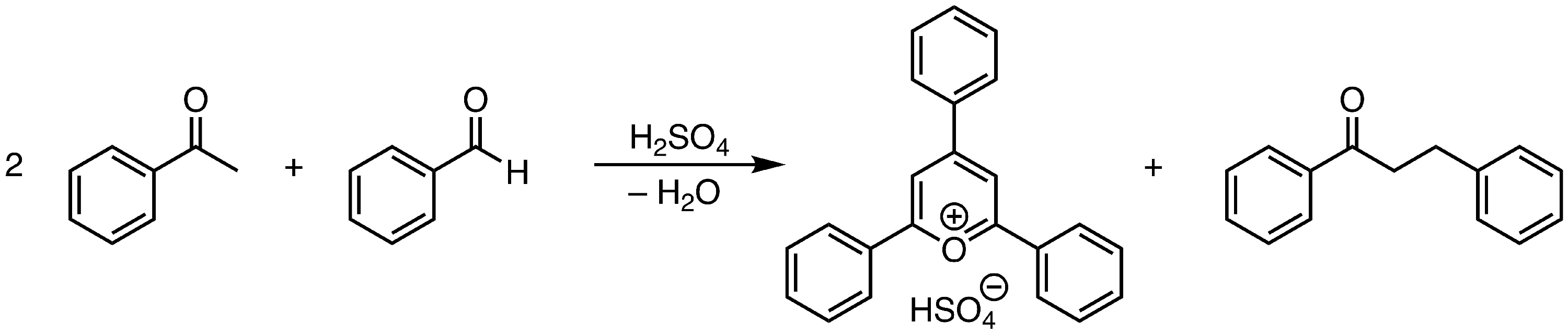

This synthesis is based on a US patent.[2] There are procedures that first prepare chalcone from acetophenone and benzaldehyde[3] and then react that with more acetophenone and sulfuric acid.[4] The yield given is somewhat variable, and while this two step procedure might save a little bit on sulfuric acid, the overall yield based on acetophenone and benzaldehyde is almost the same as the one-pot reaction.
Scheme.png - 35kB
Fig. 1: Reaction scheme.

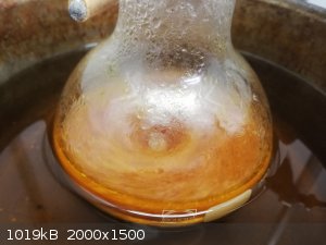

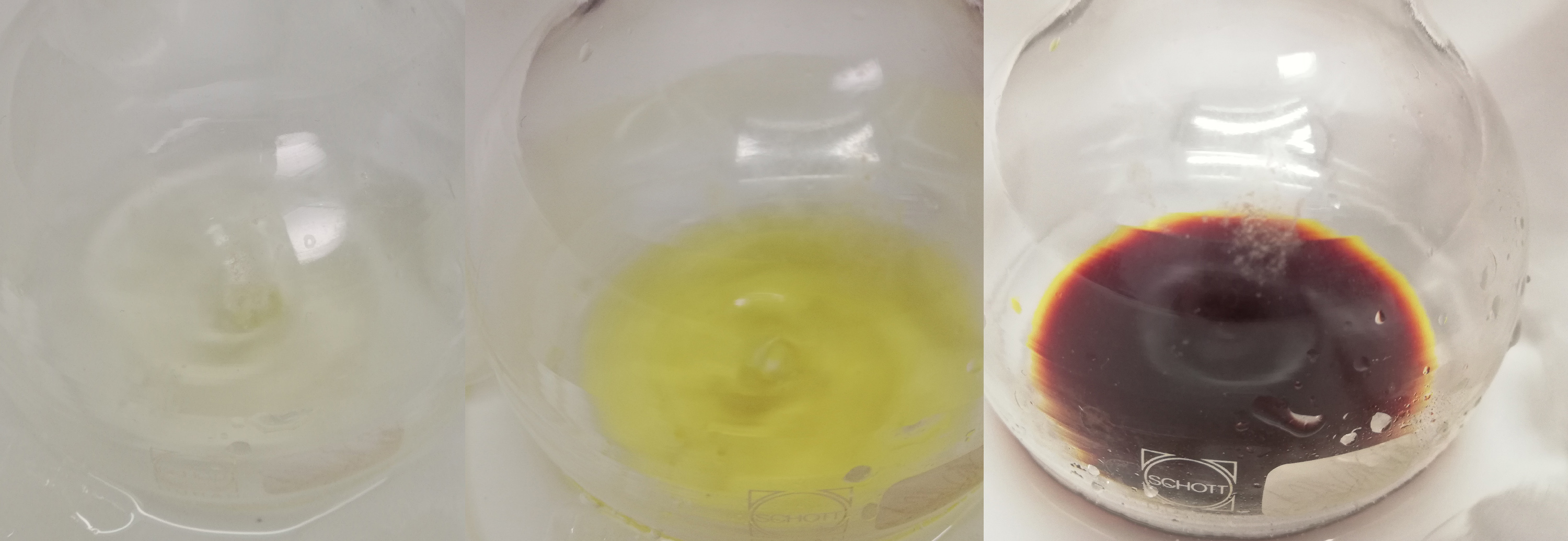

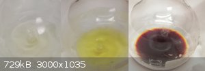

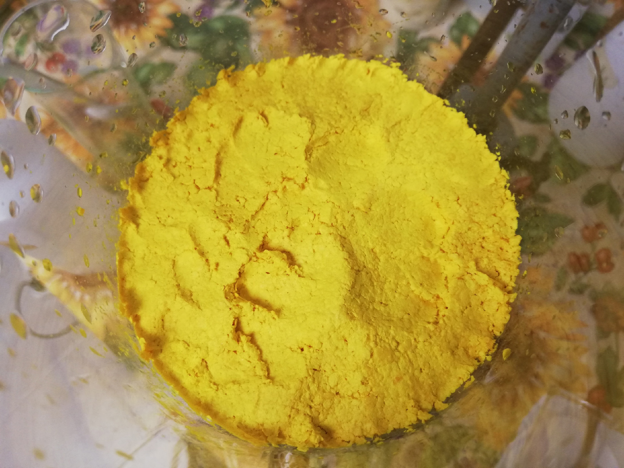

A 250 mL round bottom, single neck flask was placed in an ice bath and a stir bar, 22.3 g (0.186 mol, 1.47 eq.) acetophenone, and 13.4 g (0.126 mol, 1.00 eq.) benzaldehyde (Note 1) were added and precooled. From an addition funnel 20.0 g (95-97 %, ca. 0.194 mol, ca. 1.53 eq.) of sulfuric acid were added during 14-15 minutes. The solution changes from colorless to yellow to red and becomes somewhat viscous.
Color_change.jpg - 729kB
Fig. 2: Color progression.

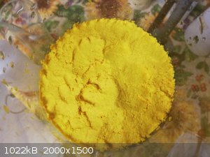

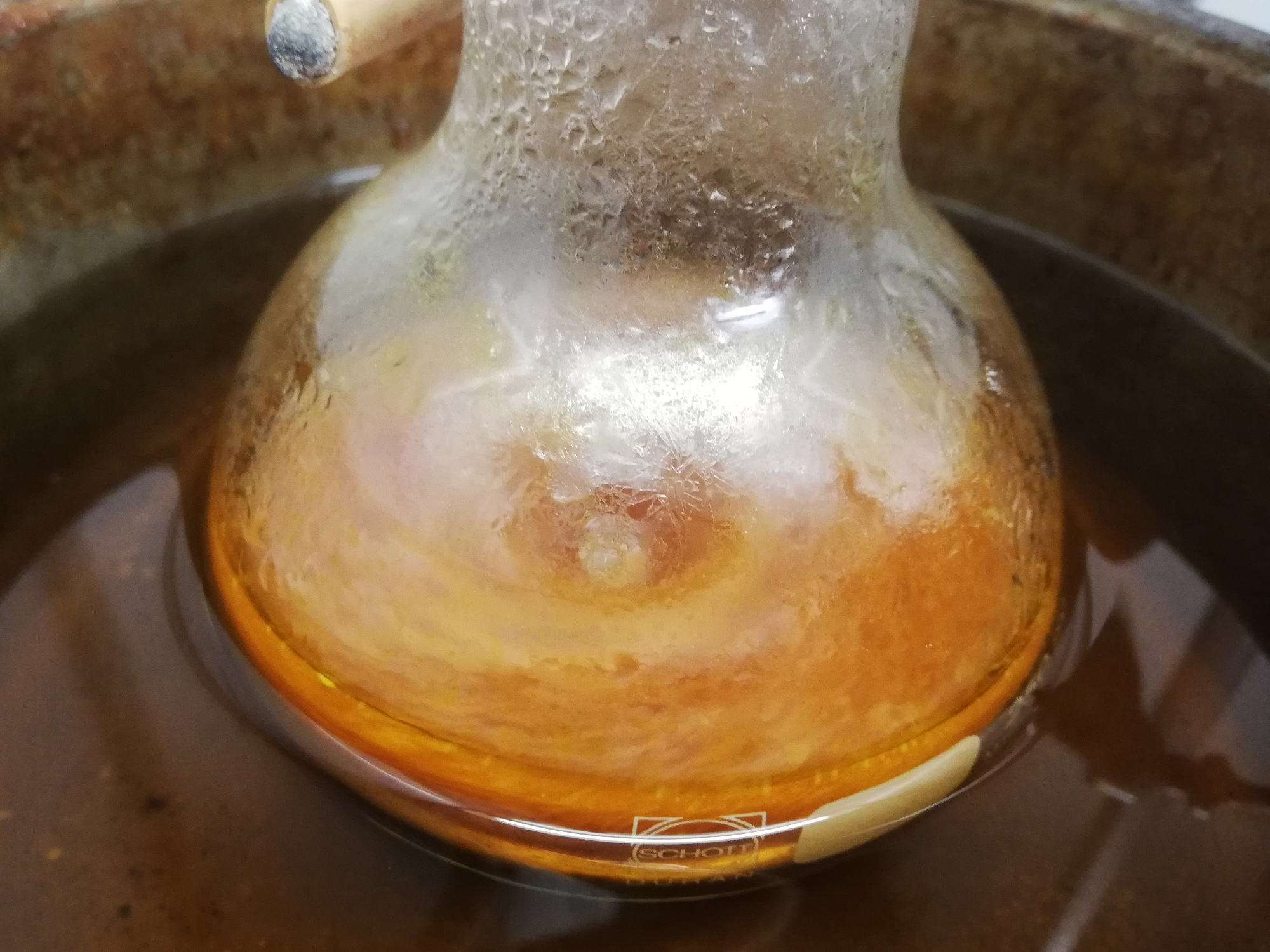

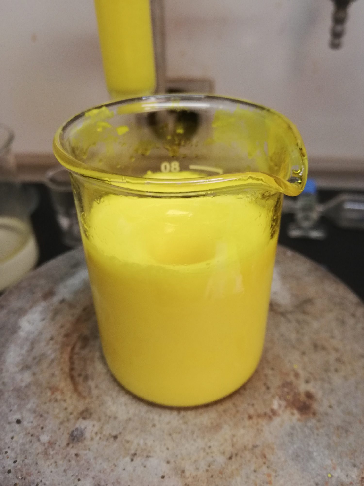

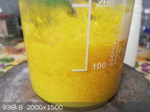

A drying tube with CaCl2 was placed on top and the flask was placed in an oil bath, the oil was then heated to 100-105 °C. The solution becomes redder and less viscous during the heating. Heating is continued for 6 hours. The flask was then taken out, left to cool somewhat and 120 mL of water were added. The mixture is then boiled briefly and a small amount of oil is seen on top of the water layer. It is then gravity filtered through some filter paper containing a small amount of celite. The mixture is then stirred at room temperature until crystallisation begins and placed over night in the fridge. Then it was filtered with suction and washed with ca. 50 mL water. It was then dried at 65 °C for 10 h.
Water_quench.jpg - 1019kB Water_quench2.jpg - 938kB
Bisulfate_wet.jpg - 1022kB Bisulfate.jpg - 938kB
Fig. 3: Workup sequence.

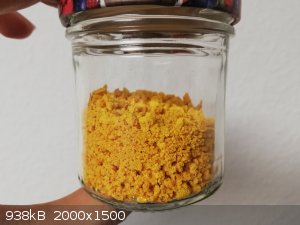

Yield: 15.02 g (0.037 mol, 60 % of the theory, literature: 13.9-15.1 g) of slightly inhomogenous yellow-orange product. (Note 2)
From the various filtrates could be precipitated with 14 % sulfuric acid an additional 0.4 g of product.

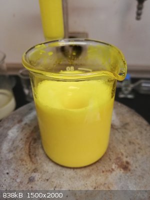

From the residual solutions the perchlorate was precipitated by addition of a sodium perchlorate solution (in excess), which immediately precipitated a fine lemon yellow precipitate. After air drying for several weeks, the mass was 2.51 g.
Perchlorate.jpg - 838kB
Fig. 4: Perchlorate salt in suspension.

I haven't experienced issues with the salt being hygroscopic, though judging from how "crunchy" the dried product is, it certainly seems somewhat hygroscopic. Salt metathesis to the tetrafluoroborate is something I should have tried now that I think about it, perhaps I need to make some follow-up experiments.
Impurities: I haven't detected the dihydrochalcone on TLC (the TLCs were confusing me more than anything to be honest), but one impurity that was present based on GC-MS analysis of a later follow-up product was 1,3,5-triphenylbenzene from trimerisation of acetophenone under acidic conditions. Not a lot though, but detectable. I think stirring the product in cold acetone and filtering should remove most of the impurities, it seems less failure-prone than recrystallization attempts.

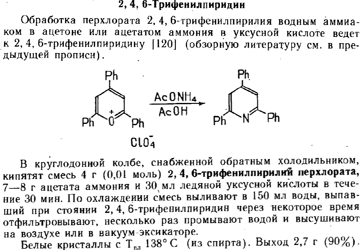

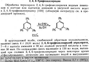

Diachrinic I found an experiment which uses your product as a substrate to synthesize 2,4,6-triphenylpyridine.
In RBF equipped with reflux condenser heat 4 g of 2,4,6-Triphenylpyrylium perchlorate (I hope your hydrogensulfate would work too, just maybe adjust the amount of ammonium acetate?), 7-8 g of ammonium acetate and 30 ml of glacial acetic acid for 30 minutes. After cooling pour the mixture into 150 ml of water. After few hours filter, wash few times with water, air dry or in vacuum desiccator. White crystals m.p. 138 C (from alcohol). Yield 2,7 g (90%).
It is a russian book about heterocycles
http://www.newlibrary.ru/genre/nauka/himija/organicheskie_si...
Пожарский А.Ф., Анисимова В.А., Цупак Е.Б.
Практические работы по химии гетероциклов
http://www.newlibrary.ru/read/pozharskii_a_f___anisimova_v_a...
you should correct the filename after downloading, add it djvu extension and then use a tool to read this very old format
2,4,6-triphenylpyridine.jpg - 262kB
