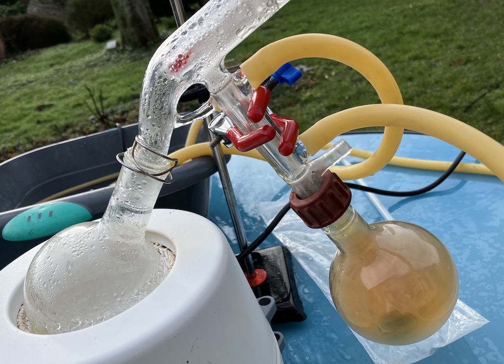

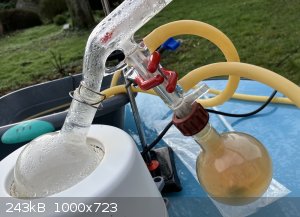

So I did mix methanesulphonic acid with potassium nitrate, heated and distilled the resulting product as it was formed. It seemed to work. Unfortunately I had to move quite quickly from inside to outside when fumes of nitrogen dioxide started to appear, and during the dismounting/remounting probably some traces of water got in, and my final product is green!
I’ll redistill it tomorrow and see if it’s really nitric acid.
[Edited on 30-1-2026 by Keras]

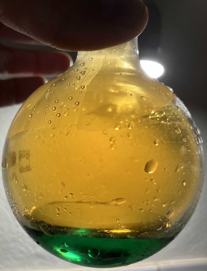

Green is from N2O3.
As below, so above.
Keras
Posts: 1147
Registered: 20-8-2018
Location: (48, 2)
[*] posted on 1-2-2026 at 01:25
Quote: Originally posted by Metacelsus
Green is from N2O3.
I thought this was only stable at low temps?

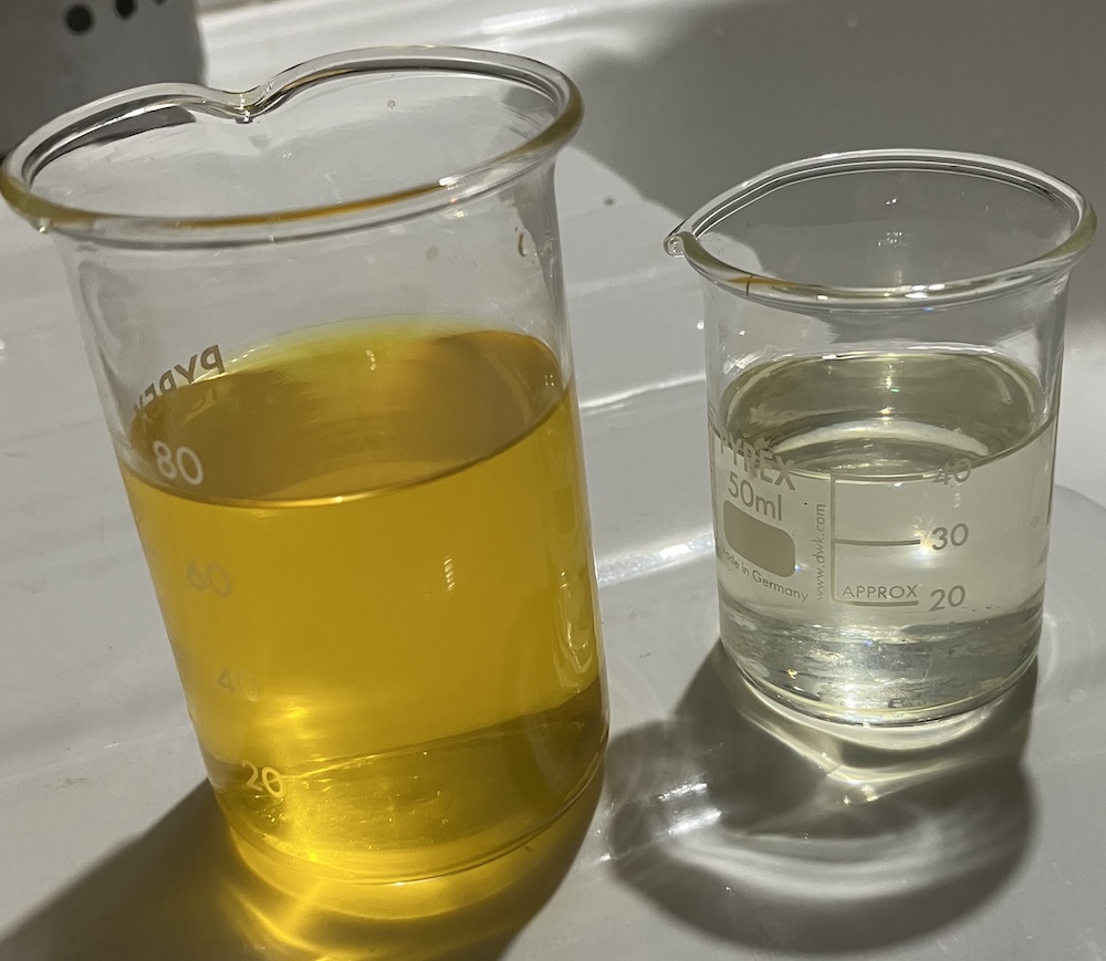

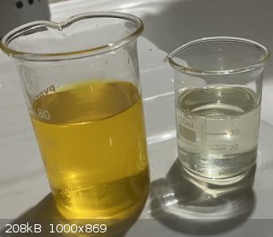

The fact is, this green tinge seem to develop only in a nitrogen dioxide rich atmosphere, as the following picture demonstrate: the nitric acid being distilled is crystal clear, but as it collects in the NO₂-full flask, it turns to green.
In any case. I redistilled this (the blue/green colour went more or less away). The density of the nitric acid solution obtained after redistillation pointed towards 50% concentration (d ~ 1.3). Starting from 70% methanesulfonic acid, it seems a little low.
In any case I took this solution and mixed it with more 70% methanesulfonic acid in the hope of making a nitrating mixture for toluene. The result is: it didn't work. Methanesulfonic acid (at least diluted to 70% w/w) doesn’t seem to be strong enough to protonate nitric acid. The layer of toluene became somewhat yellowish, but after the first washing that colour went away, so it was probably only nitrous oxide in solution. I drove the solution to 40 °C after the ‘nitrating mixture’ addition was over.
Funny thing however: when I washed a second time with sodium bicarbonate saturated water, the aqueous phase became golden yellow. I assume this is due to the bromide ions coming from the TBAB I used as phase-transfer catalyst in an attempt to prod the reaction.
I’m going to recycle the leftover toluene and try a nitrosation.

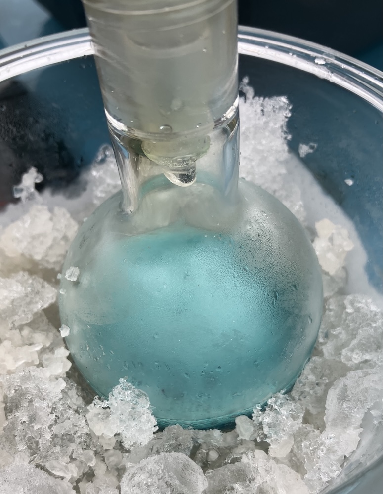

[EDIT]: That didn't work either. I got tons of dinitrogen trioxide in my RBF (see blue RBF picture), but none of it reacted with the toluene.
I’m quite baffled. Toluene is supposed to be slighted activated by the methyl group w/r to benzene, but nitration does not seem to occur so easily. In comparison, phenol is thousand times more reactive, it seems (understandably).
IMG_0684.jpeg - 243kB IMG_0690.jpeg - 208kB IMG_0691.jpeg - 232kB
[Edited on 1-2-2026 by Keras]
