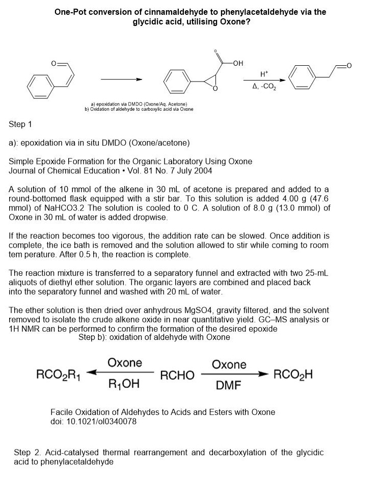

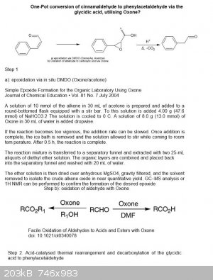

Cinnamon (cinnamaldehyde) to phenylacetaldehyde (honey-like, sweet, rose, green, grassy - imparts hyacinth, narcissi, or rose nuances). A project that hopefully can be followed olfactorily with the nose and via TLC etc
This was a small-scale feasibility experiment to see if such a reaction I conceptualised actually worked.
Tried to see if dual epoxidation and oxidation of cinnamaldehyde with Oxone in aqueous acetone afforded the glycidic acid, which could be heated with aqueous acid to promote rearrangement and decarboxylation to phenylacetaldehyde

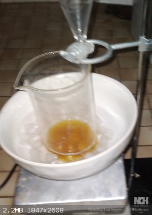

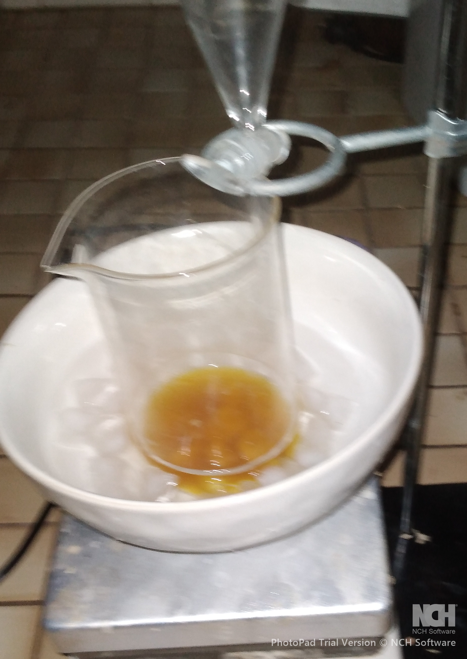

Cinnamaldehyde (13.2g, 100mmol) and sodium bicarbonate (40g) in 200mL acetone was vigorously stirred in an ice bath whilst Oxone (80g x 2, 160g total) in 600mL water was added dropwise slowly, maintaining a low temperature in the reaction mixture despite the exotherm. After addition of the last Oxone solution, the reaction mixture was allowed to return to room temperature and stirred overnight. An orange-yellow oil with a distinct sweet aroma was separated and treated with hydrochloric acid (50mL, 15%) at 80 deg. C for 15min.

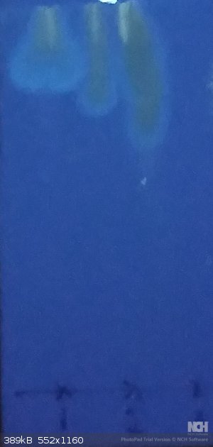

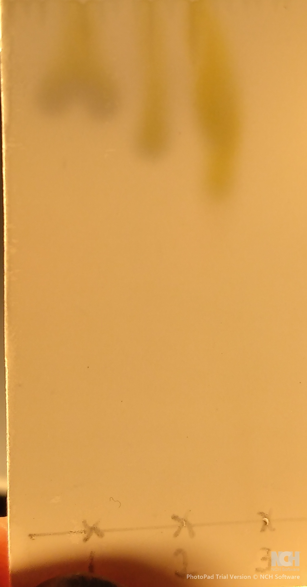

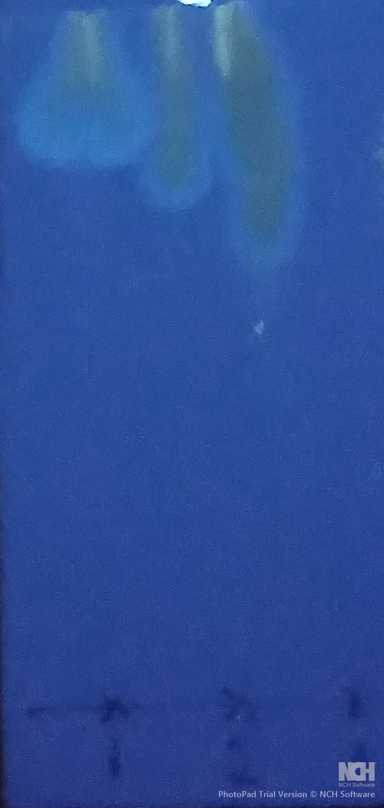

The reaction was followed via TLC, using acetone as the mobile phase.
a) cinnamaldehyde
b) reaction mixture after treatment with Oxone in aq. acetone
c) new products formed after short duration of heating in aq. HCl

Your TLC looks like mostly if not completely starting material, but it’s hard to say for certain because your mobile phase is way too polar. Try mixing acetone with hexanes or whatever other alkane you can access in varying proportions to find a mixture that will give you cleaner separation of spots, rather than running everything together at the solvent front.
Also, try spotting a more dilute solution. Your spots appear to be too concentrated, which leads to more streaking.

Thanks for the input Texium, yes, still early days with this experiment and definitely needs optimisation, including improved TLC solvent system. Just posting the concept for starters

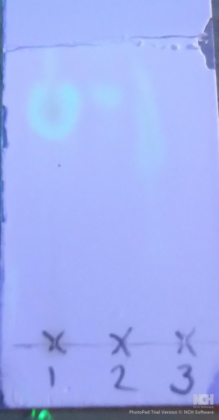

Only had xylenes available for clean non-polars but here's 2:1 xylene:acetone with the samples diluted in MeOH prior to spotting.
1. Cinnamaldehyde
2. Rxn with Oxone product
3. aq. HCl/heat product
[Edited on 22-2-2026 by Alchemica]

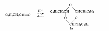

Wouldn't be surprised (if the phenylacetaldehyde actually forms from the glycidic ester) that under the acidic conditions, it further undergoes polymerisation, as discussed in The Spontaneous Polymerization of Phenylacetaldehyde (Erikson and Grammer, 1958):
http://www.electronicsandbooks.com/edt/manual/Magazine/J/Journal%20of%20the%20American%20Chemical%20Society%20US/1958%20%20(vol%20080)/20%20%20(5329-5 582)/5466-5469.pdf
The trimer of phenylacetaldehyde seems to have a mp of 114.5-115°C
