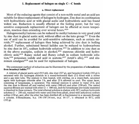

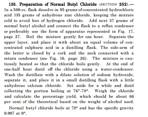

Here's some info on Lucas Reagent and some preparative procedures that may be of interest to you
My [still learning, with plenty of room for improvement] personal opinion is that if the RX to RH reduction was in a sufficiently acidic medium to keep the amine fully protonated eg -NH3+Cl-, the nucleophilicity of the amine would not be problematic enough to allow rapid aziridine formation through easy nitrogen alkylation and as long as most RX is dehalogenated prior to work-up, may work? While things like Mg/iPrOH etc dehalogenations [see: https://orgsyn.org/Content/pdfs/procedures/CV5P0998.pdf ] are seemingly great ways to remove halogens, I wonder if the non-acidic reaction mixture might enhance risk of aziridine formation vs Zn/acid systems

Most welcome. Sorry I saved screenshots that weren't properly referenced my end. Have a feeling the first pic was Norris (see pdf attached), while the second was Weygand and Hilgetag Preparative Organic Chemistry but that's too big a pdf to attach here. Let me know via message if you have troubles locating a pdf.

Something I have noticed is that these procedures always seem to call for anhydrous zncl2 even though they involve addition of aqueous HCl... is that something I really need to pay special attention to?

Definitely anhydrous is the way to go, don't want to be diluting your reaction mixture to even lower [H+] and [Cl-] with hydrated ZnCl2. Mixing anhydrous ZnCl2 with 36% HCl is very exothermic and evolves quite a bit of HCl gas, so ice bath cooling, stirring etc seem important.
