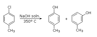

The price of final product is very important for me,my final goal is preparing cheap M-cresol. i want to chlorination of toluene(0.6$/kg) to Para and ortho isomer and then separate para isomer.after that i will hydroxylation of Para-chlorotoluene to M-cresol and P-cresol.I think toluidine is much more expensive that my final product by this method.
For example, treatment of para-chlorotoluene with sodium hydroxide solution at temperatures above 350 ÂșC gave an equimolar mixture of meta- and para-cresols (hydroxytoluenes)
http://www2.chemistry.msu.edu/faculty/reusch/VirtTxtJml/benz...
