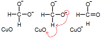

The reaction may be much simpler. Under alkaline conditions, the formaldehyde may convert to
HO-CH2-O-
In the presence of something that can act as a mild oxidizer (such as CuO or H2O2), a hydrogen atom on the carbon atom would be very vulnerable. Only the interesting thing is that the hydrogen atom is merely freed from the carbon, since it is the extra electron in the molecule that is being taken. And of course this would leave behind CO2
formaldehyde-oxidation.png - 3kB

[*] posted on 3-3-2013 at 01:18
I do not think Cu+1 is even stable in aqueous solution. It disproportionates to Cu+2 and copper metal.
Cu+1 salts can form, however, in the form of coordination complexes, such as CuCl2-, which is stable in aqeuous solution. This is often just called (not entirely accurately) copper(I) chloride. Copper cyanide is another.
