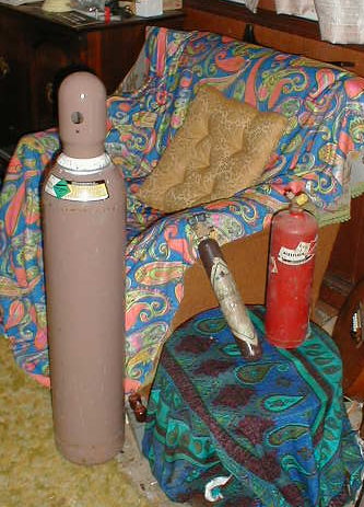

After paying over $100 for the nitrogen tank on the left in the picture, it only costs about $11 to refill it. The price might have gone up, though.

[*] posted on 24-12-2011 at 15:54
Ahh! I thought it weird that you seemed to suggest something like that.
For filling a CO2 canister check out local beer brewing shops, welding shops, or find your local Prax/Air Liquid or whoever sells gas in your area. Every bar goes through a couple bottles of CO2 for their kegs and fast food places for their soda - it is there you just need to dig a bit ;)
Alternatively check your phone book for paint ball places - sometimes the do bulk fills.
