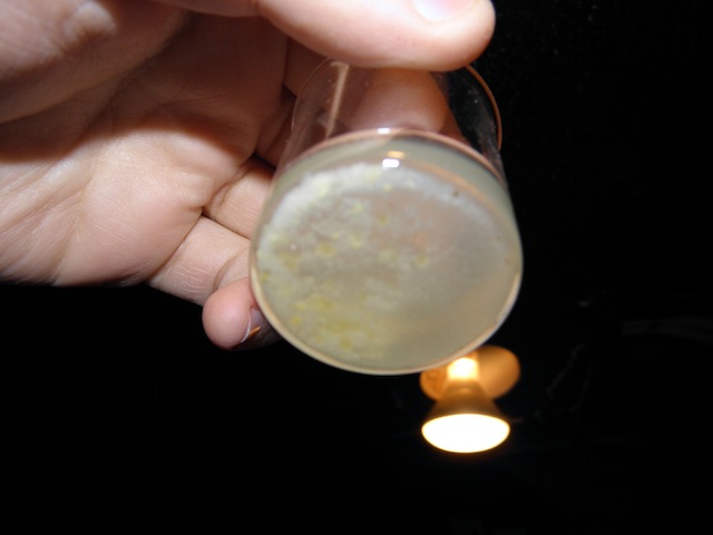

I was wondering whether anyone had any insight into what this lemon-colored titanium complex could be.
It was prepared by neutralizing purple titanium sulfate solution with sodium bicarbonate until it stopped evolving CO2. At that point, a white
precipitate was recovered by vacuum filtration once the solution was chilled to about 5C.
At that point, an excess of acetyl salicylate was added to the now dry precipitate (titanium carbonate?), and a minimum of distilled water was added
to dissolve the chemicals. With gentle heating, a black precipitate was produced (which looked like powdered titanium metal). This was then chilled
and again vacuum filtered.
What I then noticed was that as the filter paper dried, the material on it started turning yellow, and had the needle like crystals of ASA. The
filtrate was then left to evaporate. Two days later, I returned to the lab to find large yellow crystals that form flat plates.
I'm including a picture.
I can try reproducing this procedure with more careful measurement of the reagents if necessary.
Is it possible that this is titanium acetyl salicylate?
Thanks in advance.

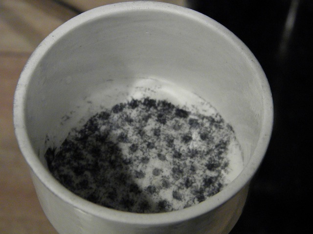

It did crystallize as the water was evaporated. When it was placed in ethanol, it did dissolve mostly, yielding a pale yellow solution.
I'm attaching pictures of the process.
I think perhaps the insoluble component is unreacted sodium bicarb.

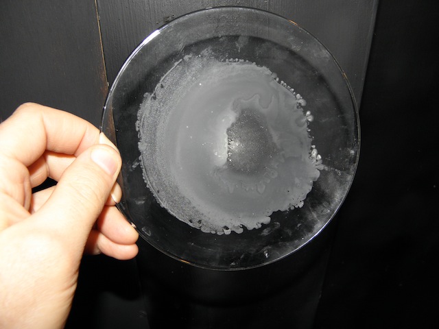

I allowed the ethanol to evaporate off, and was left with this.
It didn't crystallize. I think plante1999 was right.
Plante: If you could look it up, I would be very much appreciative.
Is it possible that what I observed was actually reduced titanium powder, that the ASA didn't react with the titanium at all, and that the yellow
color is just titanium impurity in ASA crystals?
