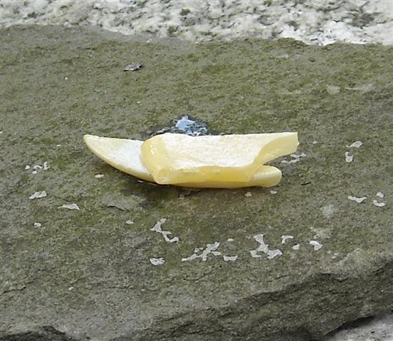

Phosphorus - Life & death of a 2.5g lump
OK, let's just drop any pretense that this thread is a real contribution other than to provide a few yucks.
I hear such hushed reverence for the demon phosphorus that I thought a few pictures might be useful to the uninitiated (and I count myself in that group)...
Pic 1 Time 0 m, 2.5 g WP wet with a little water.
Pic 2 Time 3 m, The WP has self-heated, fusing the two pieces.
Pic 3 Time 5 m, The WP was moved to a less heat absorbent surface after this pic, which shows very little activity so far.
Pic 4 Time 7 m, That was the trick....by this point the WP was bubbling and getting shiny as the surface liquified.
Pic 5 Time 8 m, WP simultaneously liquified and ignited with a ferocity approximating gasoline. The spread down the side of the log was extremely rapid, the viscosity must drop in a pretty drastic fashion. The spread was every bit as fast as a gasoline fire.
Impressive amount of fire from the small lump!
It seems that small factors can drastically alter the behavoir of pyrophoric WP. If the heat gets sucked away, it couldn't do much (at this scale).
(I've tried a half dozen times to insert the pictures in the correct order and they insist on coming up randomly. I'm too disgusted to try anymore. I think the sequence is obvious, but in case it isn't, the website prefers the sequence 8m, 7m, 0m, 3m, 5m).
t 8 m (Small).jpg - 87kB t 7 m (Small).jpg - 130kB t 0 (Small).jpg - 102kB t 3 m (Small).jpg - 106kB t 5 m (Small).jpg - 105kB
