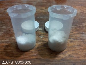

I made a small amount of 50/50 Entolite this morning by the co-precipitation method, which is briefly described in "Military Explosives" for producing Pentolite. Two separate solutions of approximately the same volume were made; 2.05g of ETN was dissolved in 10mL of acetone and 2.05g of TNT was also dissolved in 10mL of acetone. Fine, low bulk density, TNT which had precipitated after the methanol recrystallization solvent had mostly cooled during TNT purification was used. The two solutions were pipetted into about 150mL of vigorously stirred room temperature (was colder in my case) water at the same rate in a slow stream of drips. The Entolite precipitated immediately. Pentolite is undoubtedly superior to Entolite in most ways, but Entolite is still interesting and will most likely produce great base charges, although with less storage stability than Pentolite. According to the usual sources, Pentolite's sensitivity is between that of PETN and TNT and this should also be the case with Entolite (sensitivity between ETN and TNT).
Once it dries I am going to try a gram or two in a compound cap.
2.05g of ETN & 2.05g of TNT.jpg - 242kB ETN & TNT in Polypropylene Containers.jpg - 216kB Left 2.05g ETN in 10mL Acetone & Right 2.05g TNT in 10mL Acetone.jpg - 175kB Added Simultaneosly to Vigorously Stirred Water.jpg - 196kB Entolite Settling.jpg - 175kB Entolite Nearly Settled.jpg - 162kB Entolite in Filter.jpg - 201kB Damp Entolite.jpg - 162kB

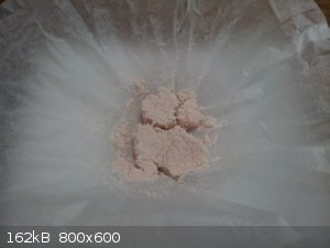

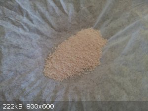

Here is a picture of the dry yield. It dries very quickly, which is great. The dry mass is 4.04g, which means that about 0.06g from what was started with was lost, which is very little. A bit was lost during filtering and transfers and a tiny amount would have been dissolved in the water.
Dry Entolite.jpg - 222kB

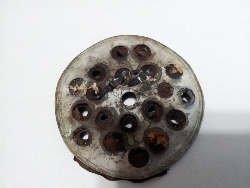

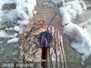

1.0g of Tetrolite Initiated; 7.6mm id Al, 0.30g LA (Unreinforced Configuration & ca. 6000psi Loading Pressure)
PHILOU, I think I prefer your name for this material (Tetrolite).
I am very impressed with this material. Just 1g of Tetrolite produces results which are very comparable to the best results I have obtained with 2g of picric acid, as can be seen by viewing the witness plate shots below.
Entolite Cap In Place.jpg - 280kB
The hole on the right, in the witness plate shots, is from this test.
Witness Plate Top View.jpg - 154kB Witness Plate Bottom View.jpg - 179kB

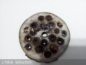

Not quite sure which hole is the one of most recent interest!
How about we take up a collection to buy this man a supply of nice, uniform (single use) witness plates? Least we could do in return for for the interesting posts...
Also: Is it possible the repeated shocks by many tests to that steel disc could be work hardening it or otherwise changing the target's characteristics meaningfully?

I always try to put the last test hole about the middle of the picture, vertically, and to the far right. Also the most recent hole has no rust. I think you are right about the explosive hardening. I wondered about that back when I was doing the DDNP tests, but was unsure of how significant it really was and wanted to keep using the same piece for comparisons. Yeah, one way or another it is just about time for a new witness plate. I think I have two or three more of those same ones (undamaged) if I can find them.

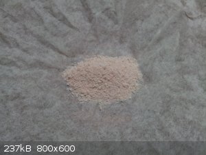

BTW, I jumped the gun a little on proclaiming the Tetrolite dry. I weighed it this morning and in the last 14-16 hours the weight of what is left dropped an amount that would translate into the entire sample losing another 0.10g. It was actually obvious during the processing that a fair amount of small particles were lost, stuck to the reaction vessel, etc. They could have been recovered, but it would have been more bother. Losses are usually greater when handling smaller amounts of materials.
Here is a picture of what is left of the Tetrolite (slightly less than 3g). It should be very close to the equilibrium moisture content now. Notice how it has taken on a lighter color as well.
Tetrolite Dry.jpg - 237kB

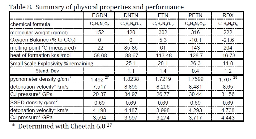

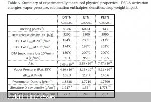

Here is a table of experimentally determined physical properties for ETN and PETN taken from the article, "Characterization and Analysis of Tetranitrate Esters". Dh50 is the height at which there is a 50% probability of explosion. ETN is only slightly more sensitive to impact than PETN, however, it really falls short of PETN in terms of heat release.
ETN & PETN Experimentally Determined Physical Properties.jpg - 177kB

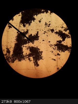

I'm curious to hear what you see under the microscope. I have coprecipitated mixtures before and the crystals formed were about 5 µm - not particularly homogeneous that is. That was by pouring a hot concentrated solution of potassium chlorate and potassium ferricyanide into cold ethanol. The particle size could probably be reduced further by spraying a mist of the solution into the ethanol and possibly using a more dilute solution, but still.

I will have a look under the microscope, but I am not convinced that it is imperative that mixing be that fine. I have attached a jpg image of a snip-it on Pentolite production from "Military Explosives".

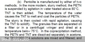

Pentolite Production Snip-it, from Military Explosives.jpg - 94kB
Also from "Military Explosives", "The minimum detonating charges of lead azide and mercury fulminate required for pentolite are intermediate between those for PETN and TNT and are very close to that of tetryl."

Dornier 335A, I imagine that degree of mixing can be very important, but I imagine that it becomes less and less important as you get finer and finer. It would depend on intended use as well how important it was. I am not exactly sure how to quantify it though. I took a microscope picture at 100X magnification, but with a bottom light I had to flatten the sample out with the back of a spoon so the light could get through and make it visible. The sample was on a piece of clear plastic also (I have glass slides somewhere). I think you can get an idea of how fine the crystals are by looking at it, but it would be better if a scale was there.
According to "Military Explosives", 87% TNT & 13% PETN form a eutectic with a melting point of 76.7C. So 50/50 pentolite when cast has about 42.5% PETN and about 57.5% of the eutectic mixture. So in this case about 15% of the PETN dissolves.
Pentolite Eutectic Mixture.jpg - 84kB Tetrolite at 100X.jpg - 273kB

I did a little reading on eutectics. Hopefully this explanation is more or less correct. I should have said the composition of what solidifies last, and at the eutectic temperature, from the melt contains about 15% of the PETN. More than 15% of the PETN may dissolve and be part of the melt above the eutectic temperature, but any PETN dissolved above that amount crystallizes out before the temperature drops to the eutectic temperature. Once the temperature has dropped to the eutectic temperature the temperature and composition of the melt, and consequently the composition of the solid being formed, does not change as the melt solidifies. Once the eutectic mixture has completely solidified the temperature will begin to drop again as the solid cools.
Also, the physical properties table posted several posts up had DSC heat release values displayed. The DSC kinetics values found in the study and displayed in the table were there mostly to make stability comparisons. They found PETN to be more thermally stable; for details the study can be easily downloaded from this forum or elsewhere online. Here is a table which contains more of the performance related information, from the same article. The values were determined using a computer software called Cheetah.
ENT & PETN Physical and Performance Properties.jpg - 185kB

thickness
This is the hole from one gram tetrolyte? It is labeled correctly? What is the thickness of steel? I do not see written anywhere. 3 mm or 1/8 inch? Thank you, LL .....:cool:
Witness Plate Top.jpg - 197kB

Thickness of witness plate is only about 2.6mm; I have been using the same plate for so long that I didn't think to give specifics again. Yes, that is the correct hole. It is the only one without a layer of rust covering the exposed steel surfaces so it is easy to tell. The exposed steel accumulates rust very quickly. The loading pressure could have been much higher for the tetrolite base charge which likely would have significantly improved performance. All the other holes were made with picric acid base charges, except one shot made with an improperly primed TNT base charge which did not perforate the plate.

That witness plate has really been subject to an extensive amount of sustainable exploitation :D
Bet you can squeeze in at least one more test with that perforated plate though :)
