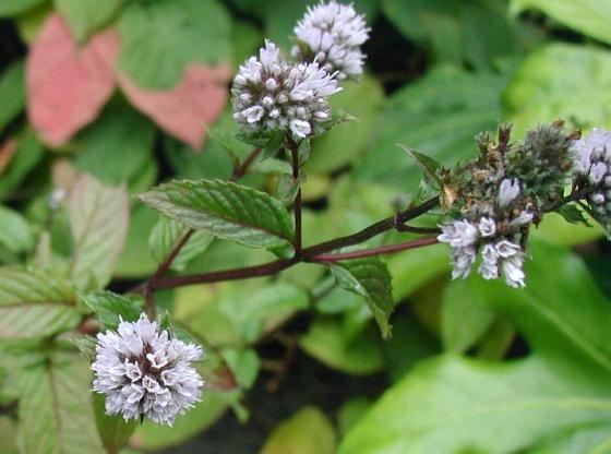

Radiation was used long ago in industry to produce genetically modified plants. Two plants are alive today that were accidentally made via radiation - The Rio star grapefruit and the Mentha Piperita peppermint. The rio star grapefruit is more red than any other grapefruit, and Mentha Piperita is resistant to fungus and is what is used to produce most modern mint oil. Godzilla was created via radiation ;). Just like Nick totopolas (a.k.a. the worm guy) noticed a 17% increase in the size of the worms at Chernobyl, a nuclear enthusiast was able to created almond size peanuts via radiation. The peanut was the NC4x peanut.
[Edited on 6-30-2013 by Solomon]

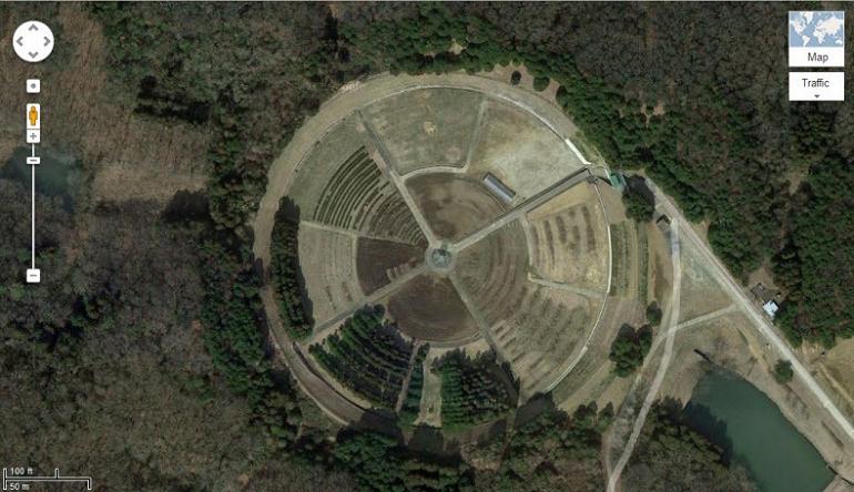

The old atomic gardens were a column of cobalt 60 (produced by neutron bombardment of cobalt 59) surrounded by circles and circles of plants. This produced a radiation gradient. The plants at the center usually died, the plants in the middle became botany's form of the radium girls, and the plants at the outside often had useful mutations.
