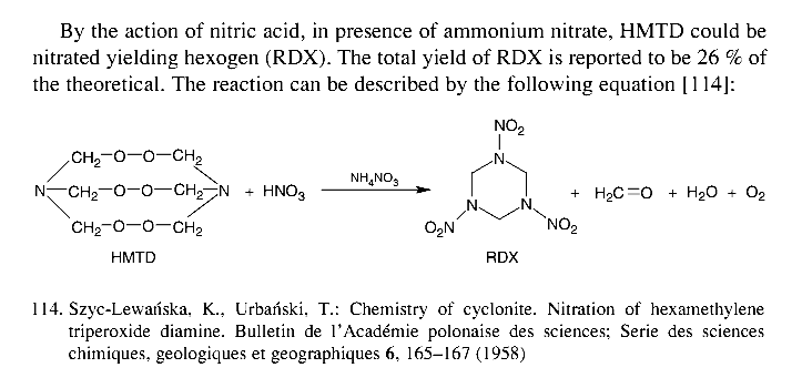

I like surprising quirky procedures. I think this is interesting.
RDX by HMTD.gif - 14kB

Does 68% HNO3 suffice for the above reaction ?

I'd doubt it, Motherlode ─ I'd guess >90%!
Do you have a lot of that old HMTD lying around? :D

Yeah it's fermenting in my wine cellar.
Well if one has to use WFNA ..... Why bother with the shitty >30% yield ?
Not to mention the need for me to wear a diaper when handling organic peroxides !!
