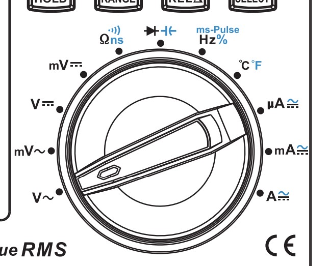

I have now had time to view the details of UT8804.
Below is a snip of the selection switch for the UT8804:
rms04Screenshot 2024-04-07 072929.jpg - 75kB
I think the symbol next to all the current ranges is intended to indicate mixed AC and DC signals which are measured true rms ie calculating the rms from a set of samples of the signal DC coupled. I think some people are calling this "AC + DC" mode.
On the voltage range there or two different symbols one usually indicates AC and the other DC. I would expect the AC range to be AC coupled and measures the RMS of the AC component. Does the DC position indicate average or rms ?
The UT8803 only uses the mixed symbol that the current ranges of the UT8804 uses. Meaning it only measures true rms DC coupled
I suspect the tick in AC+DC column for the 04 refers to the two voltage ranges, AC range and DC range that the 03 does not have.
I am very interested in these meters as they both have a usb interface. I expect to purchase the 03. If I want to measure the AC component of a mixed AC and DC voltage l I will add a series capacitor to one of the test leads.

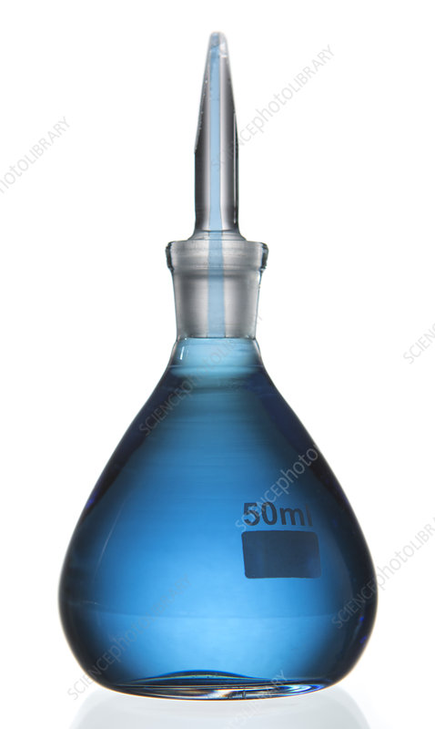

A question of my own;
What is the purpose of the ground taper at the top of a Gay-Lussac style pycnometer?
C0363549-Pycnometer_and_blue_liquid.jpg - 39kB
Perhaps this from a Thomas Scientific brand
"Gay-Lussac With capillary glass stopper ground to flat-sided point for take-off of overflow 10 mL"
Posts: 3930
[*] posted on 7-6-2024 at 07:51
I received a 10ml pycnometer this morning, (it's cute)
so now I can partially answer my own question:
the ground taper and top seem to be to indicate the presence of liquid
(which makes the frosted areas more transparent, less opaque rough whiteness)
rather than to directly assist in the removal of liquid.

It is to minimize error. The amount of liquid that gets into the ground glass joint is predictable and the fitting is not loose. This way you can measure the volume accurately. See, for example, All about pycnometers and accurate ABV and Moore, R. (1973). A Pycnometer of Improved Design. Journal of the Minnesota Academy of Science, Vol. 39 No.1, 22-23.
