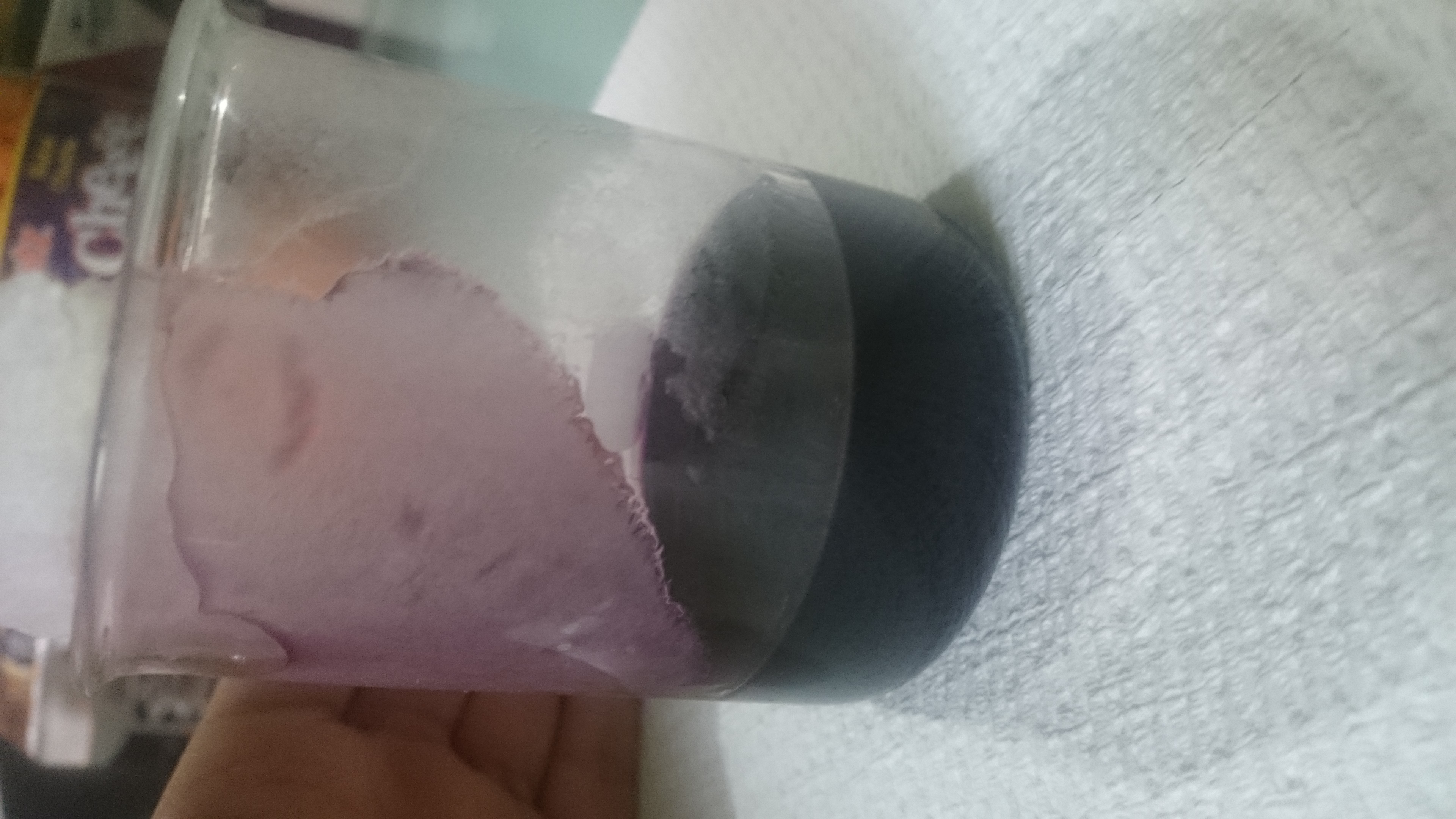

Unknown purple solution
Today I was able to get a purple colored solution after mixing two different solutions.
I had this chunk of white solid(Either sodium salicylate or salicylic acid) from the a long time ago when I extracted aspirin from pills by acidifying the solution and basifying it back and forth. I am not sure what I ended up with but it was not soluble in water. I tried dissolving it but wouldnt work so I added some isopropyl alcohol to it to see if it helped. I saw a decrease in the amount of crystals on the bottom of the beaker but it didnt fully dissolve..
At the same time I had a beaker on the hotplate that pretty much limestone dissolving in HCl. Most of the HCl was consumed so I was heating it up to dissolve the last bit of the solid limestone chunk in it. This solution contained mostly calcium with small amounts of magnesium and iron(III) with other trace elements. I decided to pour some of this into my beaker with the alcohol and water mixture and it turned dark purple as if it was suddenly a permanganate solution.
Any ideas as to what the hell this could be? I don't know of any substance that has the same color as permanganates. Any insight would be appreciated.

[*] posted on 12-11-2016 at 11:42
Fe+3 ions from your limestone solution form purple (or other colors depending on the nature of the phenol) complexes with phenols (which salicylates are).
Posts: 4725
[*] posted on 12-11-2016 at 11:50
Yep, that is most definitely the iron(III) salicylate complex. It works very well as a qualitative test since the color is so rich.

[*] posted on 12-11-2016 at 12:46
Oh thats interesting especially for me as I have no background in organic chem. Thanks!
