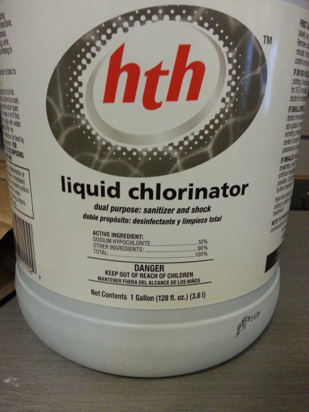

I am looking to produce Hydrazine Sulfate in order to make a copper mirror. I have all the needed reagents, aside from the 10% NaOCl, to follow
nurdrages excellent video here: http://www.youtube.com/watch?v=UB7vwIFCnR0
Well today in a quick stop at ace hardware I came across this gallon of Liquid Chlorinator for $4, stated to be 10% NaOCl. Being a pool product, I
thought surely there are likely some impurities aside from water. When looking through the MSDS information sheets I could find, I typically found
NaOCl (Duh!), NaCl, and NaOH as the other listed components. Would it be likely that any of these might interfere with the process to any large
extent? I am not worried about the NaCl, as NaOCl eventually decomposes into NaCl anyways.
The MSDS can be found here.
Here is a picture of the incredible bargain $4.00 Gallon of Sodium Hypochlorite.

If the MSDS is accurate, it should work fine. It's always good to try and match the concentrations used if you're trying to reproduce someone's work,
especially for a synthesis like this where side reactions are a potentially serious problem for your yield.
That said, this is not 'an incredible bargain', just a normal price. You can probably do slightly better on a cents-per-mole basis by buying 8.25%
bleach from Wal-Mart.

surely do not believe Nurdrage had any negative intentions. I did think that $4 a gallon was quite a good deal, as its quite a large supply that will
hopefully last me a very long time, given that I can keep it cold to prevent decomposition of the NaOCl.
