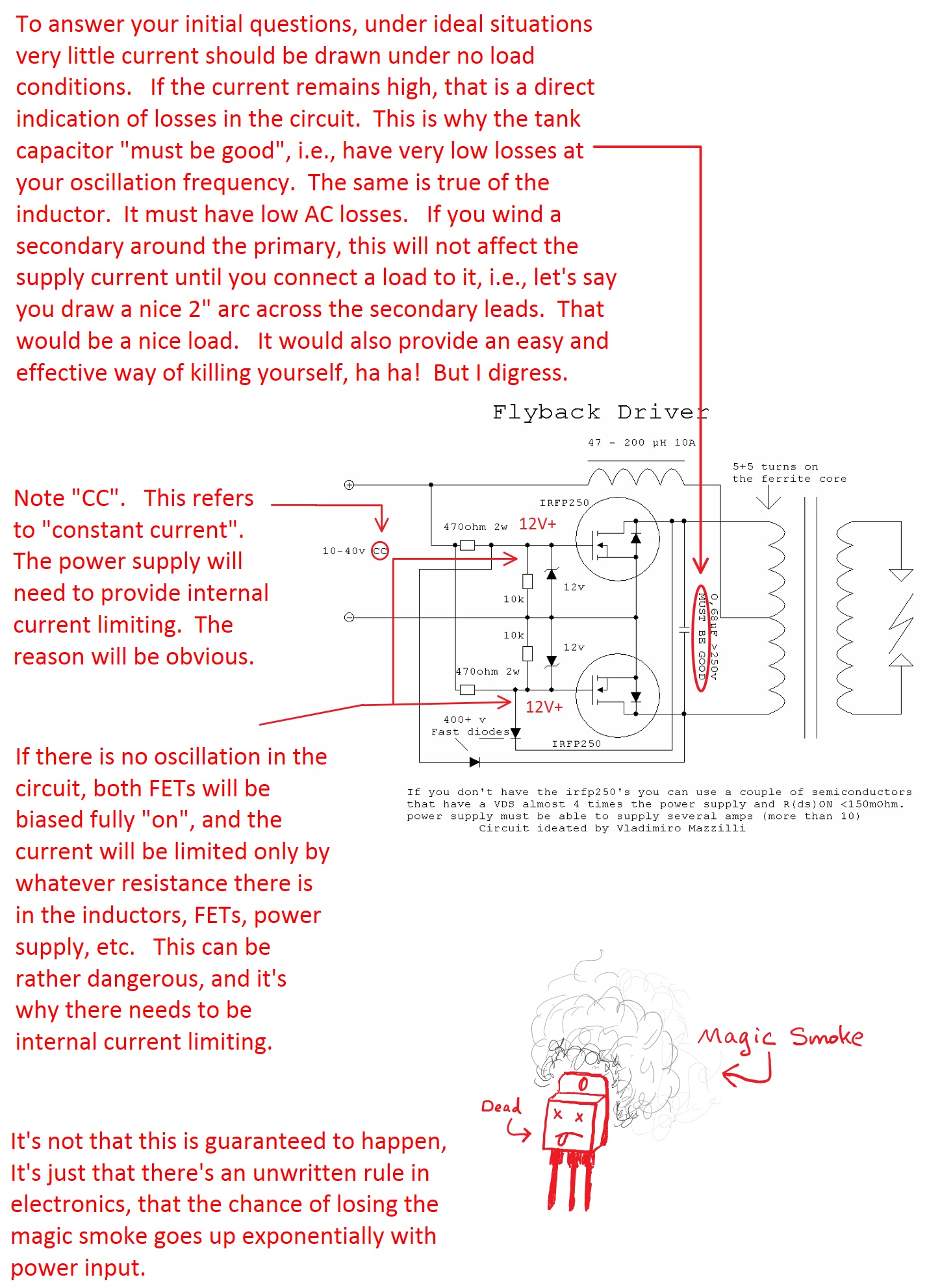

WGTR
Posts: 972
Registered: 29-9-2013
Location: Online
Mood: Outline
[*] posted on 30-6-2014 at 20:10
I don't plan on posing this way normally, but I'm playing with my new surface pro.
page1.jpg - 682kB
page2.jpg - 503kB
If I have some time I'll throw this together and see if it works... or someone else "knowledgeable in the art" can try it.

WGTR
Posts: 972
Location: Online
Mood: Outline
[*] posted on 7-7-2014 at 21:12
To both agree with IRC and clarify a few things from a different viewpoint, here goes.
For the purpose of argument for now, we can assume that full power supply voltage is applied to the circuit instantaneously(i.e., with an infinitely fast rise-time). The RC filter network composed of the 470 ohm resistor + the MOS1/2 gate capacitance has a time constant, which causes a short delay in the gate to source voltage (Vgs) rise. This time constant is significant only up to the gate threshold voltage (Vth), where MOS1/2 begins to conduct. Up until this threshold is reached, drain to source current (Ids) is zero, and the voltage rise at the output of the 130uH inductor is instantaneous. Once Vth is reached, the rate of rise in Vgs is limited by the rise in Vds (drain to source voltage), which is in turn limited by the 130uH inductor. Assuming a well-coupled transformer, T1 inductance is zero, since the flux is cancelled by both MOSFETs conducting simultaneously. In a perfect world, with both halves of the circuit being perfectly matched and symmetrical, the MOSFETs will then go into thermonuclear meltdown. Since we don't live in a perfect world (whew!), there is sufficient thermal noise, or there is some asymmetry somewhere that causes one half of the circuit to conduct before the other. At this point, due to D1, and D2, and T1, there is positive feedback that drives the circuit into instability (oscillation).
The 130uH inductor is needed, not so much for power supply filtering, but to limit the Vds rise-time on start-up. Without it full voltage will get applied to both MOSFETs (which are already "ON"), with the MOSFETs acting as the primary current-limiting (and power dissipating) devices. An improvement to this circuit would be to add a resistance from the output of the 130uH inductor to ground, to improve start-up performance. This resistance would counteract the negative effects of the parasitic capacitance in the inductor, which can cause voltage to rise too quickly on the MOSFETs on start-up. It's a minor improvement.
I do think that if the supply voltage is brought up very slowly, there will be a region of operation where the circuit will consume power without oscillating. This would be related to the limited voltage swing at the gate at certain supply voltages.
