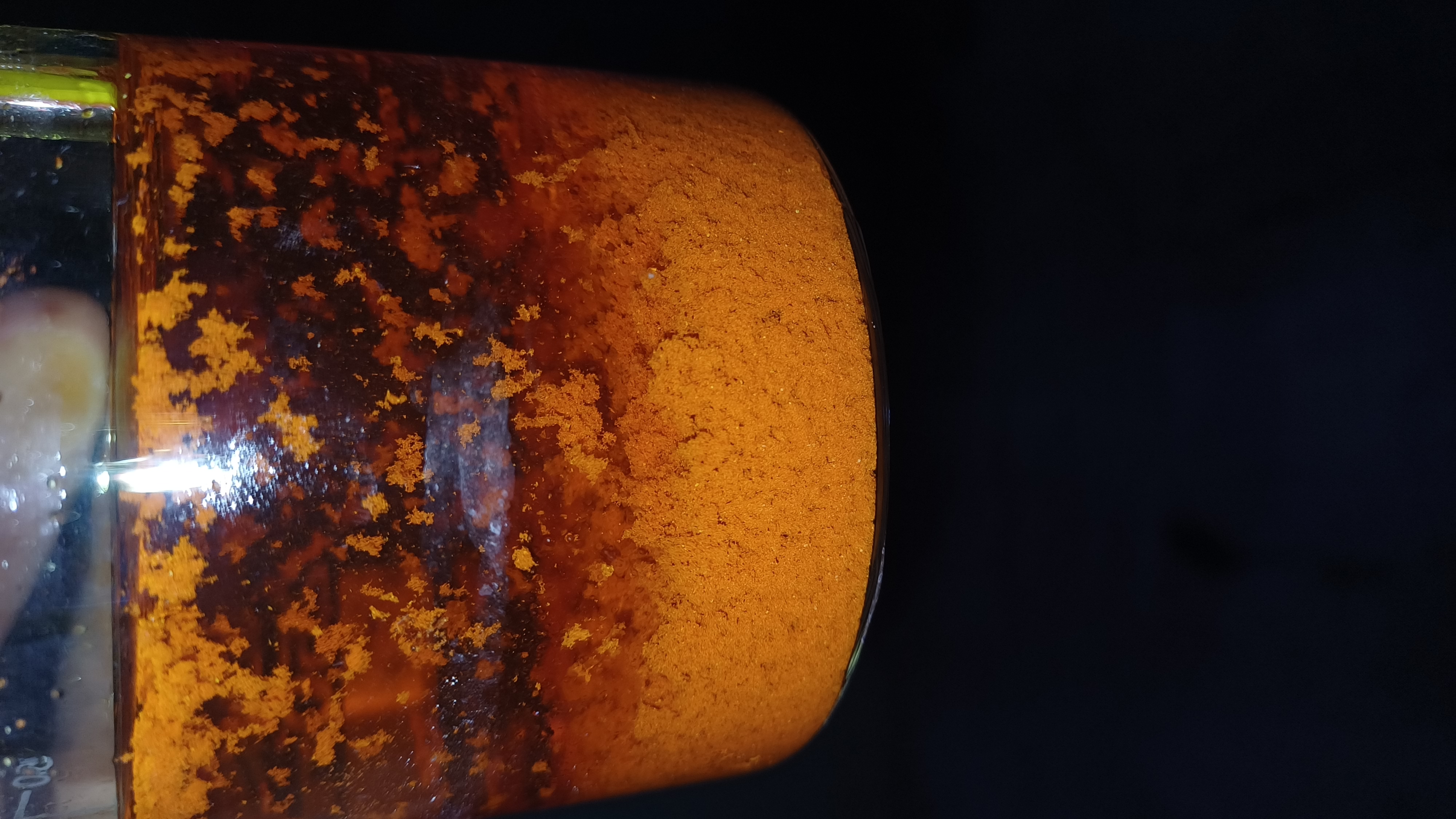

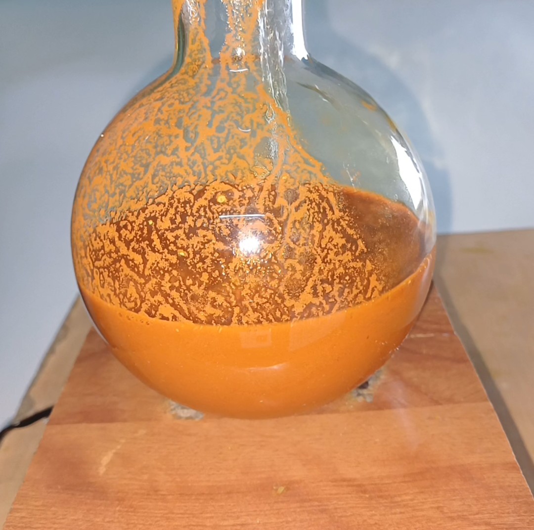

Hi guys,
Since many days I'm trying to make DDNP but it fails again and again I don't know why...
I took 3g Picric acid and dissolved it in 30ml of hot boiling water.
Then I mixed 2.5g of NaOH with 2.5g sulphur with few drops of water.
And then I added the sodium sulfide mixture to picric acid solution.
After that I filtered the picramic acid.
Everything was fine till i added Picramic acid to hot water.
But after adding 2-3 mls of concentrated sulphuric acid it's colour changed to reddish-orange not brown.
Then I cool down the reddish-orange solution and added 80ml of sodium nitrite solution to it.
And nothing changed!!!
Please guide...

How sure are you that you have picramic acid and not sodium picrate?
I'm not sure why it's giving sodium picramate.
Although it was my 3rd attempt to make DDNP and this was 3rd time I got this red-orange precipitate..
I'm taking guide from "1969 us army improvised munitions handbook".
I still have that precipitate.
What should I do now?

Dont you have to neutralize the picric acid with NaOH to sodium picrate before processing with the reduction with the sulfide?
That should give you the sodium picramate, that you reacidify to picramic acid before the diazotization with the nitrite.
Am pretty sure that reducing the picric acid will yield H2S gas and sodium picrate.

You are correct, that is why I think Cubane538 has sodium picrate. From what is written sodium sulfide has been added directly to picric acid. I would also add that the method used to generate sodium sulfide is a little unreliable and is likely that it contains a mixture of reactants, products and some polysulfide compounds. In my opinion a better approach would be to convert the picric acid to sodium picrate using sodium hydroxide. Prepare sodium sulfide by another method or purify it first. Once you have pure sodium sulfide use it to reduce the sodium picrate to sodium picramate.

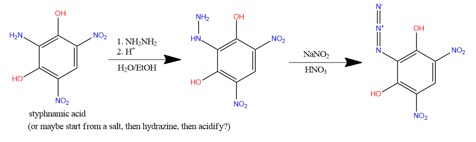

Azido analogue of DDNR
2-azido-4,6-dinitroresorcinol. Has anyone previously thought of making this compound?
Here's a synthesis pathway that I came up with:
Zrzut ekranu 2025-03-31 191320.png - 29kB
