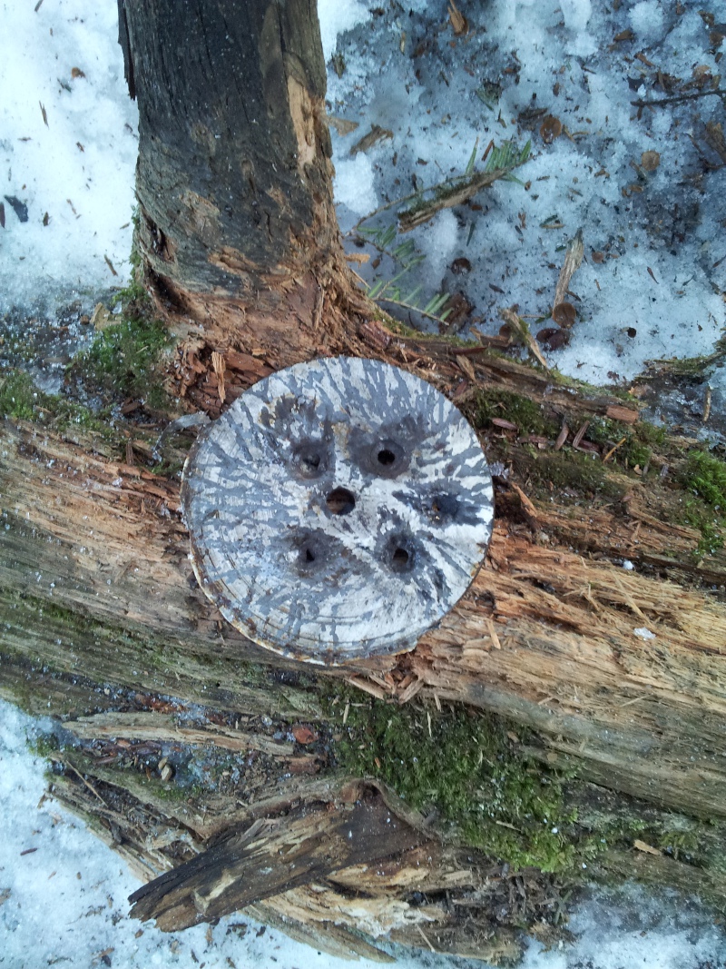

2g of Picric Acid Initiated in 7.6mm id Al Tubing by 0.40g of Hand Pressed DDNP Using Steel Reinforcing Cap
Another test was performed. Everything was done the same as the last test except that 0.40g of DDNP was used. All materials used were identical to the last test. As you can see from the pictures going from 0.50g to 0.40g of DDNP has resulted in severely diminished output from the 2g picric acid base charge even though it was completely detonated. The hole in the witness plate, for this test, looks very close to the holes produced in the tests where 1.5g of picric acid and more DDNP was used.
I am still not happy with how well the reinforcing cap is locked into place. I like Rosco's idea of cutting a few threads in the upper section of the wooden locking bushing and putting some adhesive in those threads before pressing the bushing into place. This method would result in a much more secure reinforcing cap.
In this configuration 0.40g of DDNP will detonate my picric acid (purity over 98% by melting point), but is not driving it hard enough resulting in diminished base charge output.
I have included a few pictures of the test. The hole on the right, in the witness plate shots, is from this test.
0.40g DDNP.jpg - 360kB Cap In Place.jpg - 502kB Top View Post Detonation.jpg - 520kB
Bottom View Post Detonation.jpg - 486kB Top View.jpg - 468kB Bottom View.jpg - 426kB
This cap was loaded with the same materials as was used for the last test. The only difference between this test and the last was that a slightly longer casing was used to accommodate a slightly longer wooden bushing and that bushing had annular adhesive grooves ground into its upper section. I forgot to take a picture of the bushing but have included a software sketch of an idealized representation. The bushing was 5/16" in diameter and there were 5 or 6 annular rings which were about 0.5-1mm deep, about 1mm wide and spaced about 1 mm apart. A 1/8" hole was drilled through from end to end, as before, to accept the core burning fuse.
Five minute epoxy was used as the adhesive. It was smeared on the bushing in and over the grooves and then the bushing was pressed in on top of the steel reinforcing cap. The epoxy was only given 1 hour at room temperature to cure which is not enough time to reach full strength (16 hours for full strength stated on several data sheets). I believe most of the strength was obtained from the 1 hour curing time however.
The test was a success. The 0.40g of DDNP detonated the 2g of picric acid and produced results very similar to the other tests were more DDNP was used. The hole was well formed and of the same diameter as the other successful tests.
The scab on the bottom side of the witness plate was smaller and the hole was the most well formed of all the tests. I believe this was because I accidently pressed the bottom gram or so of picric acid a bit harder than usual which would have resulted in higher velocity and higher pressure from the detonation.
I wonder if I could get the same kind of results using only 0.30g of DDNP if enough confinement was used.
Reinforcing Bushing With Adhesive Grooves.jpg - 25kB Cap In Position On Witness Plate.jpg - 324kB Post Detonation.jpg - 374kB
Witness Plate Side View.jpg - 429kB Witness Plate Top View.jpg - 338kB Witness Plate Bottom View.jpg - 368kB

2g of Picric Acid Initiated in 7.6mm id Al Tubing by 0.30g of Hand Pressed DDNP in Steel Reinforcing Cap
The test was performed with the same materials and in the same way as the last test. The picric acid was not driven hard enough by the 0.30g of DDNP even with very strong confinement. Picric acid needs to be given a really hard kick to produce full output power. There was every indication of a complete detonation, complete with cloud of black smoke, but the damage to the steel plate was much less than when the picric acid was overdriven properly. There was no clean hole blown through the steel witness plate, but there was a big dent on the top side and a scab blown off the bottom side as well as cracks which went all the way through the plate. The dent/scab on the right in the witness plate photos is from this test.
The next test will probably involve a little lead azide or silver azide to get the DDNP off to a good start.
Cap on Witness Plate.jpg - 519kB Top View.jpg - 353kB Bottom View.jpg - 354kB
[Edited on 22-4-2014 by Hennig Brand]
