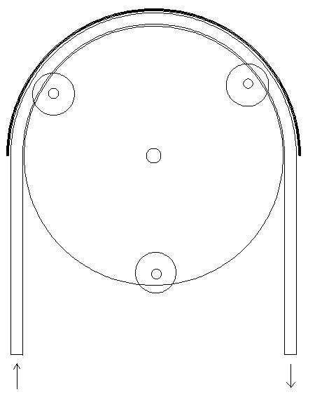

Homemade dosage pump
I've been thinking about an easy way of building my own dosage pump. The ground idea is shown in the pic below.
It's a center wheel with three or four smaller wheels, maybee spring loaded, pushing a hose against an outer rail. When the center wheel turns the liquid in the hose is squeezed thru the hose in the rotation direction.
The weel could be turned by a low gered electric motor like a servo. The motor can be controlled by a timer like Swede's.
If you know the inner area of the hose and the turning speed of the motor, it's easy to calculate the time and interval for a specific amount of liquid to be trasported.
The construction should be quite simple. My biggest problem is to get a well working hose. It has to be very flexible and withstand HCl. I think silicone should work, but I haven't been able to test it. Does anyone have a suggestion.

@Gamel. You are building a peristaltic pump. I think most of the flexible tubing that are suitable for these types of pumps will withstand HCl. The 12% stuff is easy to handly in just about any plastic. Neoprene and Marprene (trade mark of Watson Marlow (pump makers)) I have seen used with acids.
If you look over in the "Reagents and Apparartaus" thread there is a thread on Waterpumps.

Thank's dann2! It's allways nice to know what you are trying to build:D
I like the peristaltic type (allmost invented it ;)). It looks like they use teflon or silikone hoses most.
I'm sure I'll use it with uther chemicals, so I think teflon is the best choise then.
What do you think about using a needle bearing with some of the needles removed and some type of clamp over it. It would make a very simple construction I think.

Gamal, I don't want to discourage ANY DIY project, but be aware that you can pick up used peristaltic pumps for next to nothing off eBay. The work involved in making one from scratch would not be trivial! :)
If you want to see what's out there, search for peristaltic pumps or "Masterflex" which is a series of pumps and heads offered by Cole-Palmer. As for tubing, there are dozens of formulations and sizes, many of which will do HCl with ease, but PTFE is a different beast. Besides being expensive, PTFE tubing has little elasticity and has a limited lifetime and efficiency in a peristaltic head.
Here is a page with technical resources, including tubing compatibility:
http://www.grayledge.com/MasterflexBarnantIPPumps.html
Another plastics vs. chemical compatibility guide:
http://www.innocalsolutions.com/TechInfo/ChemComp.asp
Tygon is a good choice. Yet another tubing URL:
http://uscorp.thomasnet.com/category/tubing-hose-saint-gobai...
We also tend to forget about good old gravity as a means to deliver. Given some head pressure from a vessel higher up, all you need to do is turn a suitable solenoid valve on and off.

It's like a ball bearing but with small rolls instead of balls.
If I can pick some of them out and clamp the hose between it and a rail of some type, I only have to turn the bearing to pump the fluid.
Thanks Swede for the links! I think I'll try PVC at first. However I have a feeling it will harden after some use.

I would call the 'needle bearing' a roller bearing. Descriptions and names change from place to place.
You would need a very large roller bearing for the 'rollers' to be sensible size for making a Peristaltic pump.
If you are going to make a Peristaltic pump you will need a geared motor that turnes the output shaft fairly slow. The wiper motor of a car has a suitable motor + gearbox. You could speed controll it too with an SCR chopper circuit or a variable voltage supply (say approx 5 to 13 volts DC) or even a big wattage resistor.
PVC varies greatly in how stiff or rigid it is depending on how much plasticizer has been added to the melt as the tube is being made. Stiff tubing in a Peristaltic pump will NOT work.
Try Googling 'Homemade Peristaltic pump'.
