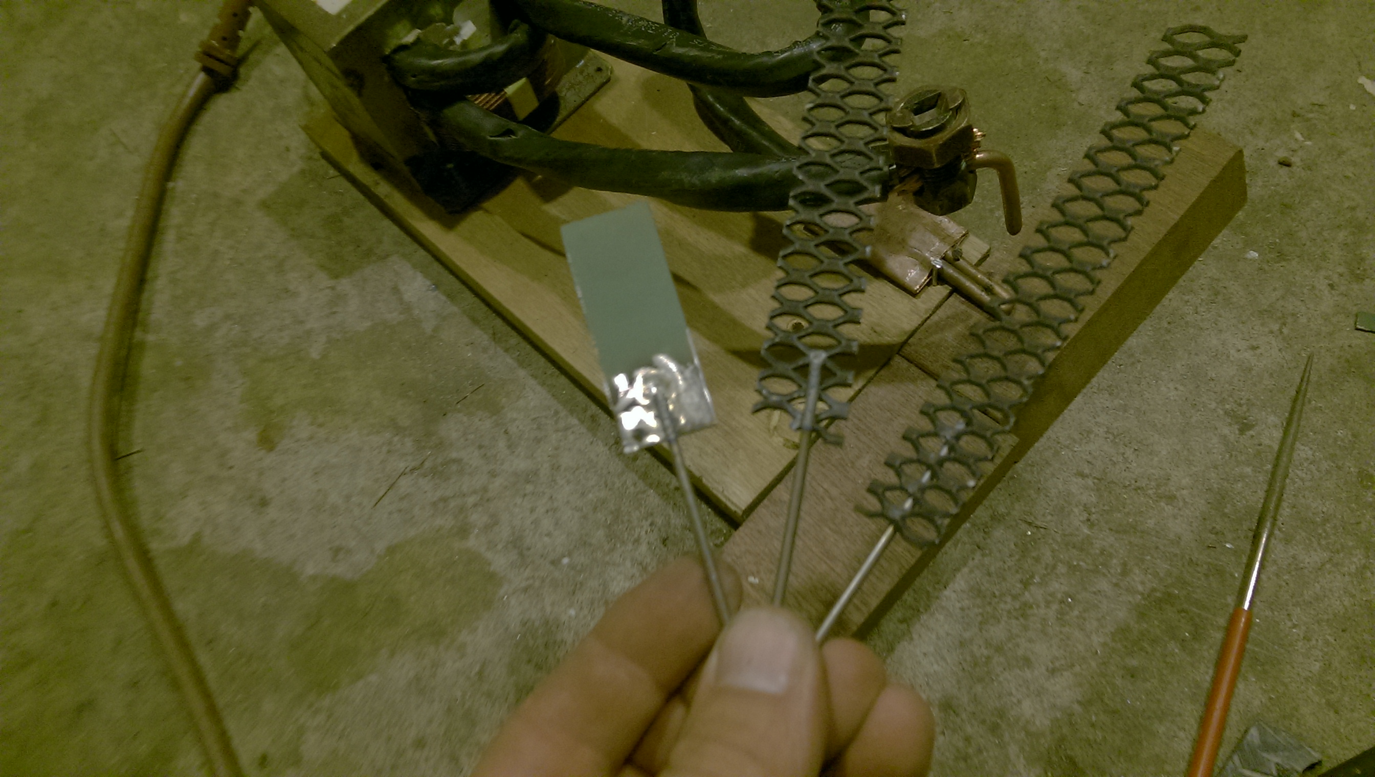

nothing really new I guess, but I made a crappy spot welder and tacked some titanium wire to both mesh MMO and plain sheet, as a resistant support for the working plates. I haven't even finished the spot welder yet, used a rubber mallet to hold down the floating electrode and moderated power with turning on and off the power strip it was plugged into. super ghetto I know, but I just wanted to see if it could be done on an "I don't have all the time in the world" mock up, with improvements to come. I have a variac I'm not using yet, as well as all the materials to make a nice one with variable power. but for now here are some pics
IMAG1338.jpg - 869kB IMAG1332.jpg - 883kB IMAG1333.jpg - 1000kB IMAG1335.jpg - 832kB IMAG1337.jpg - 1.1MB
1)you can see the size wire I used for the 1-1/2 wrap
2) front of the transformer
3) tacks on plate and two mesh MMO pieces
4) close up of the spots
5) another close up
they seem physically OK, not super strong, but short of TRYING to tear them off the Ti wire wasn't going any where. survived 3 increasing tweaks with out snapping. how they perform chemically is another thing. I only flattened out an edge on one of the wires, which mean the other two have less surface area meeting, which was also really hot in standard atmosphere ( no O2/N2 shield of any kind used ) so it may make a nifty lill cave for gas generation from weakened titanium, may be fine.
on my first try with two wire pieces, it got hot, then blew out. after cooling it looked like the heart of the two wires shot out through two volcanic craters ( tiny ones, but half the depth of the wire)
fun learning experience, now it's time to make a sweet lever arm to reliably spotweld. .... and figure out how to bend the Ti plate at a 90'<, every time I do it snaps just prior to 90'. but I wanted to make support strips similar to what is seen in a pool electrode stack. because I am actually trying to use this for my pool.
