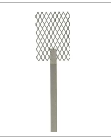

Are you sure plated platinum isn't shiny? This guy made some and they look pretty shiny;https://www.youtube.com/watch?v=TSzgvP0OW-Q. (I still think the Ebay ones are fake though.)
yea and they didnt work so he bought commercial ones.
He didnt make them properly and I know that because I spent years trying to make electrodes and now know how proper anodes behave and should look like. If you want real electrodes go to this link
https://www.aliexpress.com/item/1005002682948243.html
Pt is overrated anyway and Ir-Ta MMO can do everything Pt can do except perchlorates but this is fixed by doping with Pb.
also below picture of genuine Pt electrode which is shown as having a clear divide between the Ti and Pt layer.
pt1.png - 63kB
