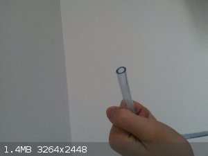

What is this thing made of?
Hello!
just 2 simple questions:
-what is this thing made of¿
-will it resist acetone?
1434910492565464560274.jpg - 1.4MB1434910534135-828360186.jpg - 1.4MB1434910577486793585794.jpg - 1.4MB

Your tubing says CellFast on it, doing a quick internet search found an eBay auction for CellFast tubing although in the details it only says that it is polyvinyl (chloride, acetate, etc is unknown but since it holds up to water it could not be the acetate, probably just chloride) and that it is food safe (which is what the little icon showing the fork reveals on the tubing itself). If it is PVC it is unfortunately not resistant to acetone. Also, am I reading it correctly that the tubing was manufactured 3/15/83?

Bromic is likely correct it is PVC tubing. With organic solvents and heat it will get hard, brittle, then develops cracks spewing (in your case) hot acetone vapors out.

[*] posted on 21-6-2015 at 15:13
http://www.ebay.com/itm/6-4mm-diameter-Translucent-Rubber-Tu...
Top Quality, flexible and durable rubber tubes. Those tubes are produced by renowned producer Cellfast, and they have safety and food quality certificates as well as are CE marked, meeting all UE requirements and strict quality controls.
The tempereature range is from -10 up to +60 degrees Celsius
Polyvinyl Mulitipurpose, strong and flexible, easy to cut, clear transparent tubes designed for compressed air, hydroponics - water, inks, acids, chemicals, oils, paints, glues, etc.
Looks like this is the company product page:
http://www.cellfast.co.uk/products/415-technical-hoses
[Edited on 6/21/2015 by BromicAcid]
