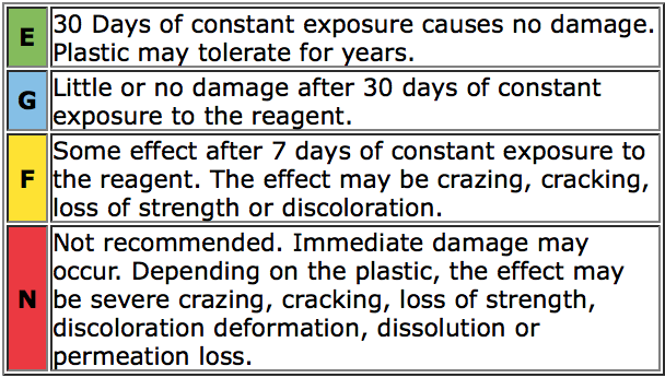

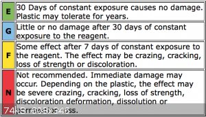

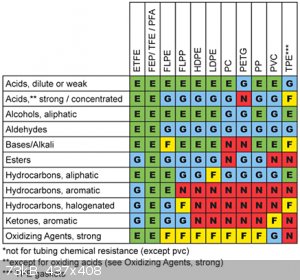

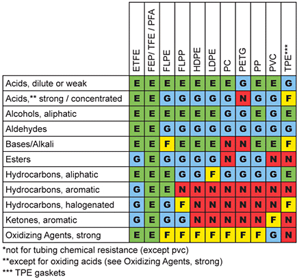

Here is a more general guide to plastic chemical resistance:
Chemical_Reference_Summary-small.gif - 73kBScreen Shot 2015-01-31 at 6.50.18 PM.png - 74kB
