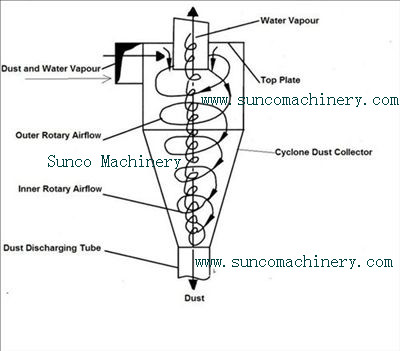

@Magpie i do like the cyclone idea but im a tad confused as to its operation.
Is the spinner supposed to rotate solely by the pressure of the gases being pushed through or would it have to be electrically driven.
Posts: 6455
[*] posted on 11-10-2017 at 22:32
A cyclone has no moving parts. It spins the gas into a vortex. Denser material is flung out to the edge and funnels to the bottom. Light gas leaves at the centre top so that gas flow is maintained.

[*] posted on 13-10-2017 at 11:42
The cyclone separator would appear to be a lot easier to engineer than i had originally thought.
One problem though: from what ive read on them cyclone separators are only capable of separating particulates or liquid droplets from a gas flow, they cannot separate 2 gasses at all.
This means that we would still need to condense the P4.
A water jacket around the cyclone housing would be the minimum required to accomplish this. Achievable but it makes other methods look more appealing.

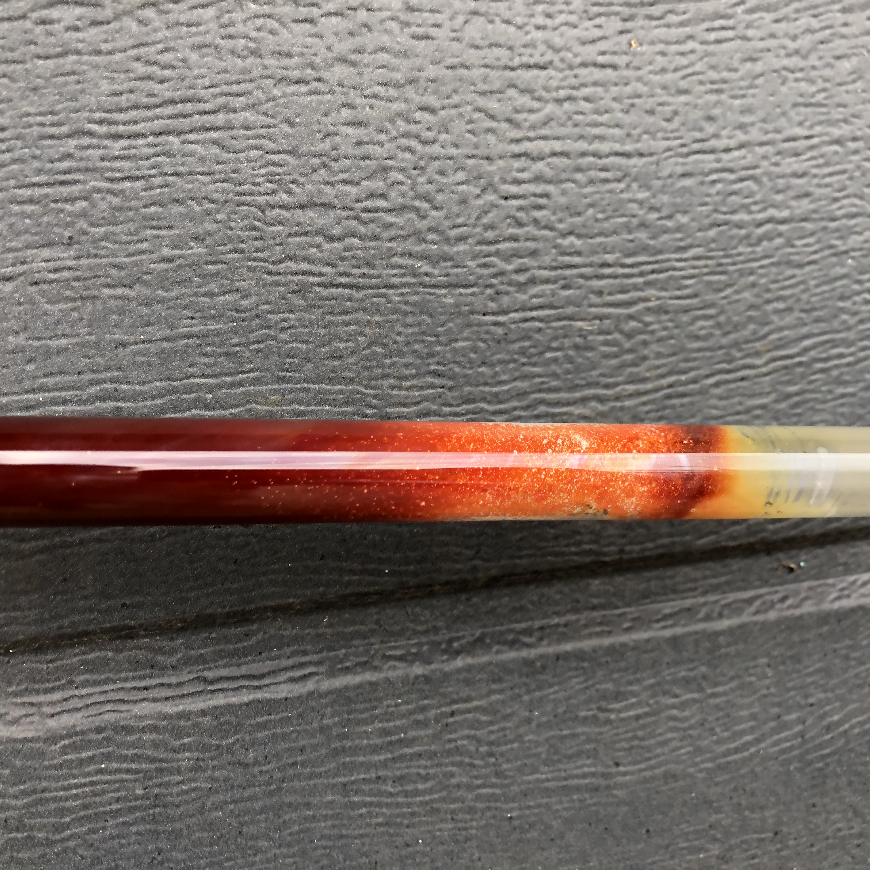

I haven’t seen anyone try this in this thread yet so I thought I’d give it a go.
I just did a little experiment with P2O5 and some dark Al powder. I wanted to see it the Al reduced the oxide and it seems to. But very quickly. So what I did was mix small amounts of Dark Al powder and P2O5 maybe 100-200 mg of each but a little more oxide than metal. not stochiometric amounts though. I did not measure them as I wanted to see what happened just as a quick test. The powders were mixed quickly before moisture affected the oxide too much and put the mixture into a 50cm quartz tube with a plug in one end and proceeded to heat the mixture with a MAPP torch from below. After about 30 seconds there was a wispy white smoke coming from the pile and a moment later there was a quite energetic reaction and a release of gas which kind of acted like a cannon. The whole tube was coated in what I assume to be red phosphorus and it was instantaneous.
The observation of the tube after was interesting. There was a bit of smoke in the tube and some white phosphorus residue which was smoking. The tube had the unmistakable odour of phosphorus. It appears that the reaction is way to fast to be of any use to make white phosphorus this way. I may try again with some 400mesh bright Al and see if it slows any and maybe reduce the heat a bit. I don’t have Time at the moment but maybe tomorrow. Here’s a couple of pictures.

[*] posted on 13-6-2018 at 21:43
Maybe add a heat sink like CaF2, or some other reaction-slowing mechanism? I seem to remember it working for blogfast25's attempts at manganese thermite, where the manganese metal would boil off - and this seems quite similar in general principle.

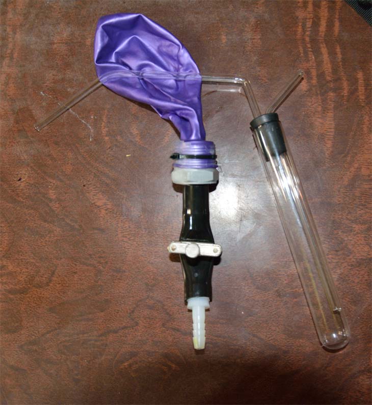

Getting ready
You may have seen that subject line, how the heck do you remove accidental postings?
Anyhow, after seeing NeoPulse's 'proof of concept' video I wanted to recreate that. I don't have access to a tank of Argon, but I can easily get a small can of Ar intended for wine preservation. About 15$ on Amazon/Ebay.
I made this small balloon 'equalizer' to make use of this gas. A small hose clamp to bleed off a small flow of Argon. I wouldn't think it would be much, just what is needed to be certain all oxygen has been removed from the tube, correct?
So I bent a few tubes and I'm waiting for enough time to get it done. Here's the 'apparatus'. Will there be enough gas in this balloon to get through the procedure? I should probably consider another hose to top off the balloon mid way should I run low.
Anyone else familiar with this video? Have any suggestions?
