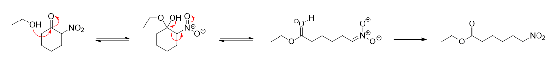

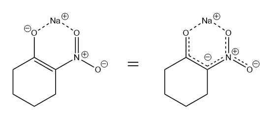

Not only that, but the nitroketone will also act as a bidentate ligand and coordinate with the sodium ions after being deprotonated by the
NaOCH3. This would result in an extremely stable chelate complex and a rather poor nucleophile, as the enolate's negative charge would be
significantly stabilized through both electrostatic forces as well as electron delocalization/resonance:
And while I'm not entirely sure to what extent (if any) this would happen given the strongly basic conditions, cyclic alpha-nitroketones can also
undergo a ring opening on reaction with alcohols and other similar nucleophiles. I'm guessing it works something like this (using ethanol instead of
methanol):
[Edited on 5-10-2016 by Darkstar]
CuReUS
Posts: 928
Registered: 9-9-2014
first of all I thank you atara for replying to my post,your comments are invaluable
It is well known that b-keto esters can be arylated using haloarenes
http://matematicas.udea.edu.co/~carlopez/Organic_Name_Reacti...
Instead of an ester group I used nitro because it is even more electron pulling and I could convert it to amine later easily. If the reaction did
fail however,due to reasons you and darkstar pointed out,one could easily substitute the nitro group for a COOR which would make it a b-keto
ester.Then the arylation would definitely work.
Quote: | Two EWGs would seem to make that carbon atom a very weak nucleophile |
that's one way to look at it.The other way would be to think how acidic the alpha
