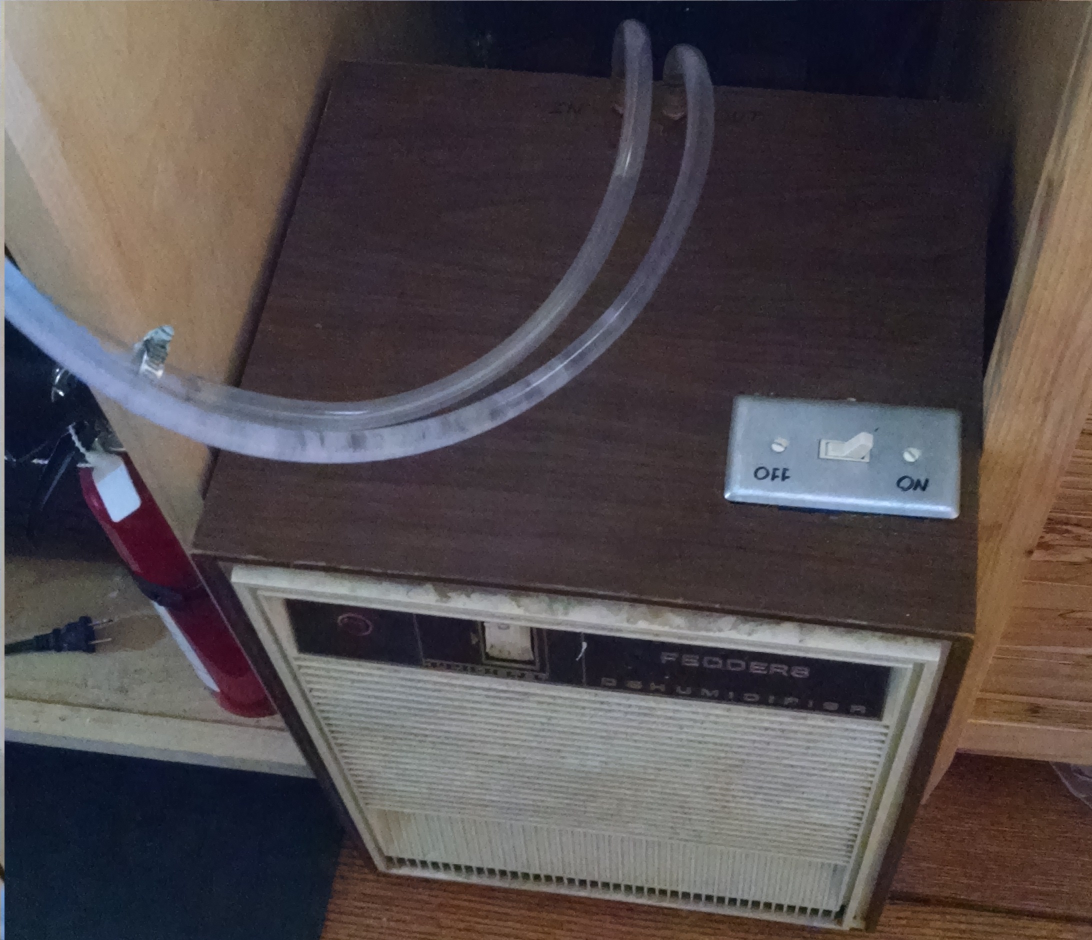

I built a chiller/recirculator for all of my condensers using an old dehumidifier. However, I think any equipment with cooling coils could be used as an alternative (mini fridges, AC units, etc...). This unit will keep tap water at 10*C without any issue. I'm certain it could get much cooler if antifreeze were added. To make it I added a square bucket to act as a coolant reservoir in which the coils are almost completely submersed. I also added a fountain pump, a PID (not yet installed in the below photo), and a switch to complete it. In total I spent about $20 building it.

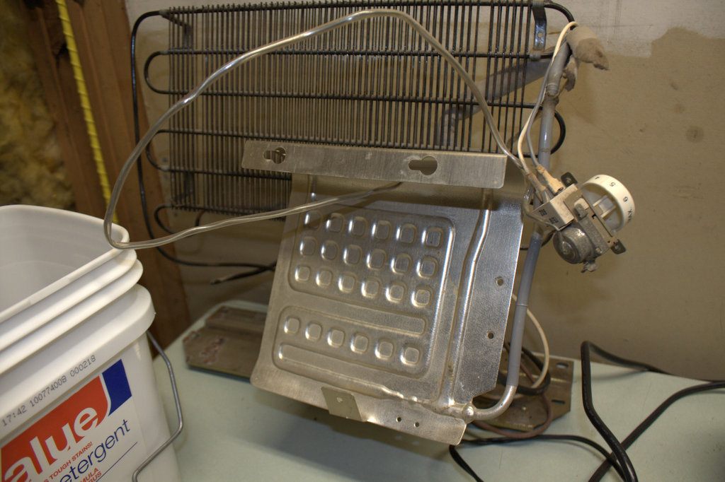

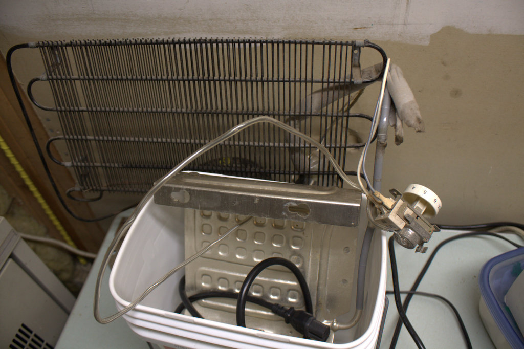

I'm not sure how helpful this is but you rip out the evaporator in a mini fridge being careful not to nick any of the lines or bend them, and then you put the evaporator in a bucket of water and throw in a aquarium pump.
Here is my setup. It works quite well for my needs.
IMG_0872.jpg - 115kB
Here is the evaporator coil. This is the part that gets cold.
IMG_0873.jpg - 163kB
This is the one I have for cooling the bucket there I just fill it with water and place it in. You have to be careful to only bend the thing once and then move the unit as a whole since the lines will break if you stress them too much.
IMG_0874.jpg - 160kB

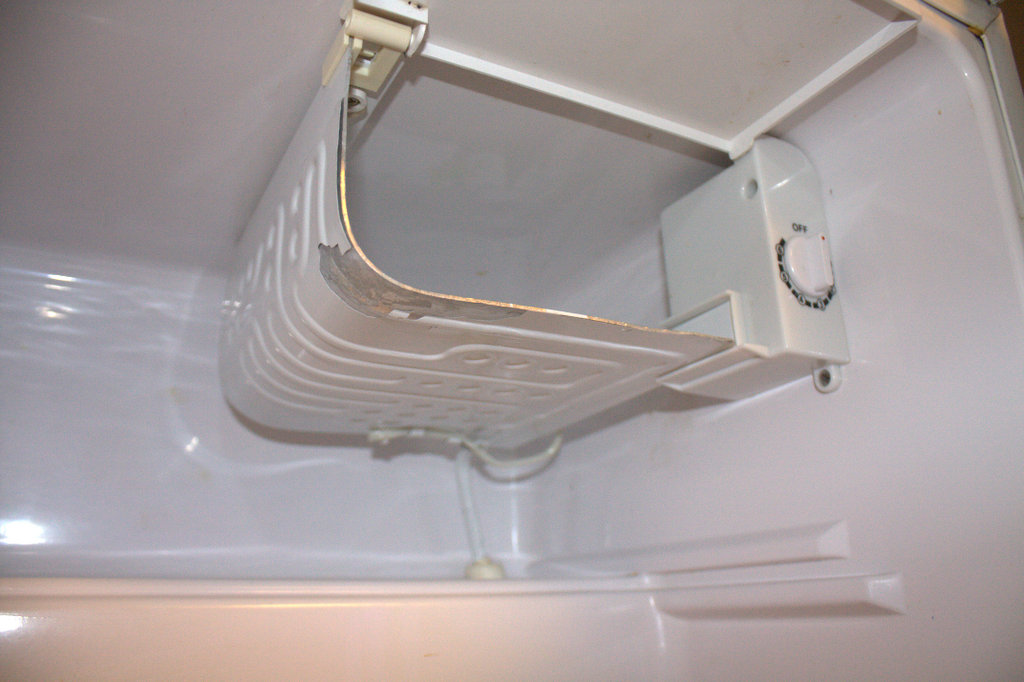

This is the unit in the bath with the aquarium pump at the bottom. It would be filled with water when in use.
