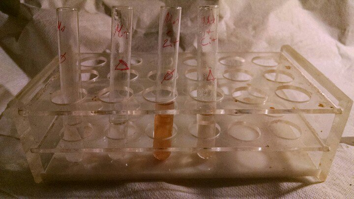

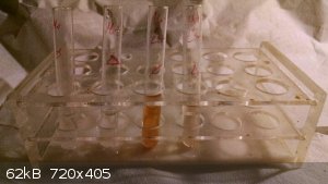

OK, added about 2-3mL of 75% orthophosphoric acid (which will be the primary component of the concentrate) - and in several seconds, the formerly turbid suspension became completely clear. Success :D
Unfortunately, in the end, it was only a qualitative, not quantitative analysis, so I haven't exactly narrowed down the solubility - but the results were sufficiently promising, that I now feel comfortable attempting to concoct the bath concentrate on an 80mL scale; enough for 1L of the phosphating bath. :)

So, I tried this the other day using trisodium citrate and manganese sulfate, adapting the RSC procedure discussed in this thread.
Trisodium citrate, dihydrate: C6H5Na3O7*2H2O, mw = 294.12 g/mol
Manganese sulfate, monohydrate: MnSO4*H2O, mw = 169.01 g/mol
2.95 g sodium citrate were massed (~0.01 mol); also, 1.98 g manganese sulfate (~0.012 mol). I forgot that the product is a 3:2 salt, so I flubbed the stoichiometry; there is an excess of citrate rather than the excess of manganese I meant to have.
Possibly because of this extra citrate, no solid precipitated upon mixing the dissolved reactants, even after heating.
What I did find the next morning was that the clear, colorless solution had turned an orange-pink color. I tried heating it again to incite precipitation... and the color disappeared! I set the beaker aside to cool and when I checked on it a day later, it had reverted to the orange-pink.
Here's a controlled experiment: I made a manganese sulfate solution of about the same concentration, and added it to two test tubes. It was clear and colorless. I added some Mn-Cit solution to two tubes. One tube of each solution was brought to and held at a boil over the course of ~2 minutes.
Results:
manganese_citrate_thermochromism.jpg - 62kB
L-R: Mn, no treatment; Mn, heat; Mn+Cit, no treatment; Mn+Cit, heat.
I'm going to keep adding MnSO4 to the remaining citrate solution to see if I can get the salt to drop out, but this unexpected thermochromism might be more interesting than the solid salt!
