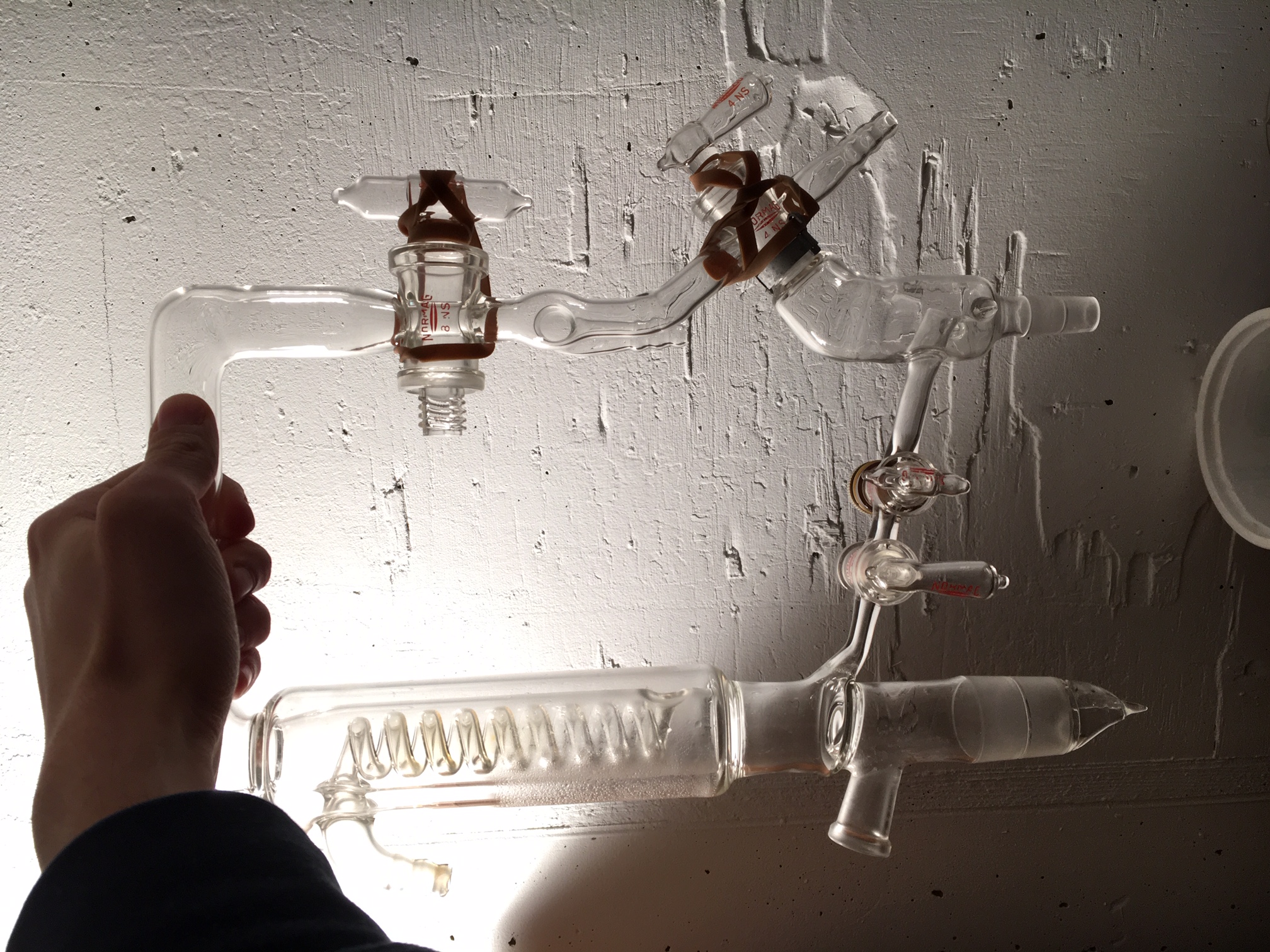

Distillation head!
Christmas came early this year, I found a very nice partial-takeoff distillation head for $100 on ebay! Shipping + customs taxes puts the total just over $150. Probably the best deal I've ever made considering these retail for around $700 new from a glassware supplier. It's in perfect condition, except for a broken stopcock thread and some rotten stopcock nuts, o-ring and washers.
distillation head.JPG - 1.1MB
This particular design is the one of Rehn and Theilig. (Figure from E. Krell's Handbook of laboratory distillation, 2nd ed., p. 392)
Vapors condense on the "intensive" condenser and fall down on the oblique weir just above sideway joint. This diverts the condensate to the horizontal arm with two stopcocks. Stopcock 1 precisely controls the reflux ratio: the distillate that doesn't go through this stopcock falls back over the weir into the column. Stopcock 2 is there to start or interrupt product withdrawal without modifying the reflux ratio.
The receiving flask is connected to the joint on bottom right, possibly through a condenser to cool the product further. Stopcocks 3 and 4 allow changes of receiver during vacuum distillation without disturbing the column. Hose barb A is connected to a vacuum source, and hose barb B to the atmosphere or some other gas.

Posts: 3930
[*] posted on 7-12-2019 at 03:18
Looks like a useful piece of glassware, nice condenser.
To satisfy my curiosity, could you show a close-up of the weir/bottom of the column,
I can't see how the refluxed liquid gets back to the column.

I'm don't have access to my lab right now, but I'll post close-up shots later. The oblique plate is actually perforated in the middle. It's kind of difficult to see here. The liquid fills up the left side of the small tube with two stopcocks and overflows through the large hole in the plate, and drips down into the column. The reflux-adjusting stopcock has an interesting design for very small flowrates, I'll show it as well.

[*] posted on 9-12-2019 at 12:31
As promised, a picture of the weir inside the colmn. As you can see, the condensate flowing on the walls of the condenser is diverted into the side tube. This also explains the choice of condenser design: A regular Dimroth condenser where condensation drips down from the coil in the center (and not the walls) would not work for this as it would miss the weir.
Also a closeup of the reflux ratio stopcock. Small notches on both sides of the stopcock bore (not chipped, it really is designed like that) allow very small flowrates to be let through when the stopcock would normally be in a "totally closed" position. Unfortunately the thread on this one is broken, so I might replace it with a PTFE one which I will modify to also have those notches. A really nice detail, and I think this would work well on an addition funnel for very slow addition rates.
reflux stopcock detail.JPG - 165kB weir detail.JPG - 616kB

Posts: 3930
[*] posted on 9-12-2019 at 16:59
Thanks, I see it now,
and
the tapered notch in the stopcock can also be found on some (older) burette stopcocks.
